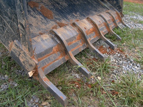

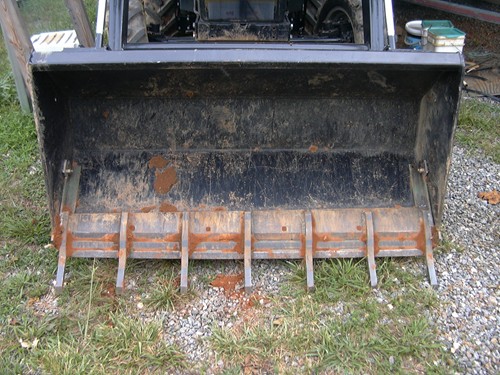

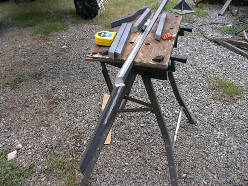

I made a variation on JohnF's toothbar.
http://www.tractorbynet.com/forums/showthread.php?t=76427&highlight=tooth
Instead of cutting and welding the 1" square bar teeth, I bent them. For the cross bars, my neighbor let me have a couple of worn out cutting edges from some type of scraper. The better one was 5-6" wide. the smaller one was about 3" wide on the most worn end. They both had 1 unused beveled edge. I welded the attachment bars and teeth to the larger bar. Then I welded the smaller bar under the teeth to capture the bucket edge and protect it.

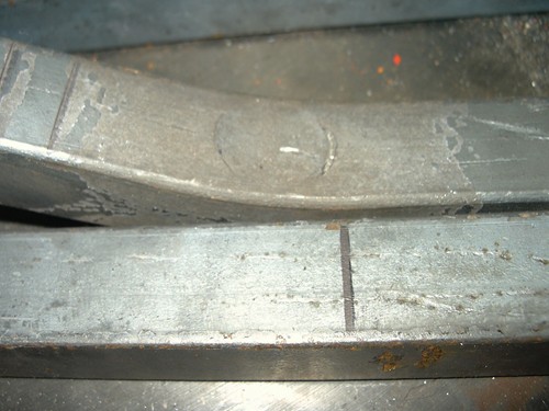

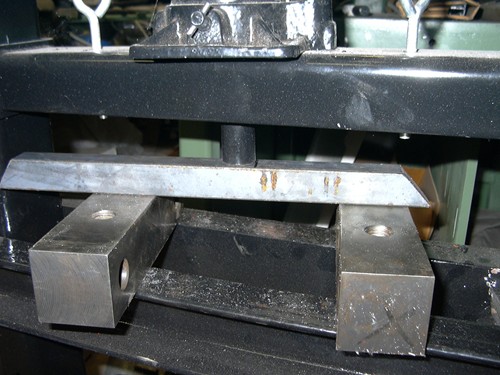

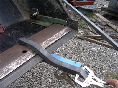

If you look at the picture "tooth in press" you will see an unbent tooth in my 12 ton press. I put a pair of worn out machine vise jaws that are basically 2" square bars under the tooth. The whole thing is at an angle for the tooth to clear the press uprights. I pressed directly on the tooth with the press stud which is a 1" diameter round bar. When making duplicate teeth, I marked the press position to place the new tooth, then put the original tooth next to the new one as I completed the bend to achieve the same angle. I kept the support spacing fairly wide to avoid overloading the press. It felt like I was pretty much at the limit of the 12 ton press.

In terms of a pattern I think it really depends on what you use for a cutting edge/bar. I took a smaller, easy to bend piece of steel and bent it to fit the cutting edges I had clamped to the bucket. Then I bent the first tooth and tweaked it to fit. After that it easy to copy the "master tooth" the way I was using the press. When I welded it all up, I welded the two end teeth first, then clamped a piece of angle iron spanning across the tips. The angle iron then made a great guide for getting them all in a straight line.
My press is the $49.99 12 ton model from Homier. It worked pretty good until half way through when a check valve failed on the jack. I slipped in a 20 ton jack to finish the project and was suprised I still had to pump pretty hard. I was careful not to reduce the 3-point bending span to avoid overloading the press frame with the bigger jack.

I bent the far left tooth pushing on a stump I was digging up. In working with the bucket, the teeth did seem plenty strong to withstand the hydraulic curl and lift forces, even with only one tooth. Pushing with an end tooth turned out to be another story. The tooth bent down, with the lower edge helping to resist the bend until the weld broke at the second tooth. The crack propagated from the weld into the edge allowing it to crack nearly in half.
If you look at the fillet weld on the second tooth in the first picture, you can see how it popped right off the surface. I should have known better when I welded that small bead because I had that happen with some tack welds while a big wide test weld I had made fared quite well when I beat it with a sledge to failure.

I bent the tooth back by slipping a tube over the tooth and pushing down with the bucket. First I tried a piece of 1-1/4" sch 40 pipe but that bent before the tooth (gives an idea of the strength of the 1" stock). I then put together a piece of 2-1/2" square tube and 3/4x2" flat bar and that was able to withstand the bending force. When it bent back into position all of the breaks closed up.
Then I ground out the crack and broken welds plus all of the wimpy welds I had made in the lower cutting edge and re-welded. I cleaned it up, gave it a snazzy 3-color paint job (what happens when I don't have enough of any 1 color) and reinstalled it. I did some more digging tonight - so far so good!
