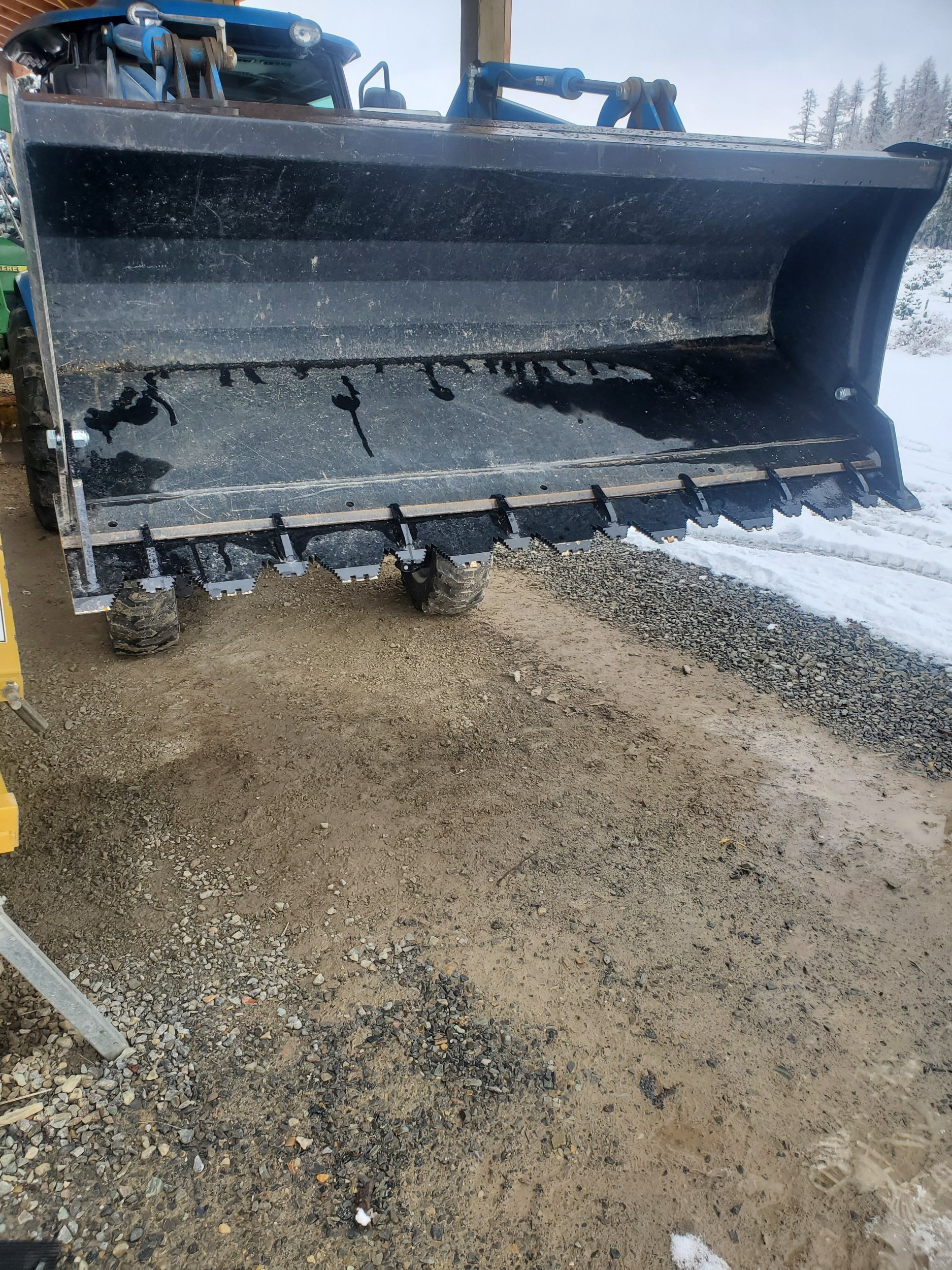

Got the tooth bar on the 23rd, installed it Thanksgiving morning, I will get pics posted.
The thing is a 70 lb. Beast of serrated metal teeth. When installing it, found out I was already starting to bend the buckets cutting edge.... But that's cured now!!!

Here is a picture of the wicked tooth bar....finally.
Installation was straight forward and very easy.
I did find out the buckets cutting already had a slight bend in it already. Positive I did it cause I checked it when new and it was bow free...

Mr. Spruce Deere...for what it's worth...
I added the EA provided bolts along the cutting edge to tie the original bucket cutting edge to the tooth bar.
My thinking was the extra 30 minutes to do it should logically make the two locked together stronger - acting more like ~3/4 of an inch of steel - rather than (2) 3/8 inches of steel just laying on top of each other.
You'll find the EA tooth bar is a GREAT addition to the bucket...making it much more effective with less effort required to bust into dirt.

I did give that some thought. ETA provided the bolts to do so. But with the slight bow in the bucket cutting edge, the two fit quite tight together.
I was happy with how it snug it is, knocked holes in the side walls of the bucket in the right location so the side bolts fit on the end of the slotted bolt hole to hold the tooth bar snug, air gunned the 3/4 inch lock nuts down and called it Thanksgiving morning:)
