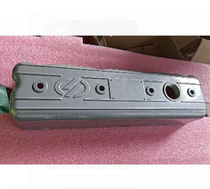

AliBaba has this, which is close but not right:
Alibaba is not the same as AliExpress. You can negotiate a bit on the offer. It is possible they have, or could get different valve covers.

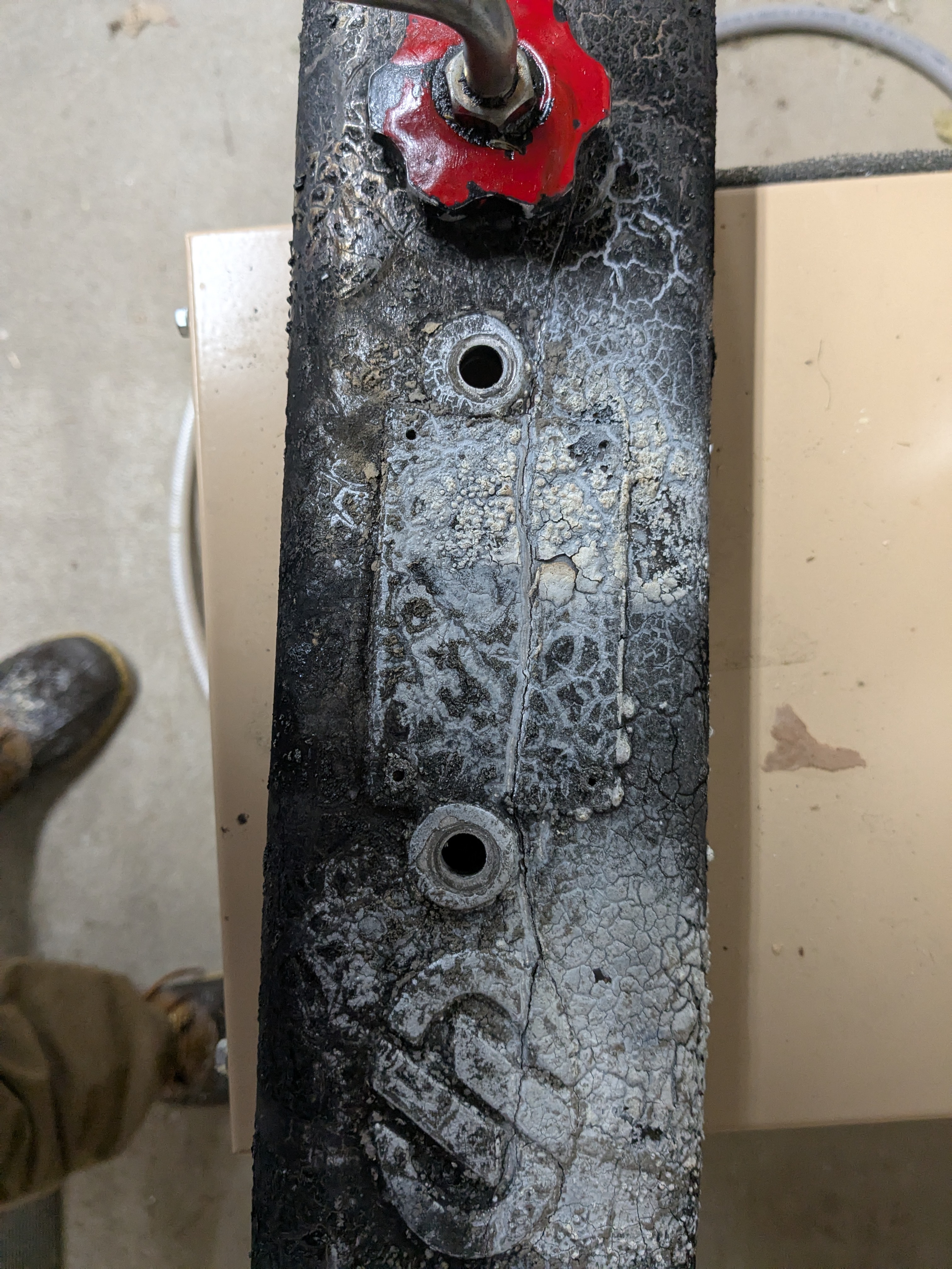

I might try this. The thing is, it's not leaking through the crack. It's flexing at the crack and leaking around the gasket. So a repair would have to be quite strong and stiff.
Also, 250F doesn't sound very hot for an engine repair.

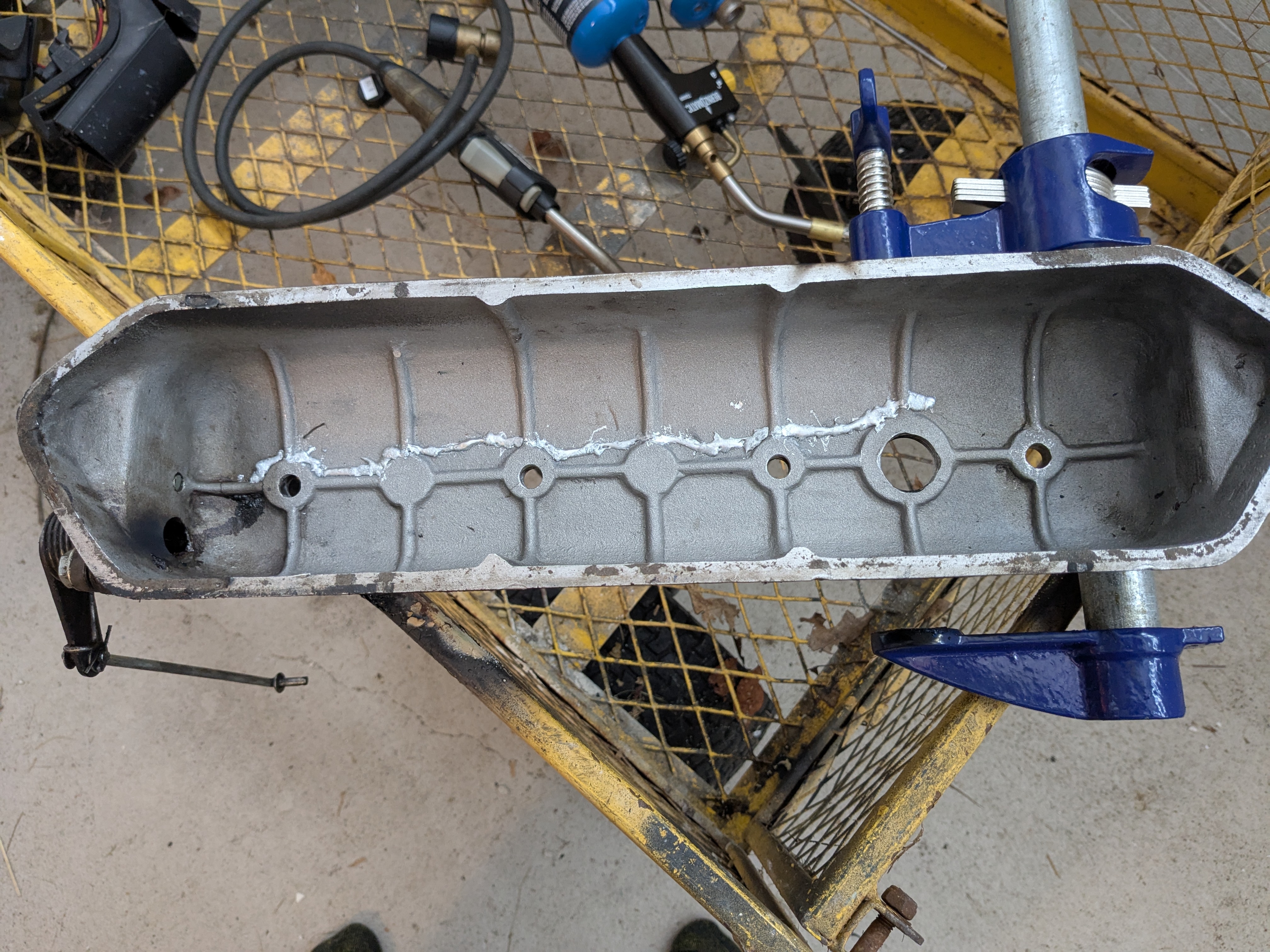

I had some time today so I soldered it with a Durafix rod. I washed it with degreaser and then used a Dremel tool with a conical tip to follow the crack and widen it a little. It took a while but heating it from the other side I was able to get the solder to flow and laid down a pretty good bead:
The cover had taken on a bow, so I held it with the bar clamp to straighten it out while I soldered. After it had cooled I removed the clamp and it stayed straight so the solder is doing something. I put the cover on and tightened it what I'd consider medium-tight, it bowed a little, don't know if it's going to leak. I have to buy more oil.
Heating the other side did quite a number on the paint job. Now it has kind of a steampunk look.
If this doesn't work I think next up is to try cross rods.

I'm sorry to say but the solder didn't wet the metal very well, at least outside of the crack. Also, it looks like the crack appeared on the outside of the cover.
Eric

Then it should be soldered too. Grind or wire brush the crack area about 3/8" on either side of the crack. Then solder. The solder should tend to flatten out at the edges. If it does then you know it is wetting the aluminum well.

An update: I had time yesterday to top up the oil and run the engine for about 15 minutes. I seemed to have stopped the leaking, at least for the time being. I realize my repair could fail at any time so I will keep my eyes open for a replacement cover.
