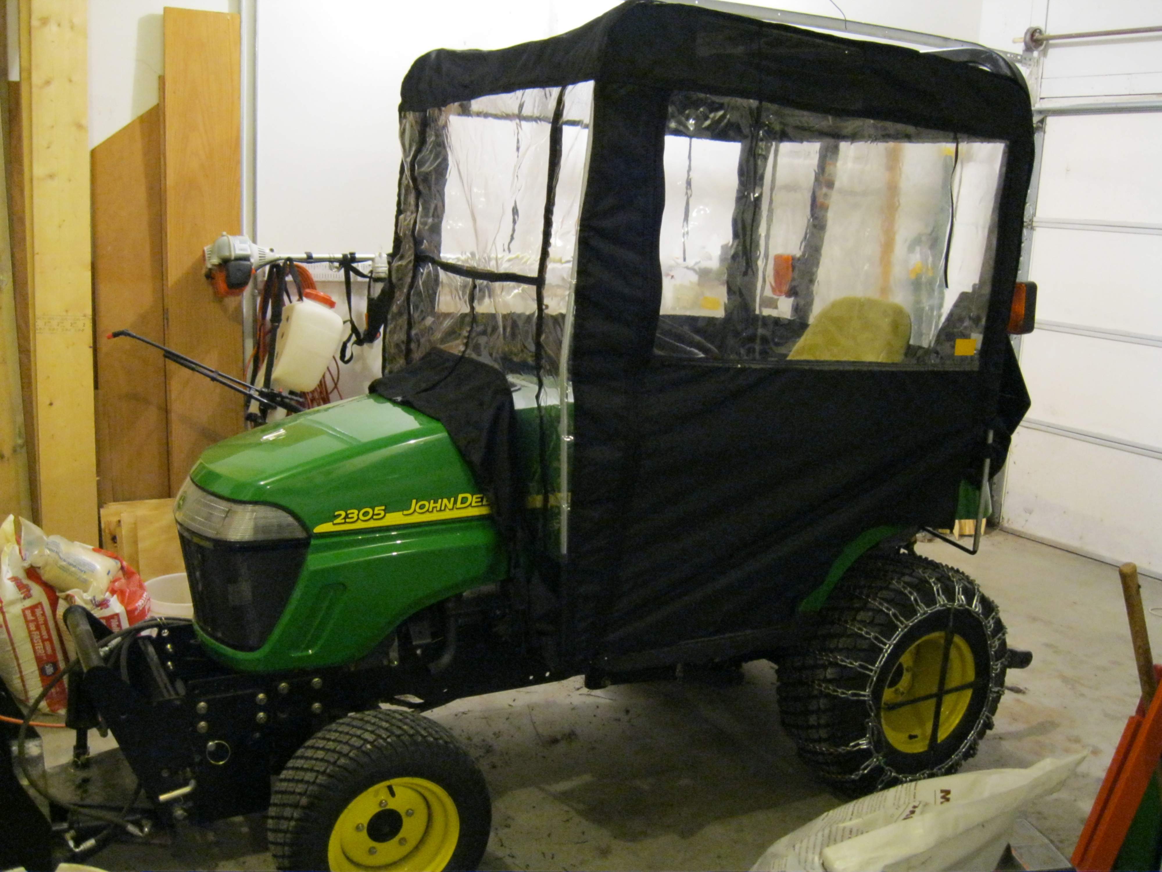

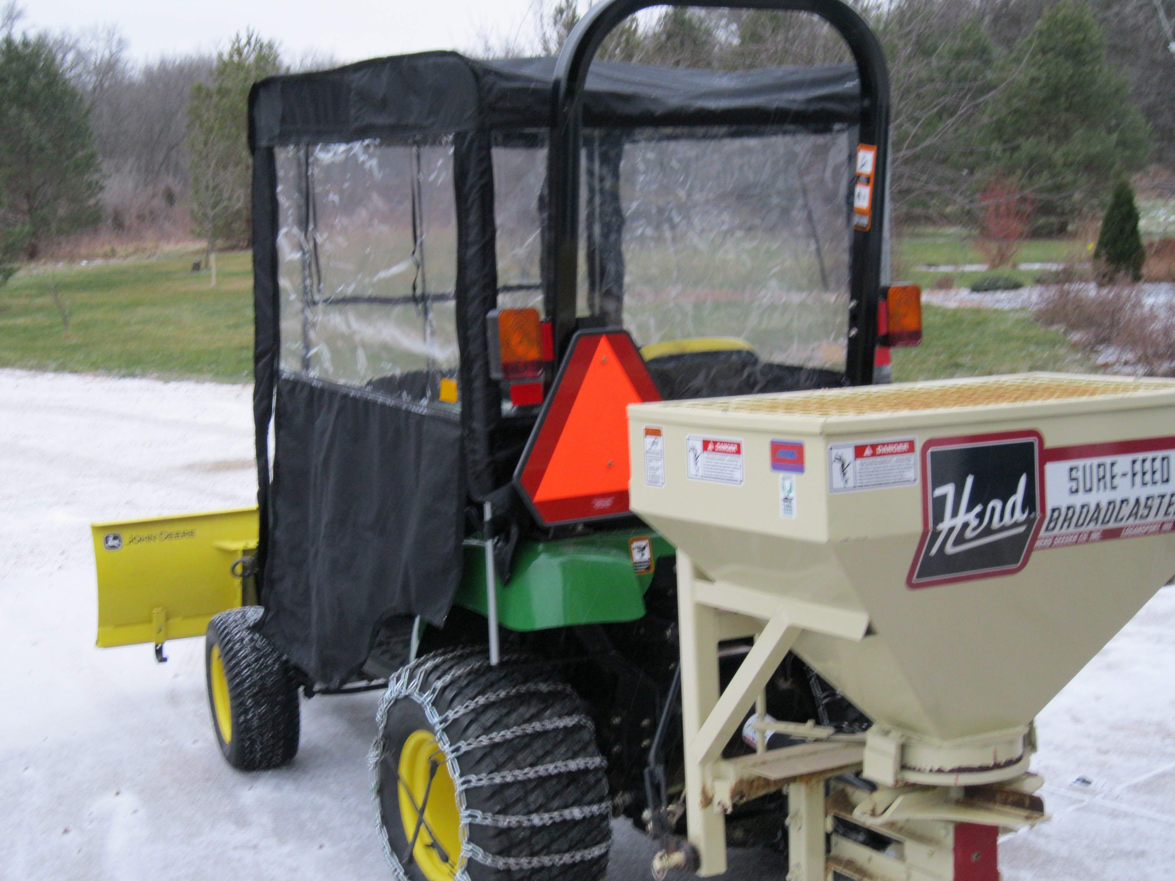

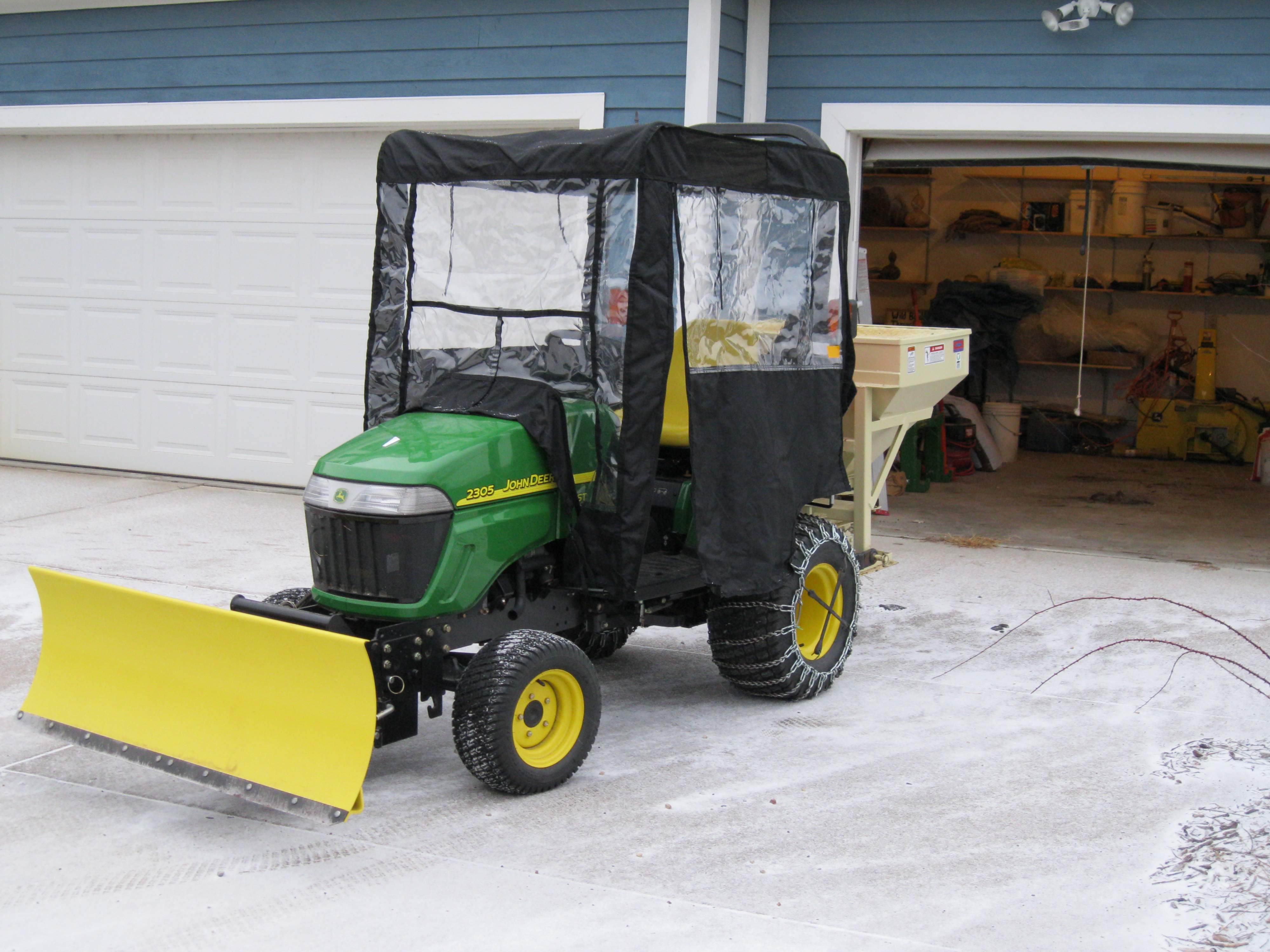

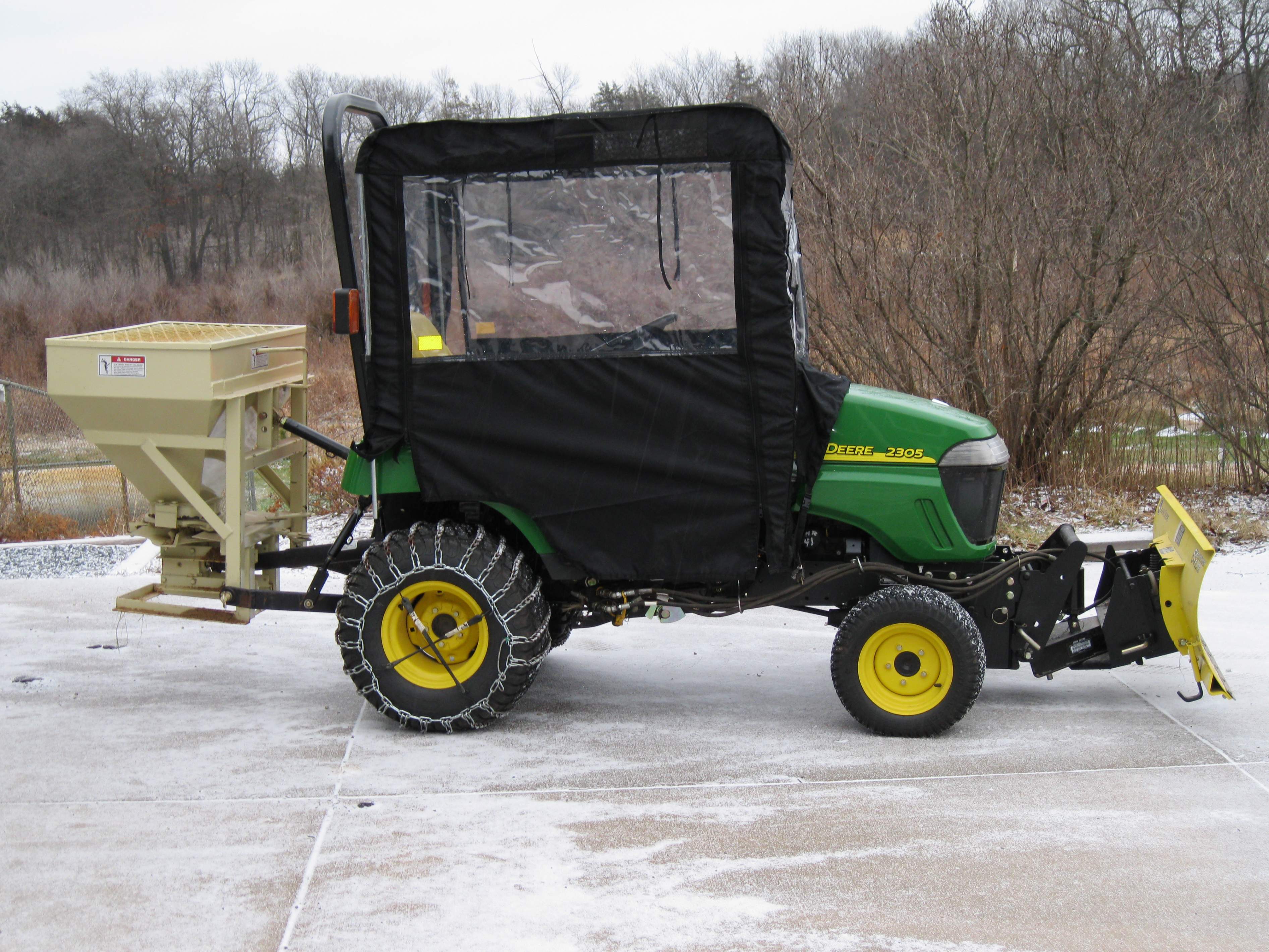

I posted a few weeks ago wondering if anyone had suggestions on installing a Berco soft cab on a 2305, primarily because the directions assume metal footrests and a slightly smaller frame than the 2305. The Berco unit is a "universal" type so was fairly adaptable and I am including some photos of the installation.

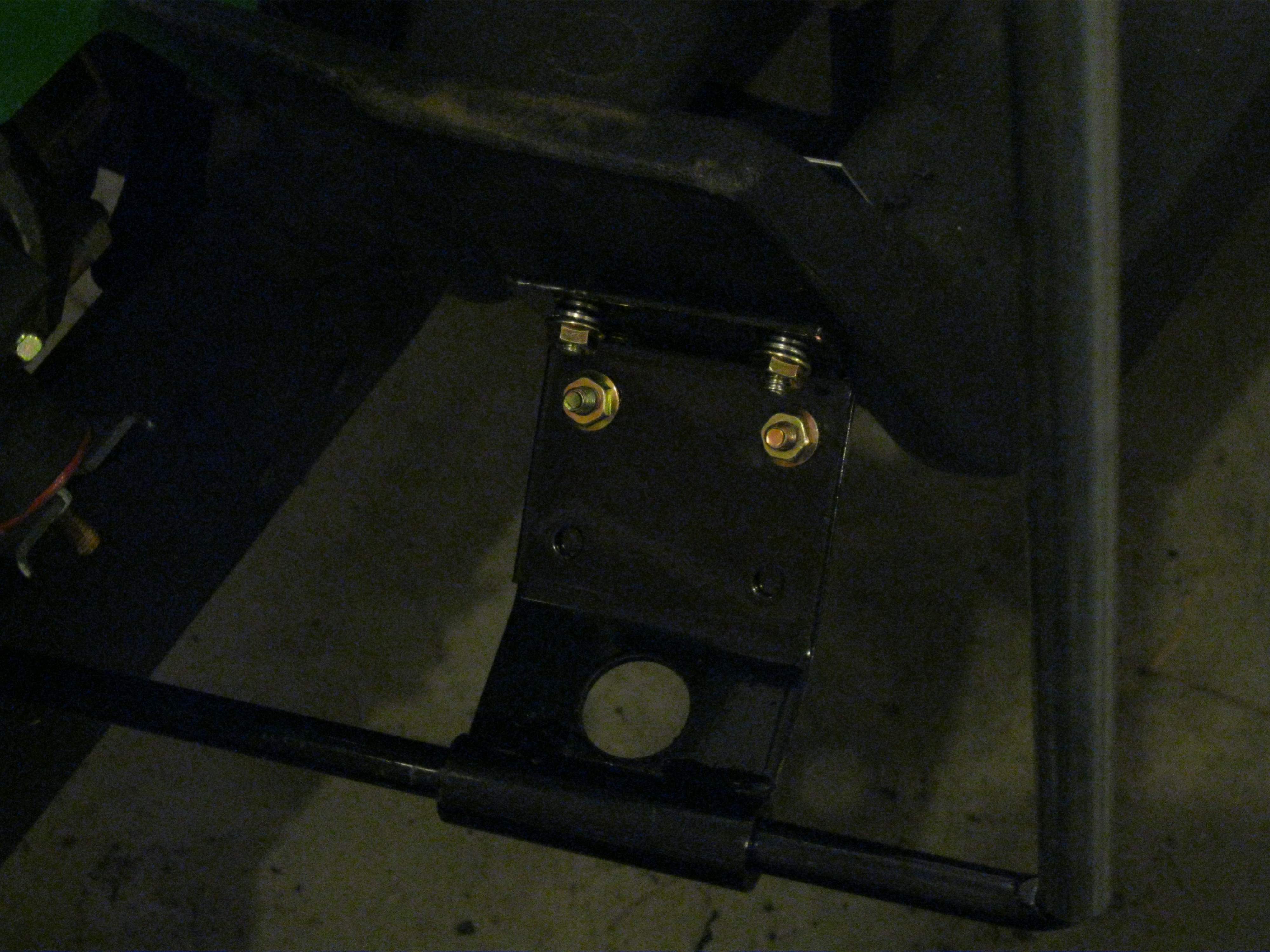

I swung the rear support posts (which attach to the rear hitch plate) to the side, which meant the rear vertical supports would be in front of the ROPS - this was necessary because the tractor has about an inch of clearance above the ROPS when entering the garage, and this way I could control the height of the cab to be below the ROPS. I have a couple of inches clearance above the rear tires.

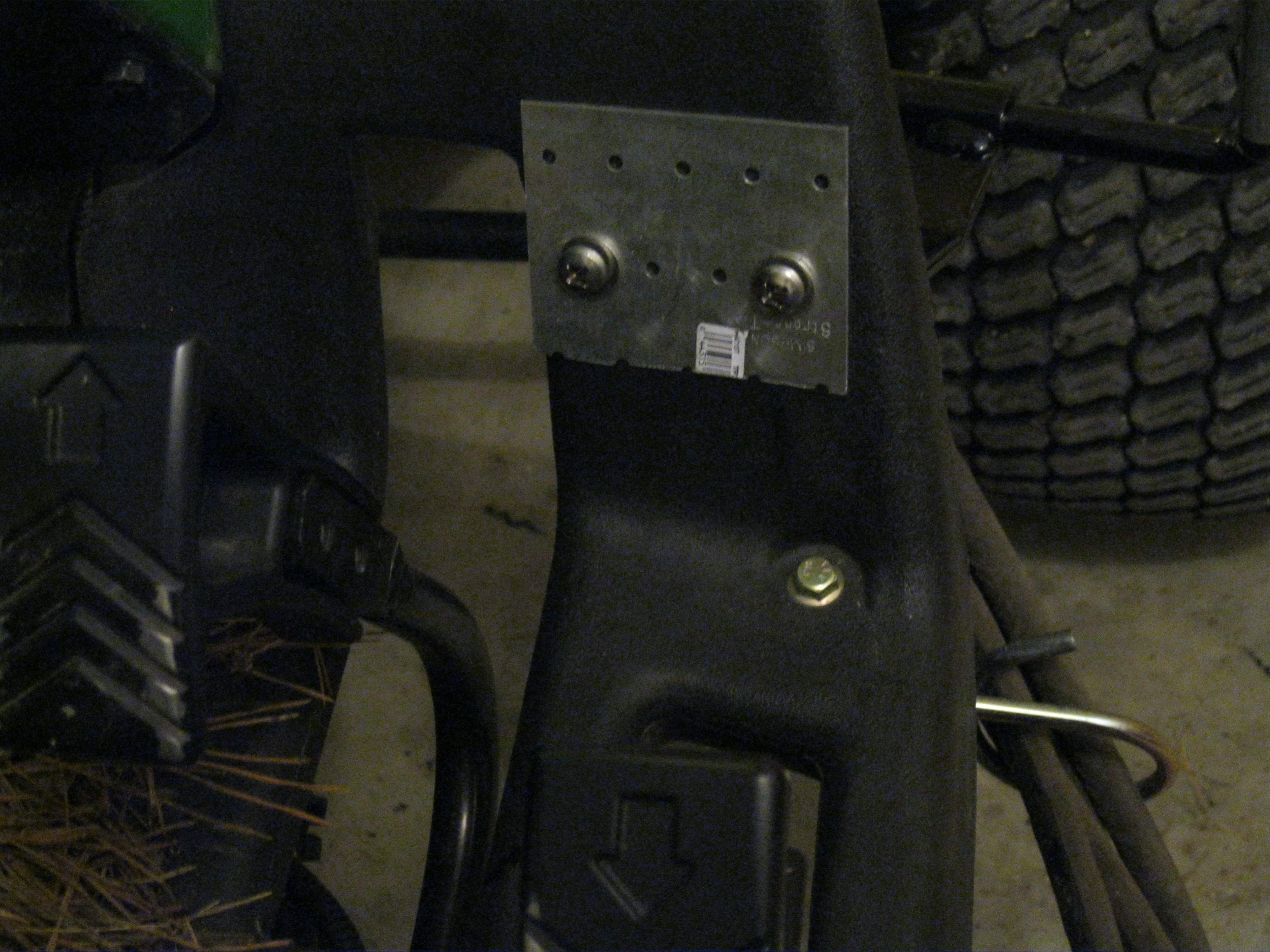

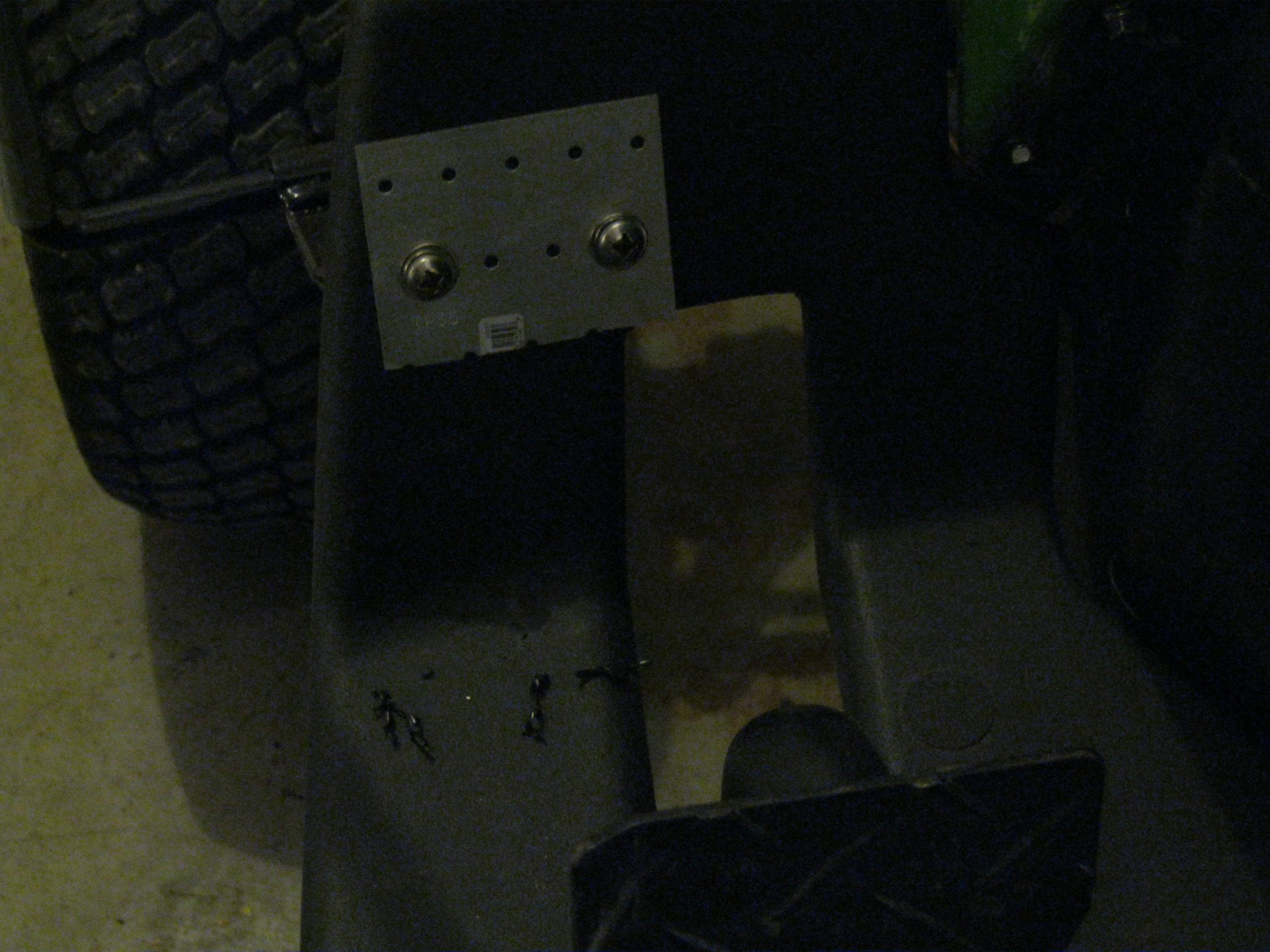

I also used a couple of thin perforated nail plates to anchor bolts on the top side of the foot rests and bolted the front supports on the lower side.
The installation went fairly smoothly and I made the first run at sanding a steep driveway hill yesterday in relative comfort with a 20 mph wind blowing and a wind chill in the single digits.:)

Looks good. I want to buy my father-in-law a soft cab for his Deere and I'm looking at the Bercomac options. What size berco cab did you install? The 34" or 40" wide option. Are you still happy with it?
/ Berco cab installation on 2305
I have the 40 inch model which fits the 2305 pretty well. I've been out sanding and plowing snow for about an hour several times and vision is good all around and it has been very comfortable, especially if the sun is out.
Once I learned to unzip the flap before trying to pop out, it's been an excellent addition.:)
I went with the soft cab because I had only an inch or so clearance between the ROPS and the garage door and most other hard cabs or hard/soft combos extend above the ROPS...plus the price was right. :thumbsup:

"I went with the soft cab because I had only an inch or so clearance between the ROPS and the garage door and most other hard cabs or hard/soft combos extend above the ROPS"
The Curtis cab is basicly the same hieght as my 2210/2305 ROPS
blizzND
Bliz, that half inch above the ROPS is about all the wiggle room I had with my garage door. My door is manual and wants to creep back down an inch or so unless I give it a firm final lift. When I talked to the JD dealer about looking into a hard cab, he contacted Curtis. They gave the distance above the floorboard needed to clear the top of the cab, and that distance was almost exactly the door opening height I had. (see the Dumbest Thing You Have Done with your Tractor thread and all the ROPS involved with garage door redecorating). I didn't want to spend the big bucks and find out I couldn't conveniently move into and out of the garage. I also will be removing the cab in warm weather since I encounter low-hanging branches while out on the property mowing, woodcutting, hauling, etc.
I appreciate your pictures and tape measurement - that gives the true story about clearance between the ROPS and the Curtis cab top and is the kind of very helpful info available within this forum.
