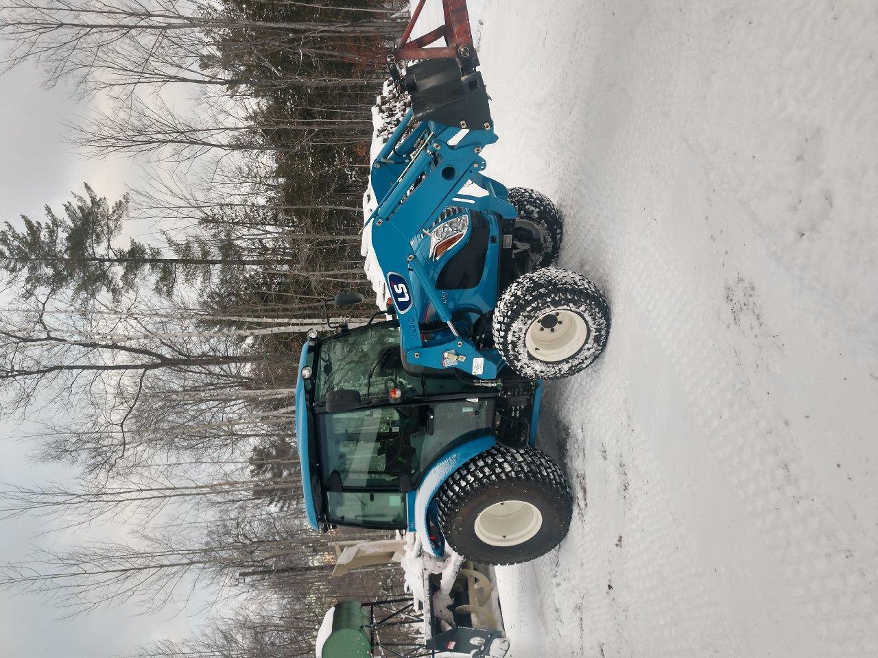

IMHO you made the right decision. But you must be getting a lot less snow than when I lived in Ontario. BTW, even with a blower, if I get a light snow fall, 4" or less, I use a blade to clear it plus a blade is great for back dragging. I mount mine on a SSQA plate that allows mounting of 3PH attachments, and I have blower on the back for the snow events.

I really like those SSQA plates, both weld on and 3pt like you are showing. May have to spring for one. They are surprisingly close in CAD to what you posted, which is not a gimme for most things...

For $200 the SSQA plate for 3PH was a bargain. Nice to be able to drive forward and know exactly where the blade is. I also use it with my landscape rake.
You cannot use it like a dozer as the loader is not designed to take large push loads, but for most snow events it will be fine. I get 120-140” of snow a year so a blower is nice to have to avoid 8’ banks of snow. BTW with the front mounted blade you can easily pile snow into banks using the loader without undue pushing. If I got less than 60” of snow, I would never get a blower.
