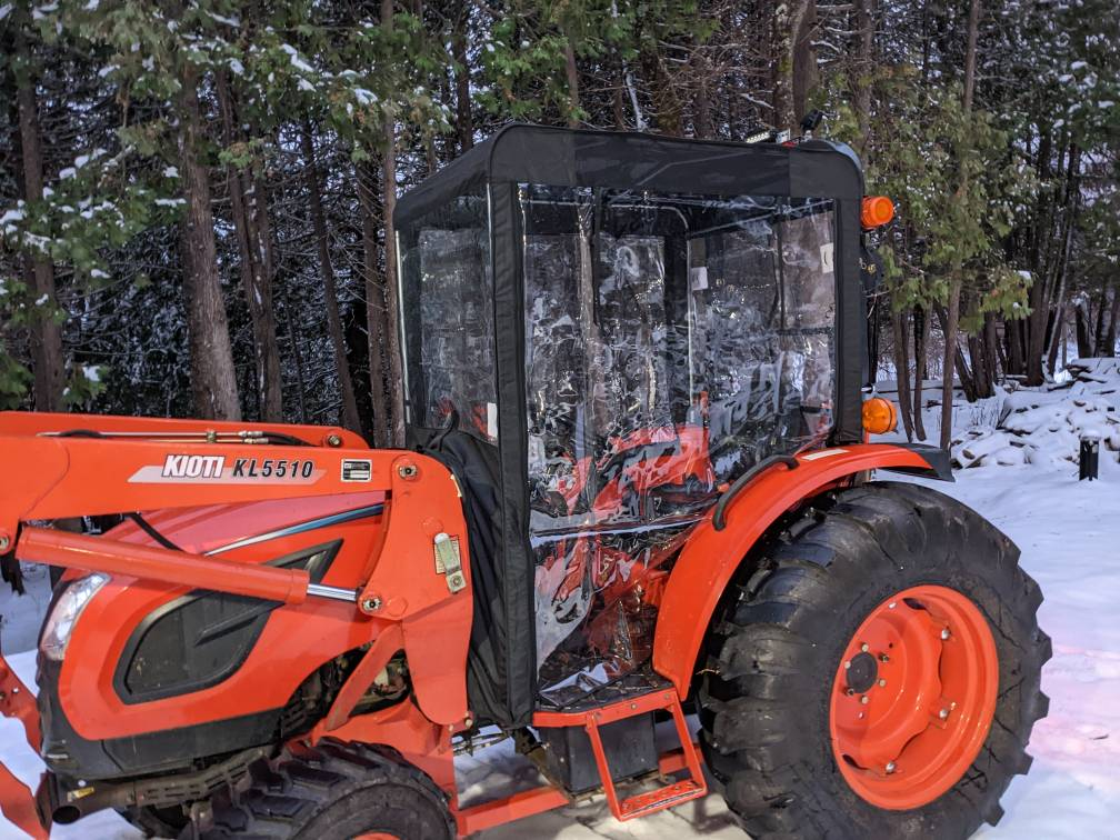

After 4 winters of blowing snow without a cab I decided to purchase a winter soft cab for my Kioti DK5010 open station. The units manufactured in the US are wildly expensive to purchase and ship to Canada (US$1 = CDN$1.40 these days) so I went with a universal fit model from Bercomac. I was not sure how the mounting brackets would work out but it turned out to be a very good fit. I did not even have to drill a hole.
It is 40" across, 49" front to back, 64" tall with a 26" rise around the fenders. it comes with a stiff plastic piece that zip ties to the frame before snugging the cab onto the frame. I installed it today since we were receiving our first snow storm and my test run was in the afternoon freezing rain/ice pellets - I am going to enjoy the cab!

I have no plans to add heat. The tractor stays in a tarp garage so there is no temperature differential and no melting snow inside the cab so hopefully it will not fog up. The unit comes with vents along the top edge.
We'll see (or not) what happens.

It is very clear with no distortion; of course it is new.
Sturdy and durable - yes, the zippers are large and move easily. Seems better than my popup trailer material...and rated for -30°C / -22°F.
The door panel is stiffer in the cold but it just pushes out of the way. The sides are the same width as my fender grab handles and they curve nicely and hung the fender. Some blowing snow may sneak in along the edge - but nothing compared to wide open
The roof is well below the top of my ROPS. Measure from the underside of your canopy to the floor and let me know. Of course it would be simple to cut an inch or two off the vertical pipes of the soft cab to lower everything.
My DK is a beast. Works well!

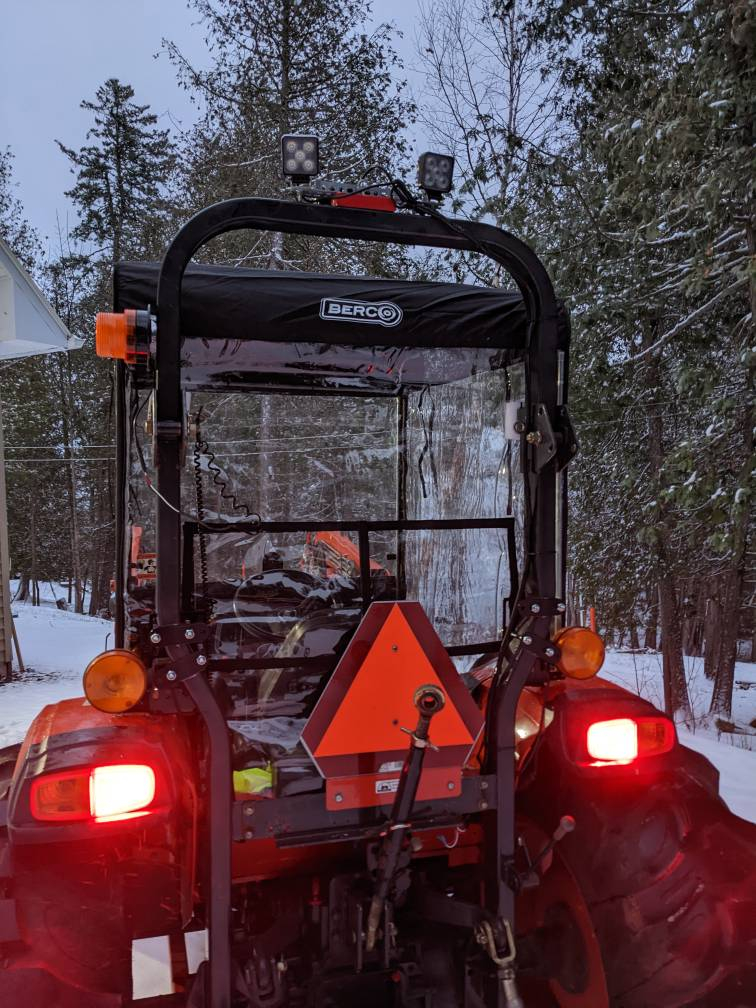

UPDATE. Winter was slow to arrive in our area, I guess, because I bought a winter cab! how well is it working?
I noticed that I had to relearn where the perimeter of my tractor is. I was used to seeing everything open station. After a couple of uses all is well again.
No need to add a heat source. Being sheltered from the snow and especially the cold wind is plenty good enough - actually very nice. No need to have my tuque pulled down and my coat hood up and obstructing my view. I can blow snow in any direction I want, although directly into the wind creates a whiteout, cab or no cab. In case not mentioned, I have a rear blower.
One day we were getting freezing rain and ice pellets and I could step inside my cab -nice. One day was very mild and snow stuck to the 'window' so I had to sweep it off. I guess full cab owners without a wiper blade may have to do the same.
The corner zippers are big and work very well. Due to the width of my tractor the side (door) panels drape over my fender handles so they are not easily accessible. That said, I would not want them to be outside the fenders where they would rub on the wheels. Finally, my forward facing LED light bar (magnet bracket) on top of ROPS is no longer effective. The roof creates a shadow. I am not sure where and how to mount it. Hope this helps

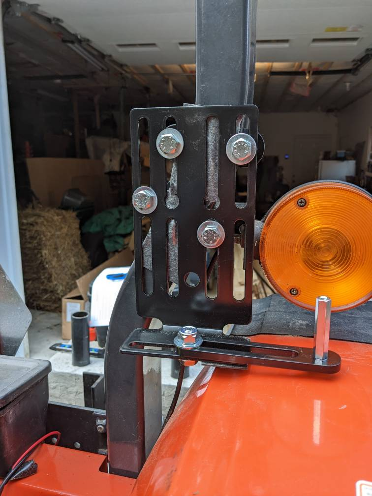

My LED light s magnetic mounted at the front edge of the metal roof on my Sims, Cab Depot cab. If your roof is plastic or fiberglass, mount a steel plate on the roof for your magnets to adhere to. Jon
