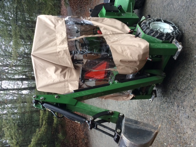

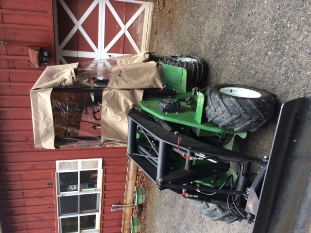

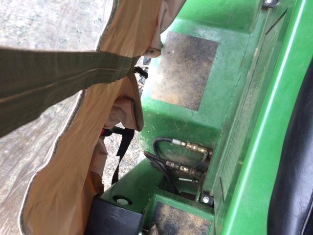

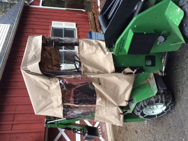

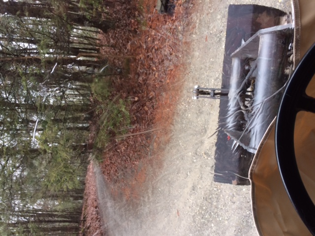

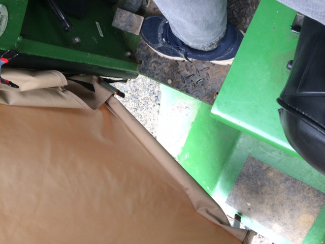

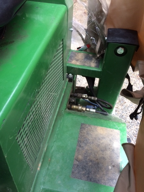

thanks to barry's inspiration I added a soft cab to my pt.......wish I had done this years ago......since I have a tall boy my size parameters were a little different as well as the engine would be sitting inside the cab so I needed the flexibility to adjust the sides to make sure I would get enough air flow for the engine cooling........after looking at what was out there I settled on the golf cart cover from classic accessories.....got it from walmart online for $75.......add in some spring clips and total is about $85.......all the golf cart covers are much bigger in size then what is needed for a pt.......they go by roof size and my roof is about half as wide and the length much shorter too.....so it was important to get one where the side panels could be adjusted in height and this one has zippers at all the corners as well as on the door panels.......rolling them up and cinching the corners allowed me to fit it to the pt.......it does get very warm inside with the heat from the engine but by zipping the door panels up or down I am able to control the heat much like a damper does.......vinyl window is not window glass clear but plenty clear enough for plowing.......rear view is a bit restricted and I will deal with that next winter........granted the look is NOT going to change anybodies mind about the design aesthetics of the pt.....lol.......but over all I am pleased..........Jack

just got power back on tonight.......been out since friday noon time.......we got hammered by the blizzard on friday.......60 mph wind snapped utility poles like toothpicks.......trees down all over the place.....two towns over from me got 23" of snow according to national weather service.......don't really know what we got as wind blew it all over the place......let's just say lots......by sat morning 120000 people in our county without power....there's only 160000 people that live in the county to start with.......cab worked great.....kept me warm and dry....in fact I had to start taking clothes off it got so warm inside.....no problem with view through vinyl windows......yeah not windshield crisp but more then adequate for plowing........another storm set to dump another 14-16" on us wed.......I really hate when that **** groundhog is right......lol........Jack
