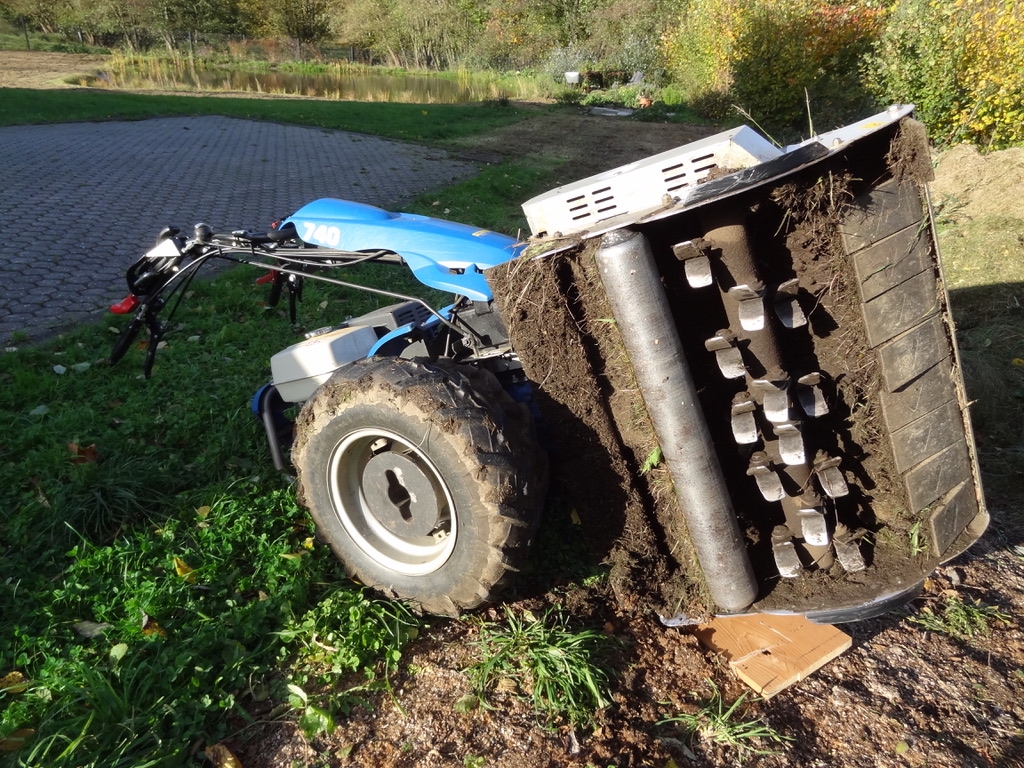

A few times during the mowing season, I like to give my Berta a good wash down with the garden hose. I do the same at the end of the season, before stowing the mower for the winter. I hope, that keeping the mower clean, well greased and stored in a dry garage, will keep it running well for many years to come. At the same time, it is a good opportunity to check the blades, the bolts and nuts, and the general condition of the implement.
Usually I have disconnected the flail mower from the tractor and raised it to vertical, letting the mower rest on the left-hand side panel. This way the right-hand side panel with the two belts will be at the very top, where they are best protected from the water spray and dirt. This is how the mower typically looks after the wash, with quite a lot of dirt now lying on the ground:
Once as I did this washing, I recalled a video from Earth Tools, where Joel is turning the mower on its side, while it is still connected to the tractor. This might be convenient in some situations, but Joel says that you can’t do that on all the flail mower sizes:
That is correct, as you will run out of ground clearance under the engine before the mower reaches vertical with the wider models, if the tractor is on the standard 5x10x20’’ wheels. I have the 6.5x12x23’’ wheels on mine, so I decided to give it a try with my 34’’ Berta - and it works:
It is a tight fit though, as the engine is sitting firm on the ground in this picture. It only works well this way, as the right-hand side cover is more than an inch wider than the left-hand side one!

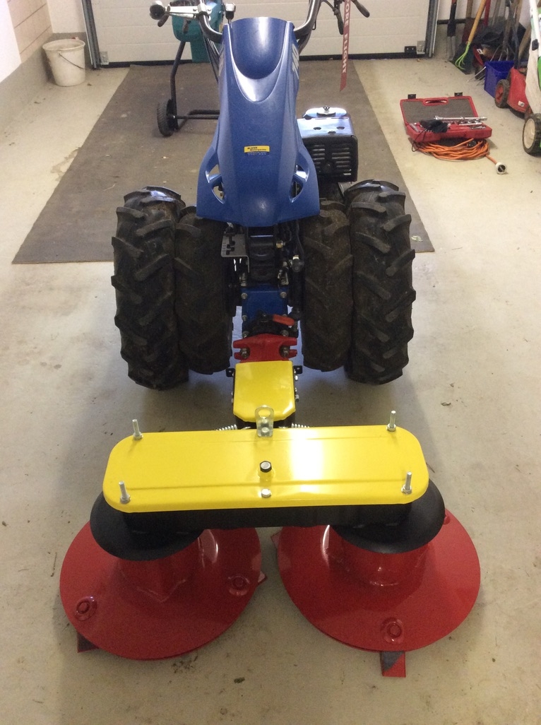

As I got the 6.5x12x23’’ wheels, I wanted to add them to the original 5x10x20’’ wheels that I had already, and at the same time try to keep the track width as narrow as possible to stay within the working width of most of my implements. After a bit of trial and error, and with the help of a few washers, I got down to an outer width of 47 cm (18 ½’’) for the smaller inner wheels. The wheels are so close to the tractor, that on the right-hand side the tire is just clear of the gear quadrant. Then I used 1 of the factory 6 cm (2 ⅓’’) axle extensions, and again a few spacers, to mount the 23’’ wheels as close to the 20’’ ones as possible. The tires are really squeezed together, giving an outer track width of 78.5 cm (31’’).
This is how my setup looks with the Zanon ZRF 100 cm (40’’) drum mower attached:

That's really amazing Jens that you were able to get everything as narrow as 31". With my dual set the width I have is 34". And I'm using 2 sets of 5x10x20 tires. I intentionally left 1" space between the tires so that I could mount chains on both sets if I wanted to. I did the whole dual setup because I wanted to pull my disk harrow in the muddy spring and fall when I would sometimes get stuck in the mud. That's the time of year that I need to disk down the garden.
But in retrospect I wish I had tried to keep things a little narrower. I do a little bit of mowing on a very steep slope around a pond. I use a 30" sickle bar mower and it would be nice to have a little wider width and traction of the duals for stability. I can only guess that you mounted your hubs (The smaller wheel part that bolts to the tractor axle) on one of the inside surfaces where they bolt up on the smaller wheels. I didn't understand that you could do that at the time I made my setup.
Using the outer mounting surfaces to mount on the hub, my options for the width of the single wheels was either 22" or 24 1/2". I'll have to take a look at that. But I'm quite amazed that you were able to queeze it down to 18 1/2".

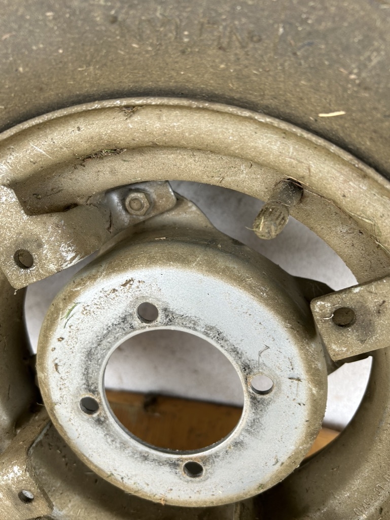

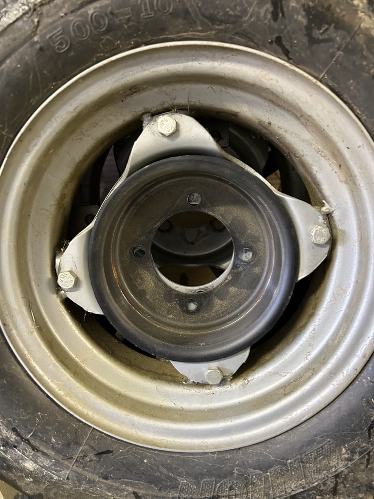

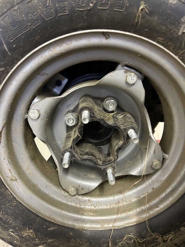

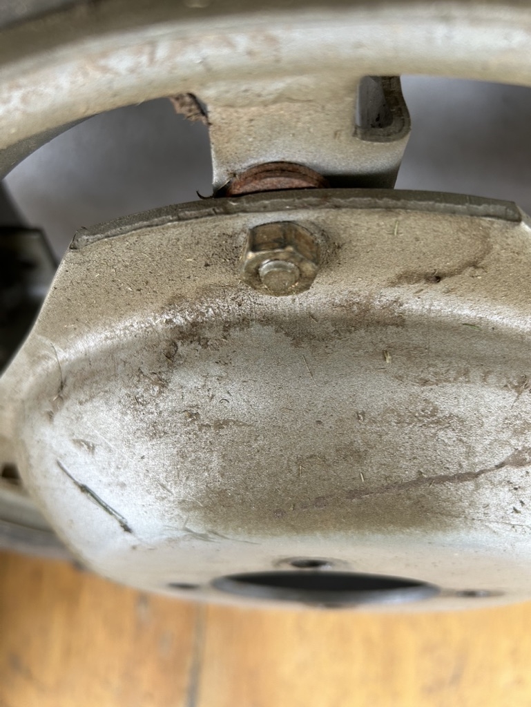

As I removed the wheels on my tractor recently, I took a few photos to help explain how I made my dual wheel setup.
You are absolutely right that there are 4 different ways to mount the wheels - at least that is the case for the 5x10x20’’ and 6.5x12x23’’ that we have. There are 2 sets of brackets/tabs on the outer rim, and the inner hub can be flipped and positioned in 2 different ways on either set of brackets. This is my setup, where the 23’’ wheel to the right will be flipped and fastened to the wheel extension on the 20’’ wheel:
Just for the record - one can fit the hub over the brake drum as shown below. Whether that will be advantageous or not, I don’t know. I have had no problem getting the inner wheels very close to the tractor, with the hubs facing outwards:

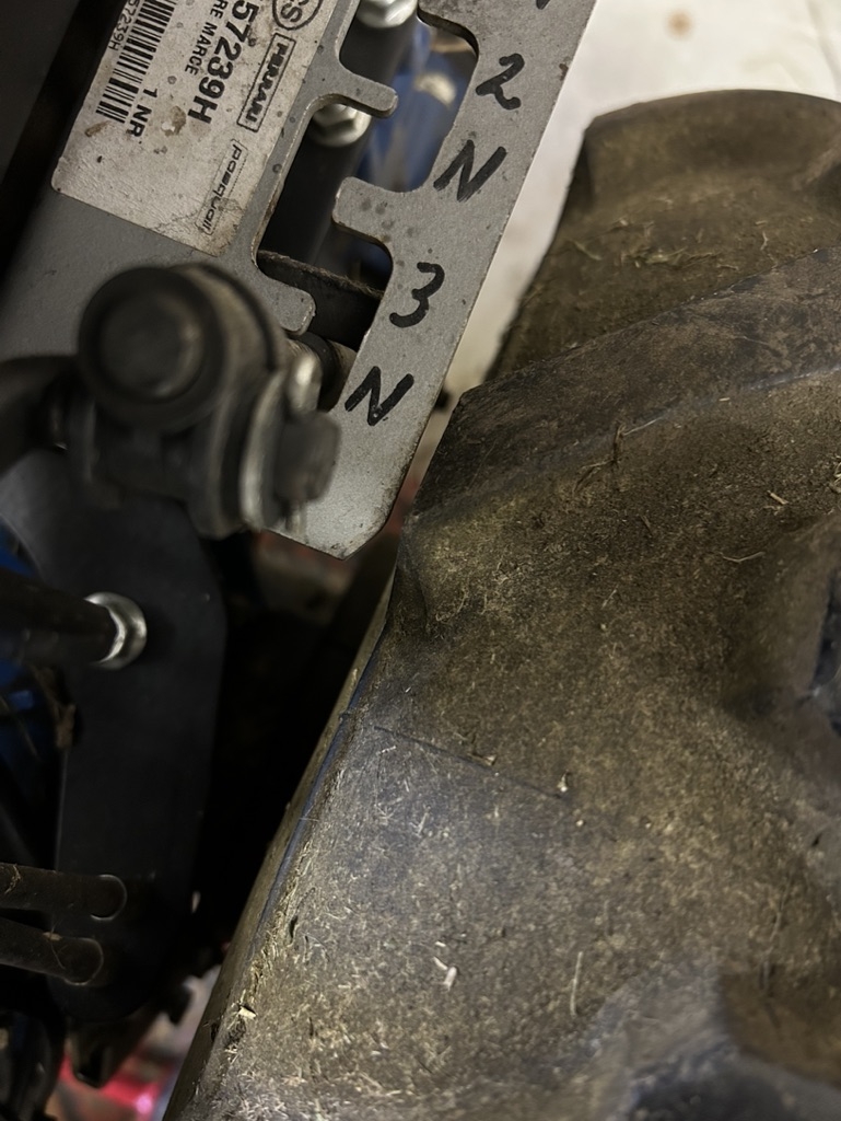

As previously said, my priority was to keep the track width as narrow as possible, and the limiting factor on the inside towards the tractor is the gear quadrant, as seen below:
I made a 3 mm (⅛’’) gap between the 5x10x20’’ tire and the gear quadrant to be on the safe side.
The next photo shows the 20'' wheel from the side facing the tractor. Here one can also see the only real drawback of this setup, with the valve stem facing inwards:

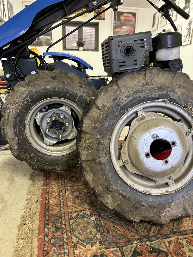

The next photo shows the inner wheel mounted on the tractor, with a 6 cm (2 ⅜’’) wheel extension:
The last photo is a close-up of the 23’’ wheel with 2 washers on each bolt for the fine adjustment:
This setup has worked very well for me for more than 10 years now, making the tractor very stable on moderate slopes, and still be within the working width of most of my implements. Especially when working with the 85 cm (34’’) Berta flail mower, the combined tractor-mower setup works very well.

   / Berta flail mower #88
Good post Jens.
I could have sworn the hubs did not fit over the drums. I remember checking that. But your pictures don't lie and I've been wrong before. I agree though that in that position it would make the wheels too close and probably contact the controls.
I fooled around with this before I put my weights and chains on for the winter. With my wheel extensions I think I was able to get the width down to 31" maybe? Just a little wider than the sickle bar. Seemed like that would be okay for the sickle bar. But really not for a 28" bush hog or snow blower. So I decided the duals were going to be of limited use for me not wanting to continually change wheels. I'd just use them for the disk. Which is really what I need them for in the first place.
Now that you say the hubs fit over the drums I'll have another look in the spring. Again, I suspect the limiting factor is going to be the wheels contacting the controls; exactly what you're running into. It looks like the extensions sold in the US are 2 1/4. Yours are 2 3/8. So maybe some things are a little different between the 739 and 740.
