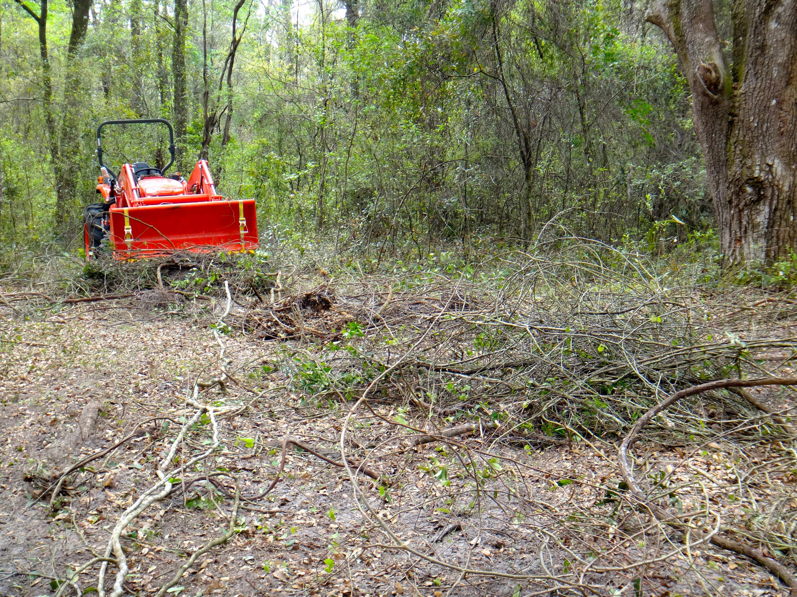

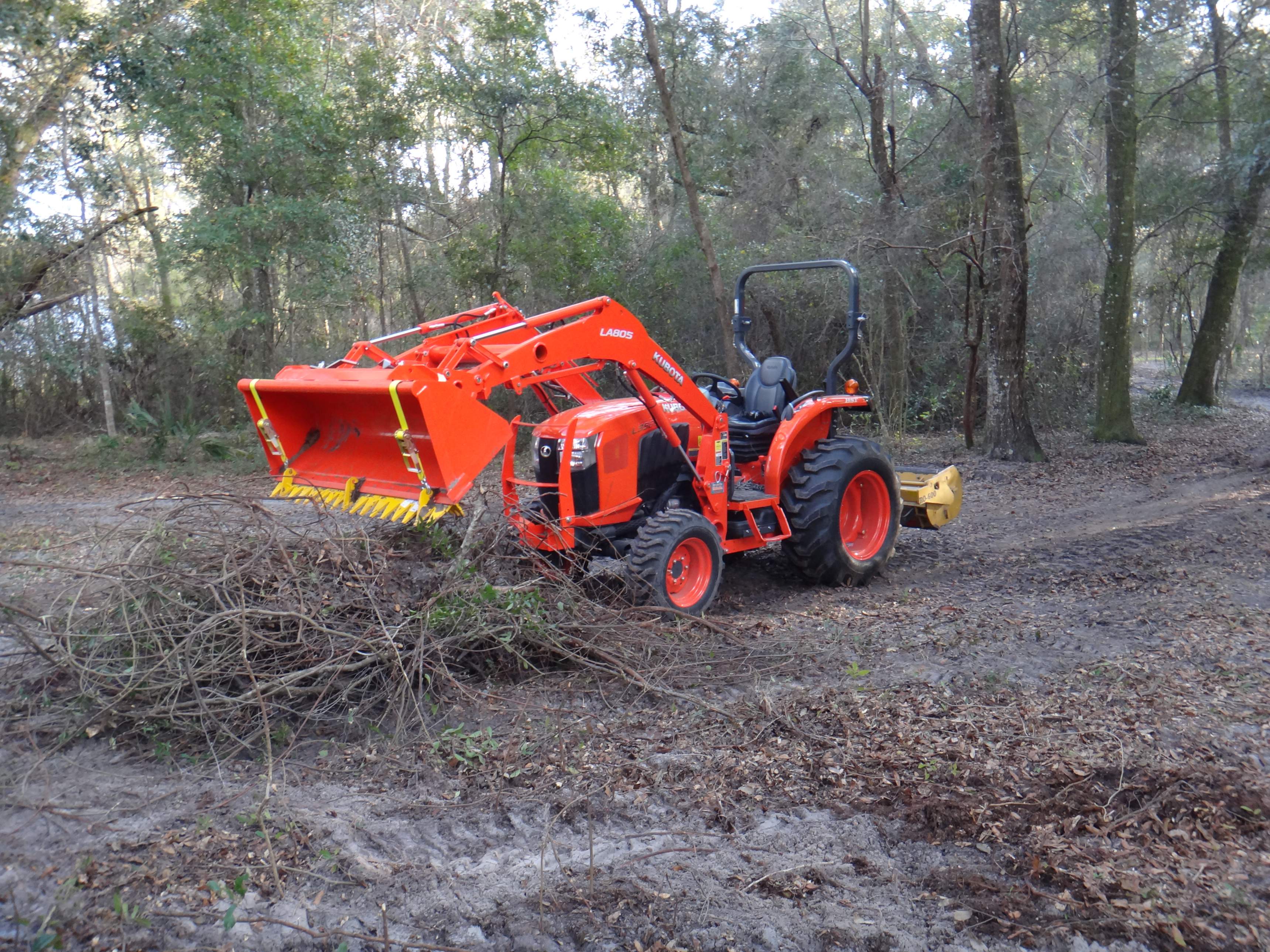

If you post some pictures of a worst case section sample it might make it easier to recommend which tool would be most useful.

A Landscape Rake is not that good for debris clean up. A grapple is the optimal tool.
You may want to consider a Westendorf Brush Crusher: Attachments for Tractor: Brush Crusher
A $350 Ratchet Rake on the bucket is quite good, certainly better than a Landscape Rake on the Three Point Hitch.

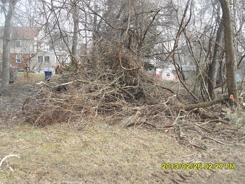

I HAD to get something to clean up a half acre lot that the tenants had not maintained in 30 years.
Virginia creeper, poison ivy and brambles so thick I couldn't push thru them. Lots of saplings up to 3" in diameter. A few trees 10" plus.
I tried a machete.
I tried a Stihl FS250 w/ brush cutting attachment.
What I needed was a rotary cutter but I couldn't find a decent used one and new was going to be $1.5K.
This is one of many brush piles we made. We used a chainsaw on the 5 or 10 trees above 4".
For the rest I used pallet forks and chains.
And I bought a pair of clamp on pallet forks for < $300. I was able to dig in just below the surface and just lift everything up. Sometimes I'd hit a big root, back off and try again. Where we had cut down the bigger trees the pallet forks worked great. Sort of a "poor man's grapple" when you add a couple of chains around the bucket.

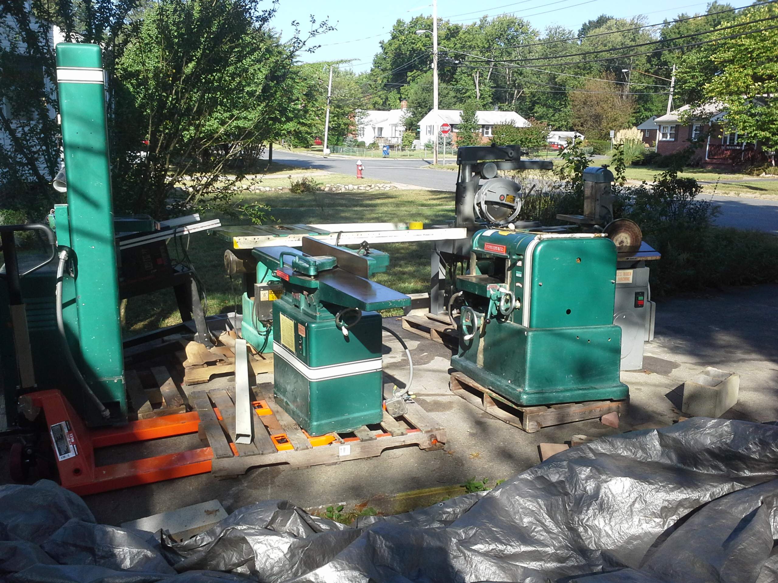

Like a couple of woodworking tools I bought in Northern Virginia and moved down to Mississippi.
If your topography allows pallet forks might get you 80% of the way there.
