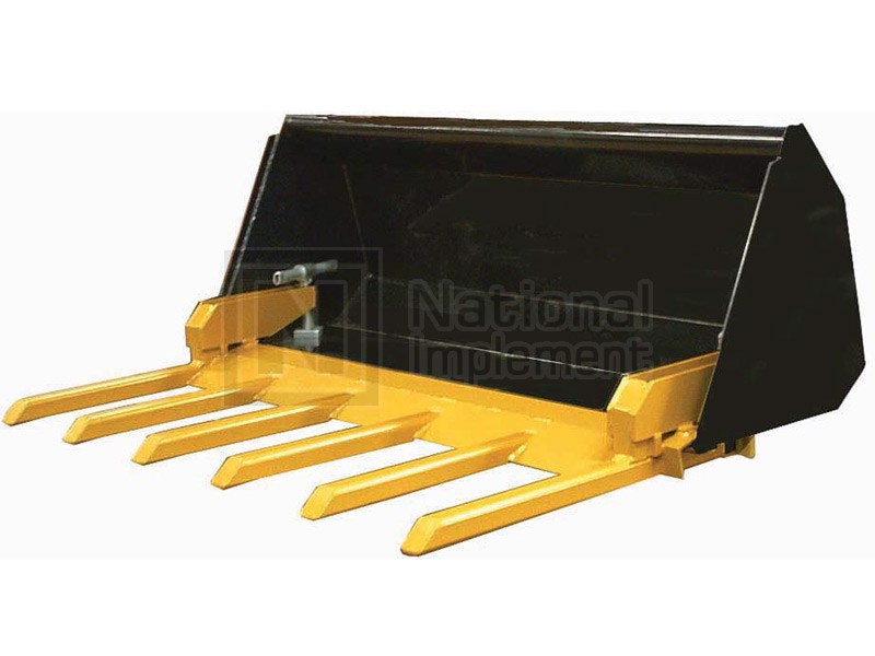

I said weight AND COST. There is a 50% ($600) difference in your prices for the different widths.
Eddie Walker mentioned using forks, with the difficulty in balancing a load. Brush forks might be another option:

Your pic of the bucket forks looks heavy duty. Do you own one? If so, your experience and where and how much, please?
And I agree that the difference between 66 and 72 won't matter in most situations weight-wise or $ wise.

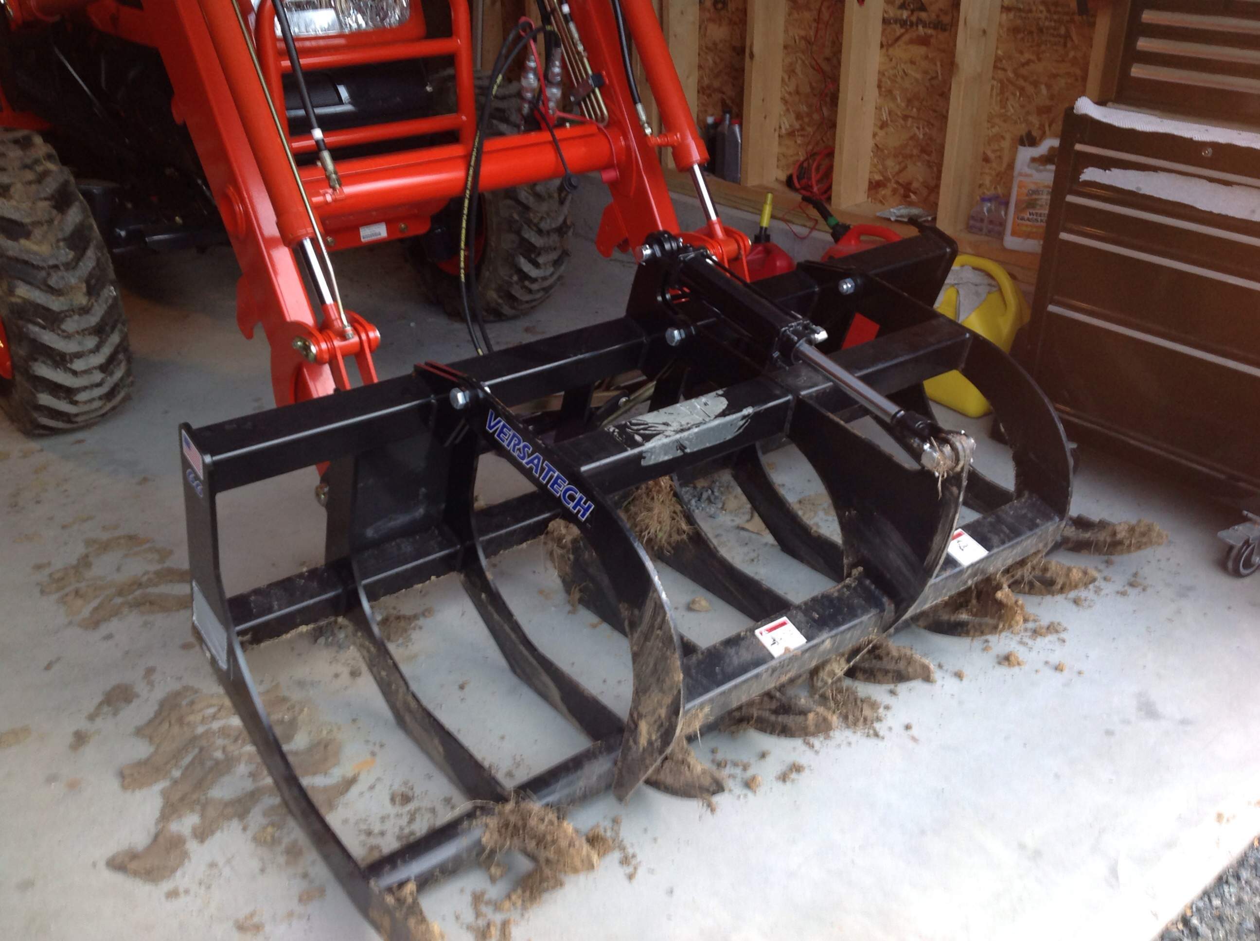

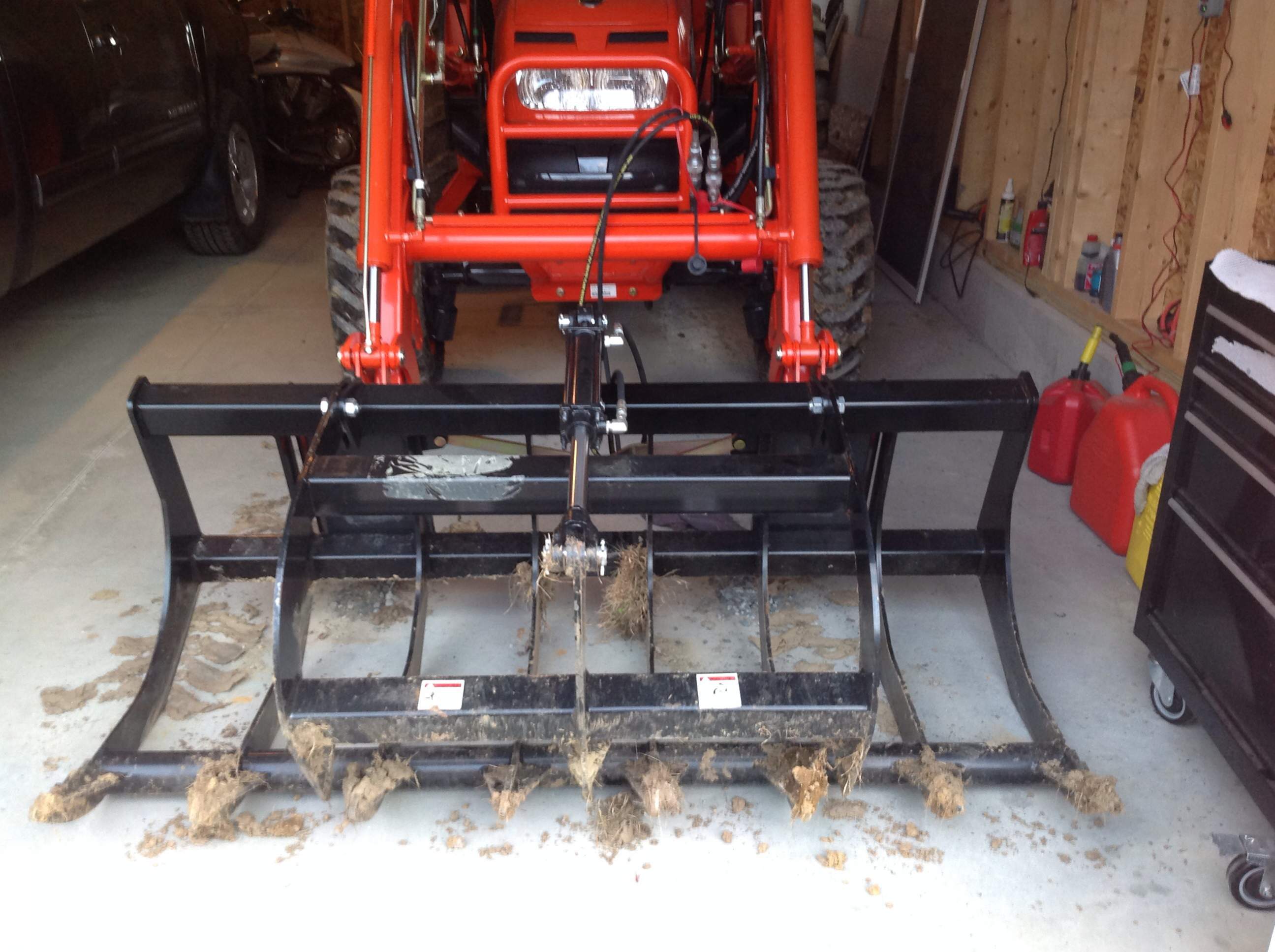

If you shop around you can you can find deals on a grapple, this 66" cost me 800$ at the auction.
Finally got it dirty too!

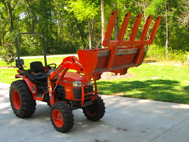

I have 58" aluminum clamp-on Debris Forks from Payne's Forks. Good implement, 2,000 pounds lift capacity, but pricey @ $800.
They work good for debris transport but not scooping up debris over sand. When you get the forks under the load you pick up as much sand by weight as debris.
Once you learn how to pick up, usually by pushing the debris against a tree to compact debris before lifting, the loads stay on the forks.
