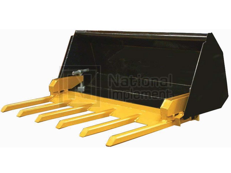

Eddie Walker mentioned using forks, with the difficulty in balancing a load. Brush forks might be another option:

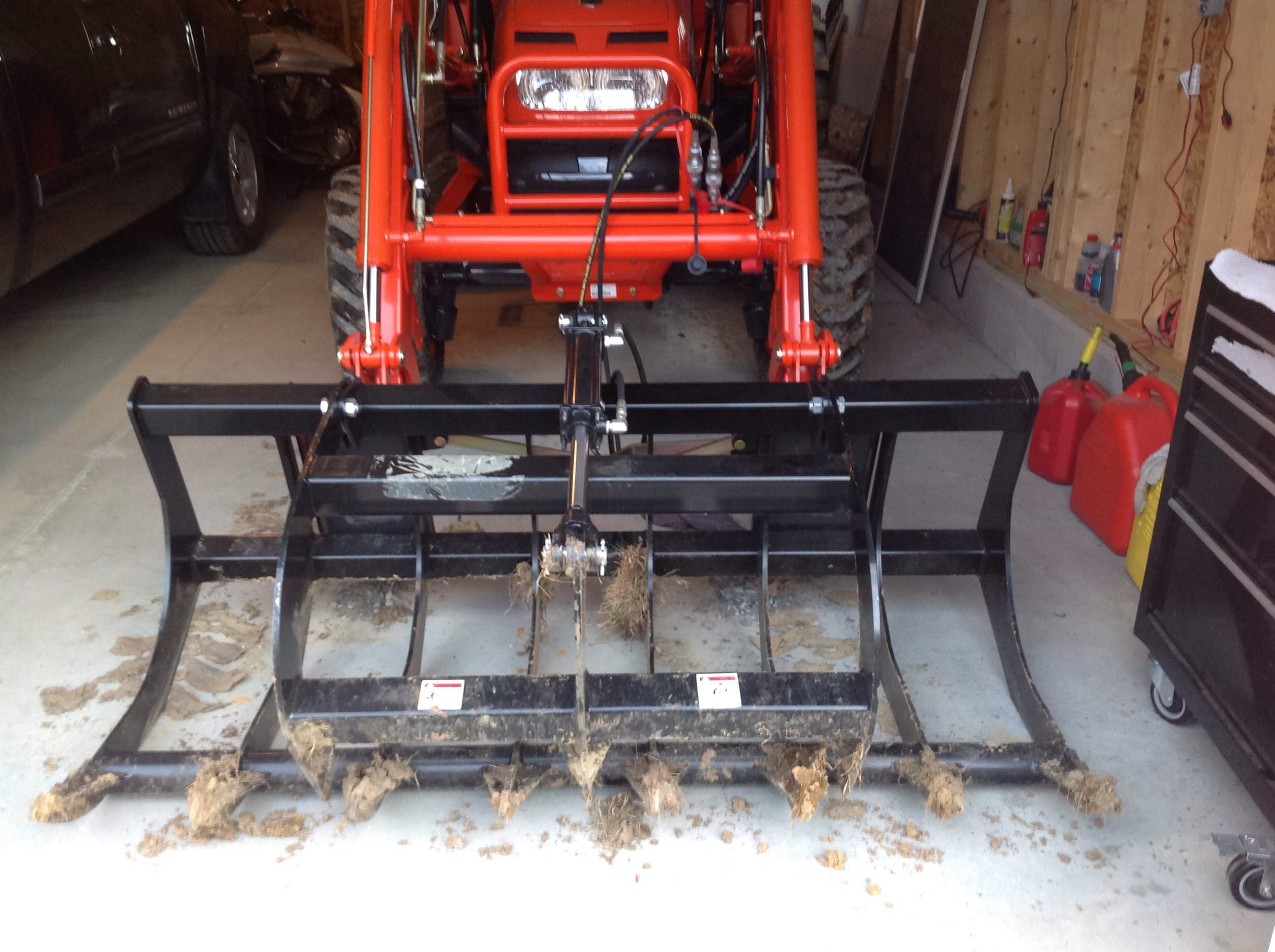

Have a Bradco grapple it has a flat bottom and around 5-6 inches between tines and a flat bar welded across the tips around 4 inches in with dual clamps. I can rake, level dirt, scoop large rocks move logs, pickup slash, toss burn piles and they spend more time on the tractor then the dirt bucket. You need a good set of grapples that are full width of tractor for the best use in cleanup along with the W R Long style third function valve kit, using a diverter or a separate rear remote complicates things and makes the grapples less efficient with having to use two hands to curl and close. Being able to scoop, curl and clamp at the same time with a loader will amaze you. For those that say you want to feather the clamps, a properly sized restrictor on each cylinder will give the proper closure rate and keeps them well synchronized in use with the electric third function valve.
Your pic of the bucket forks looks heavy duty. Do you own one? If so, your experience and where and how much, please?

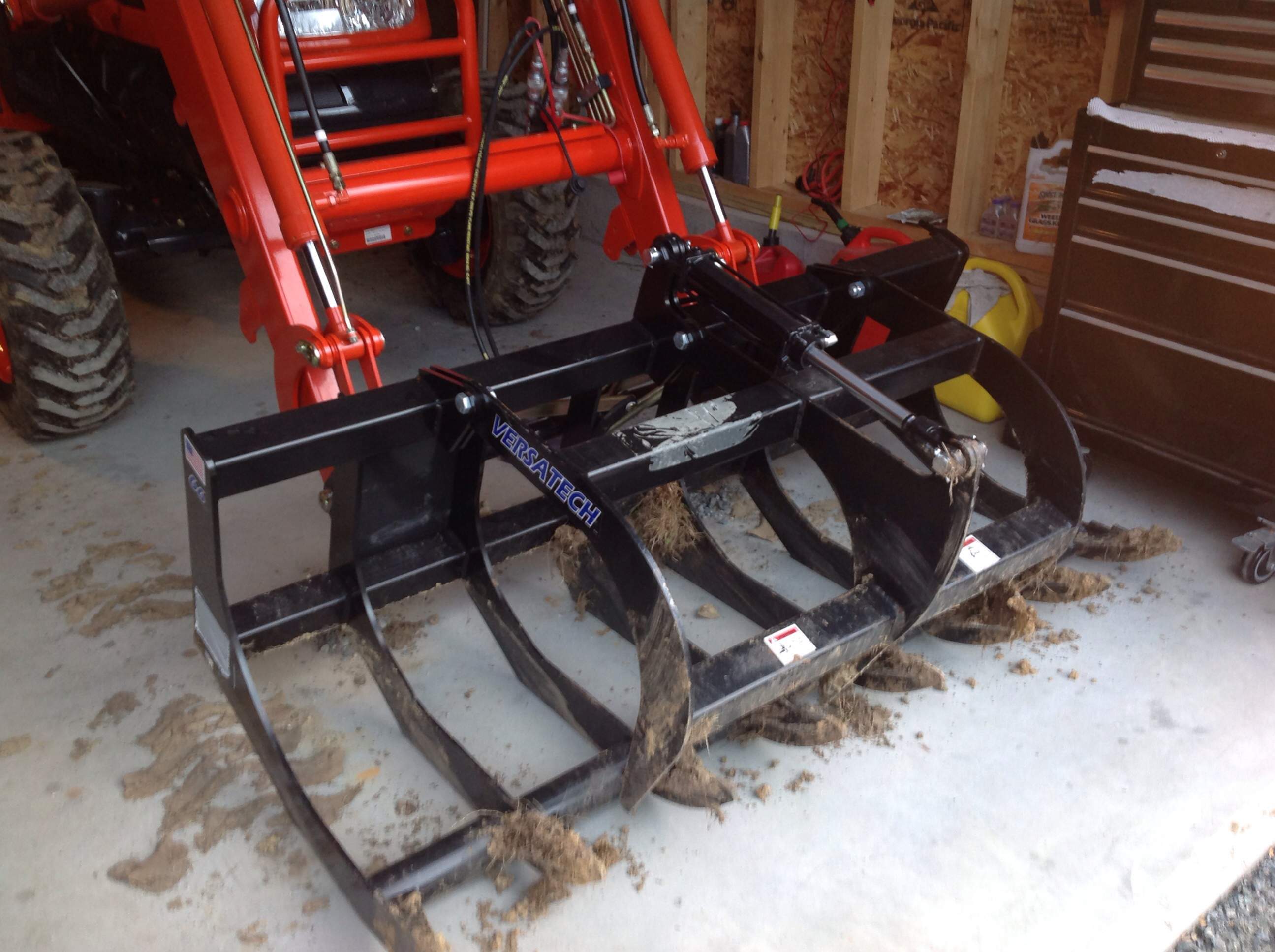

If you shop around you can you can find deals on a grapple, this 66" cost me 800$ at the auction.
Finally got it dirty too!

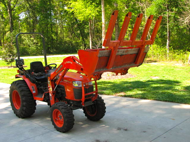

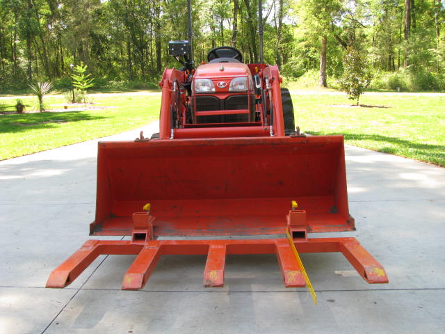

I have 58" aluminum clamp-on Debris Forks from Payne's Forks. Good implement, 2,000 pounds lift capacity, but pricey @ $800.
They work good for debris transport but not scooping up debris over sand. When you get the forks under the load you pick up as much sand by weight as debris.
Once you learn how to pick up, usually by pushing the debris against a tree to compact debris before lifting, the loads stay on the forks.

Well thanks to all the help on here, the help from Travis at EA and Brian with Fit Right Hydraulics the deed is done! :thumbsup::thumbsup:
Brian got me setup with my front hydraulics and controls and was a huge help with guidance on my present and future needs for getting this new to me tractor setup correctly.
Then Travis over at EA took his time to understand my task at hand and also future needs in choosing the right implements to get this job going. I went with the 72" Wicked Root Grapple and then he helped me understand the benefit of combining this with a 72" Severe Extreme Duty Landscape Rake so these are both on the order and running them together will be the cats meeeeoooowww! :cool2:
Now time to get to work..... :drink:

Congratulations, I am glad we could help spend your money:). I am sure you will get a lot of use out of your new setup.!

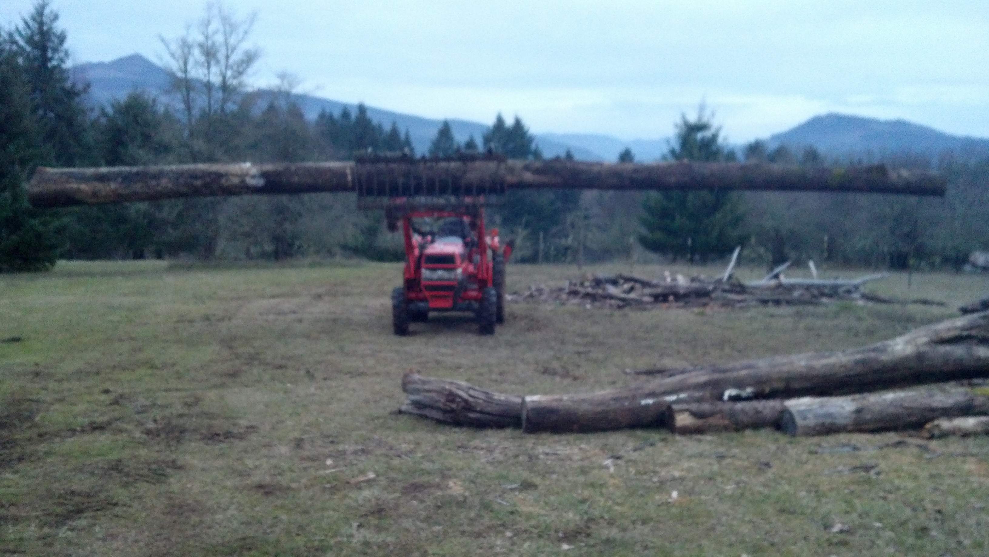

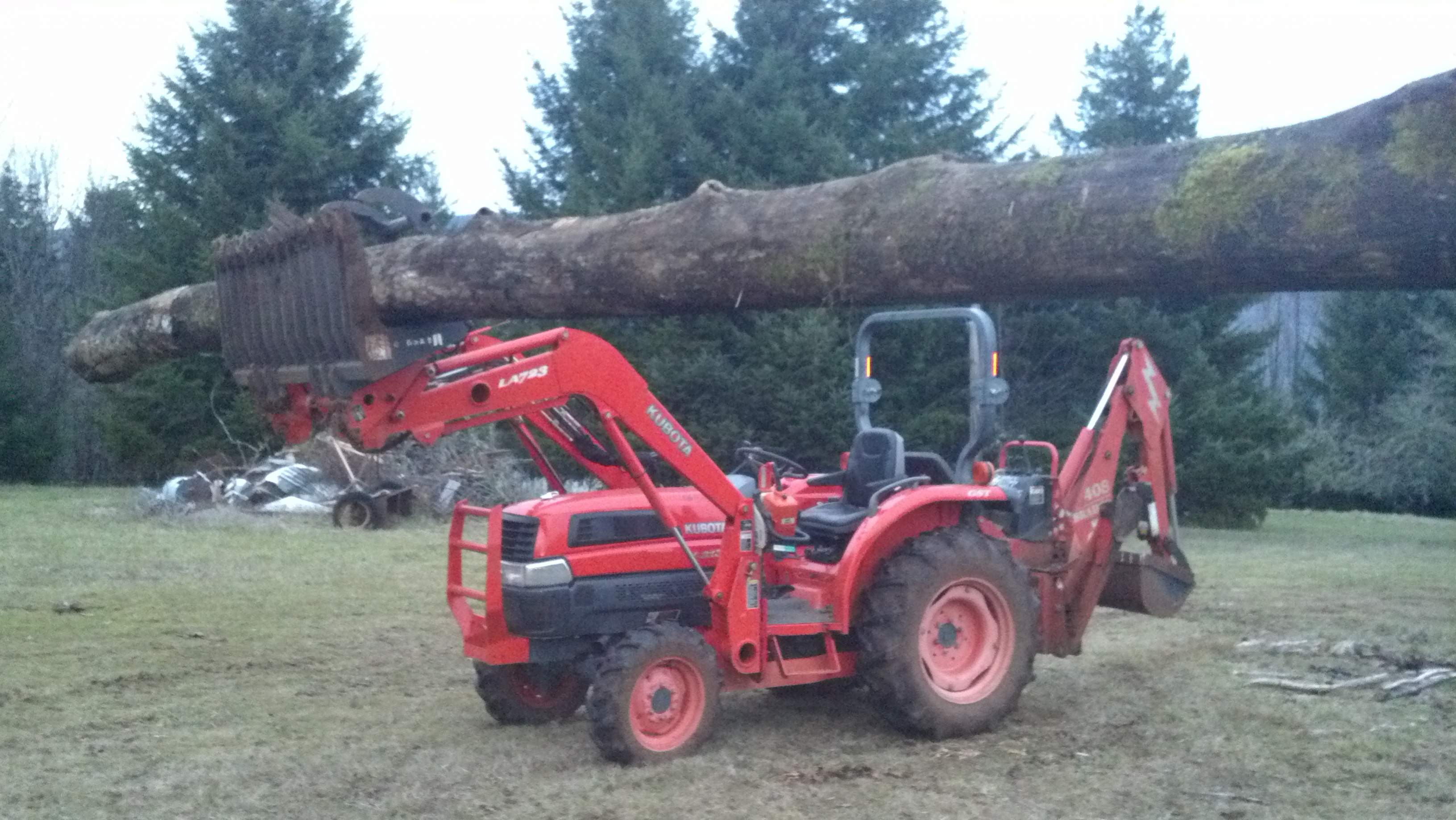

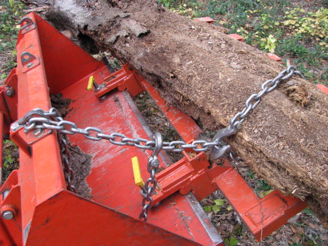

If it is too big for tractor then why can my L3130 do this?
