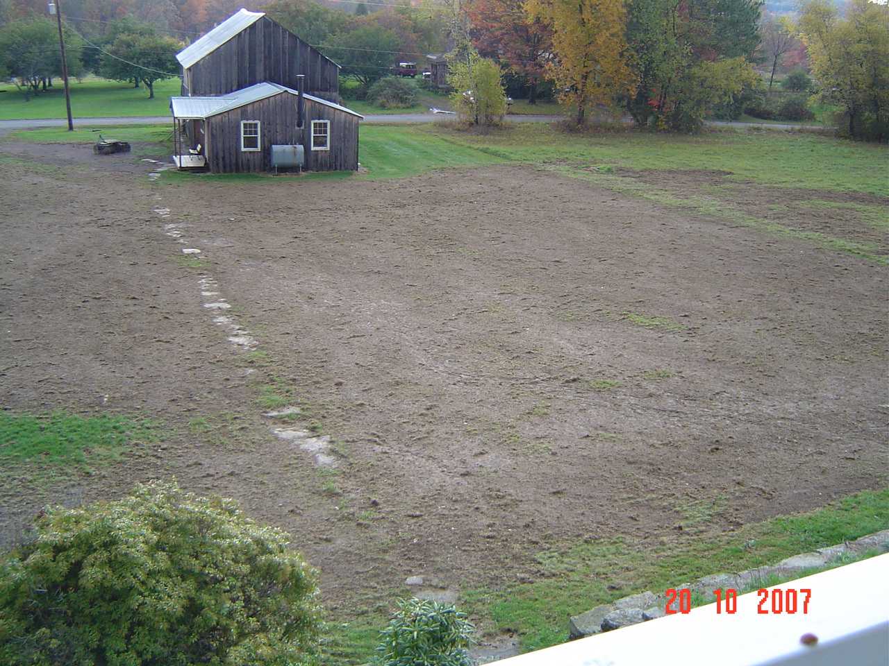

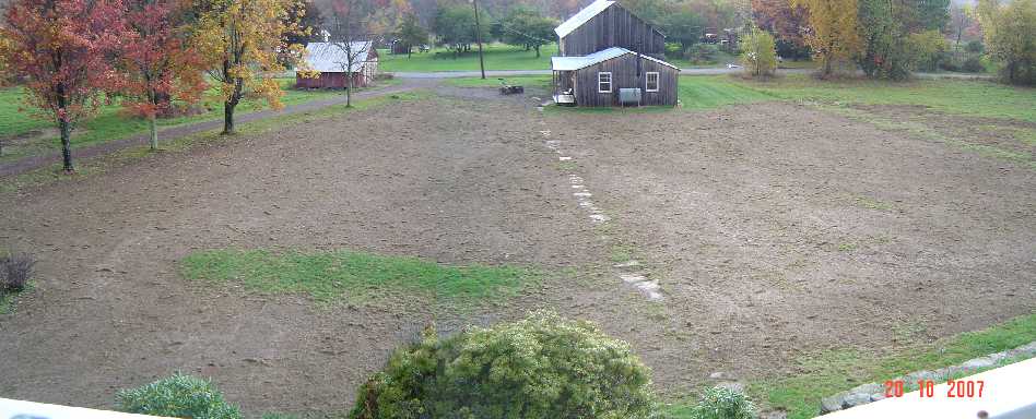

Unfortunately, I'm afraid you are going to have to bite the bullet and start from scratch. I had the same thoughts. You could fill in the holes, but it ends up looking pretty unsightly, until the new grass comes in.

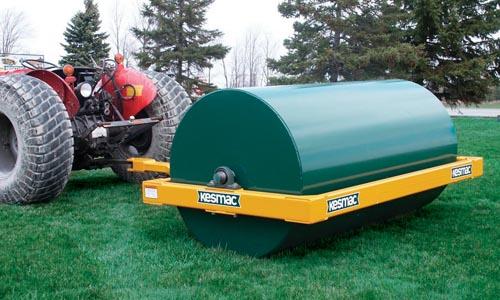

There is one implement, which "could" provide an improvement, depending on the soil, it's moisture content and amount of irregularity ... a good sized, heavy roller.
I kinda had something, like this in mind!

Don't really have holes to fill in, just typical field type conditions and depressions from the gulley washer rains we had this spring. I've already smoothed, seeded and covered with straw this past fall (got no rain), did it again in one area this spring (got the gulley washer rains), but have some grass/crabgrass in those areas now. Concerned I put all that work into it again and get the washout rains.
So I know rolling want help, much to hard and rocky for that. Guess I will just use the box blade again and start from scratch. Thanks for the help and suggestions.

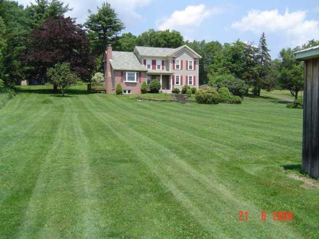

A few years ago, I did a rehab on my yard. I bought a surplus used top dresser (from a turf supply company) Just like this one.... Top Dresser, Turf Truckster, Grass Machinery, Turf Equipment
I made my own mix of "engineered soil", using screened top soil, sand, some peat moss, a bit of lime, and fertilizer. About once a month, for several months, I'd put on an application of that mix, followed by dragging the lawn with a section of chain link fence. Dragging would pull some of the soil off high spots and deposit it into low spots. After a while, the low spots started filling in and the grass never "went away". Once completed, I rented a Ryan self propelled core aerator and went over the entire yard with that. The next spring AND next fall, I power seeded, treated for weeds, and then fertilized again. The lawn now has that golf course appearance we all strive for. Smooth as a pool table, green and lush.
Must be noted there were no severe rough spots before starting, just a bunch of choppy bumps and holes. Any severe areas would have probably needed spot repair before starting the top dressing.
In the end, over a 2-acre area, I used approximately 5-1/2 cu yds of soil mix. Not all that much in the grand scheme of things.
This was a LOT of time consuming work, but what the hey....It's worth it when completed.
