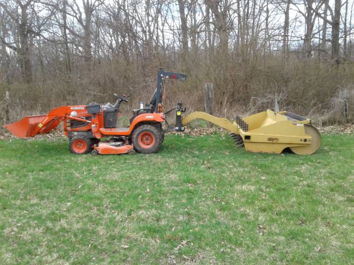

I am only going to make a few comments, whatever you decide to get (landplane grading scraper IMO) don't even bother with anything less than 1000lbs. Weight is your friend when it comes to this type of work, heavier is better. (y)(y)
If your tractor has draft control, learn how to use it and the job will simply be that much easier.

I agree completely with MtViewRanch. My driveway is crusher with lots of fines and it gets so hard the scarifiers won't touch it with my smaller 450lb box blade. The new landplane is closer to 1000lbs and it has enough weight to let the rippers start to get under the material. If it is really hardpack, think about rippers with no end that will fall off. I got to the point I was welding them on as I kept losing them in the process of ripping a half mile of driveway. Not trying to rep a brand here, but the EA shanks are drop and go. No parts to fail vs. my Landpride box blade and tool-less to adjust.

I use a ABI TR-3 on my crushed stone driveway. (The lesser models may not have enough weight for the scarifiers to be effective for you.)
I use the TR-3 to re-work my previously neglected driveway (pot holes, ruts, un-level, poor crown...). It also makes for great mechanical weed control.

I finally made my decision. I was just going to just get a 6' landscape rake but the company that has me doing this job on a monthly schedule wants me to do another business they manage on a quarterly basis. So after researching quite a bit, I found a very good deal at Titan Attachments. That's where I bought my pallet forks and they usually have really good pricing on quality stuff.
Their 8' Land Leveler with the shanks is on a killer sale right now. Normally $3069 but it's on sale for $2302. Plus I had a code for 5% off anything. That's cheaper than their 6' leveler with shanks. I suspect the 8' is not as popular a choice as the smaller models. Anyway, I hope it arrives next week. I have an additional 31 yards of crusher run being delivered so hopefully by the end of next week, we'll be done.
