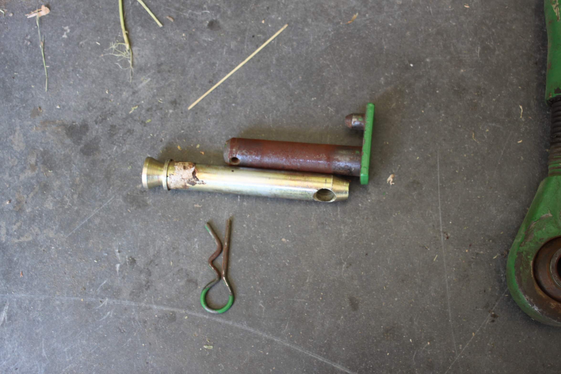

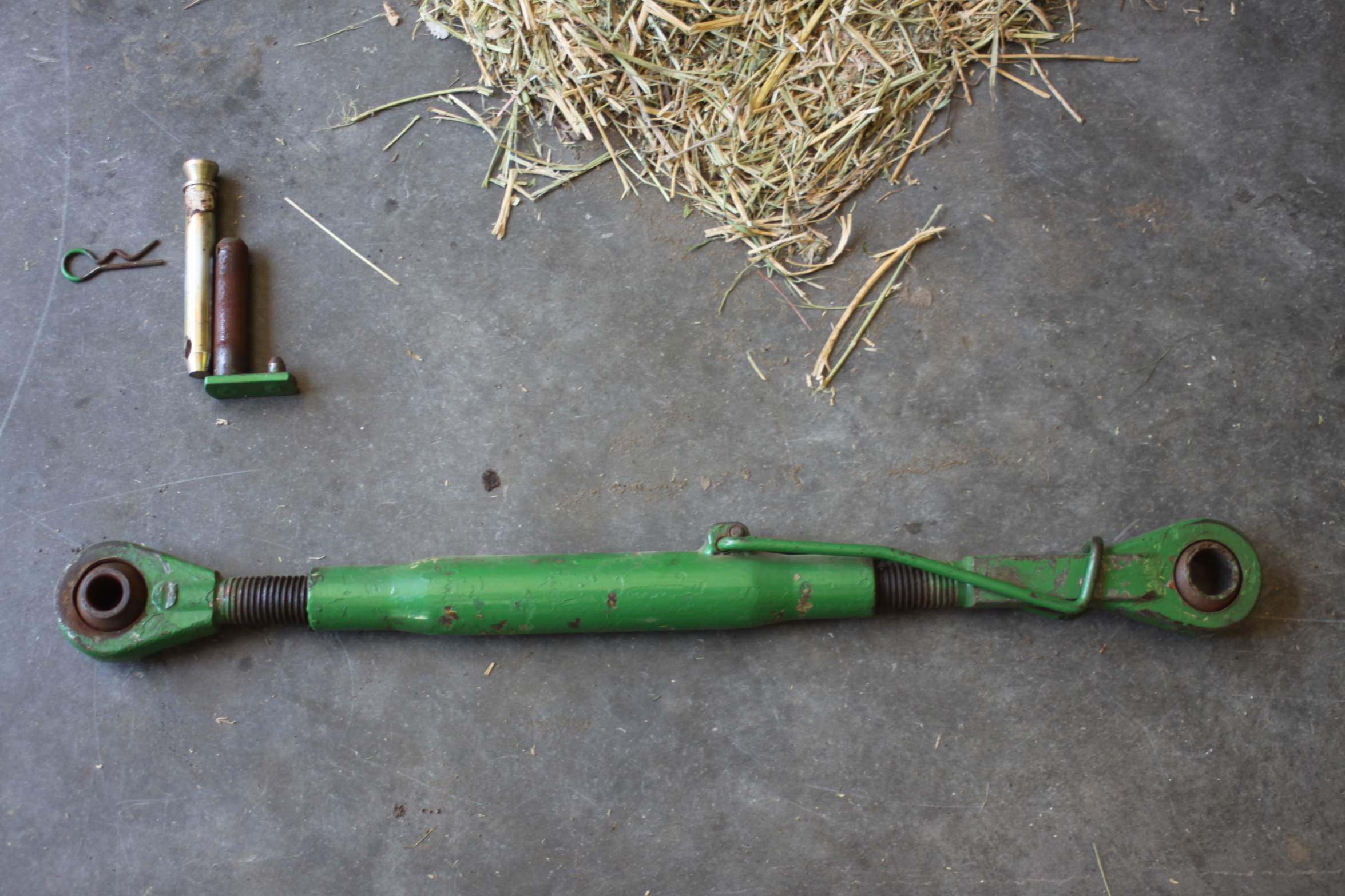

OK got the measurements.
My Cat-1 pin is .75" (3/4") and the impliment end is 1.00". My factory tractor end pin is .790" or 20mm.
Here are a couple pix.

I will have to double check mine now, but I know that my factory pin goes into an aftermarket JD top link for your tractor. Not sure if .040" is much to worry about on our tractors anyway though.
