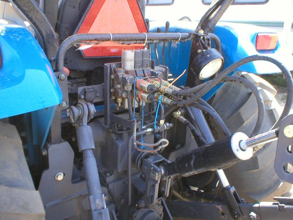

I just got my CCM HTL today. Installation was pretty straight forward. The local farm store did not have all of the fittings I needed, so I am using a mixture of straight and 90 degree fittings. Either way, it is installed. Have not fired up the tractor to start pumping fluid, but I thought I would share my info thus far.
Someone was worried about using the tractor-to-toplink pin. Both ends of the Cat II HTL from CCM are Cat II in size. Never paid attention before, but my factory top link is Cat I on the tractor end and Cat II on the implement end. I had to install a Cat I to Cat II bushing on my tractor toplink pin. No biggy. However, I thought I would tell all because of the issue above with the bigger-than-Cat-I pin size. If you can get a bushing for that pin for a Cat II top link hole, you are in good shape. No need to "drill" the HTL. Don't know how you would do that anyway...
For those that use a HTL, do you leave it on the tractor when you are not using an implement? My factory top link stowed away on a hook real nice, but my HTL will either come off when not in use or I will have to come up with a better stowage mechanism. I will probably just remove it.

Not sure what type of hook that your factory one is, but I just took my stock hook and opened it up so that it is big enough to hold the cylinder. This has worked out very good for me for the past 5 years.
   / "Best" Category 2 Hydraulic Top Link? #29
My hook is in the center and above the toplink bracket on the tractor. It also swings side-to-side. I just raise the HTL and put the hook around the rigid hydraulic tubing near the DPOCV. Since it's only the weight of the HTL, the rigid tubing is fine for hanging the HTL on the CCM toplink.
