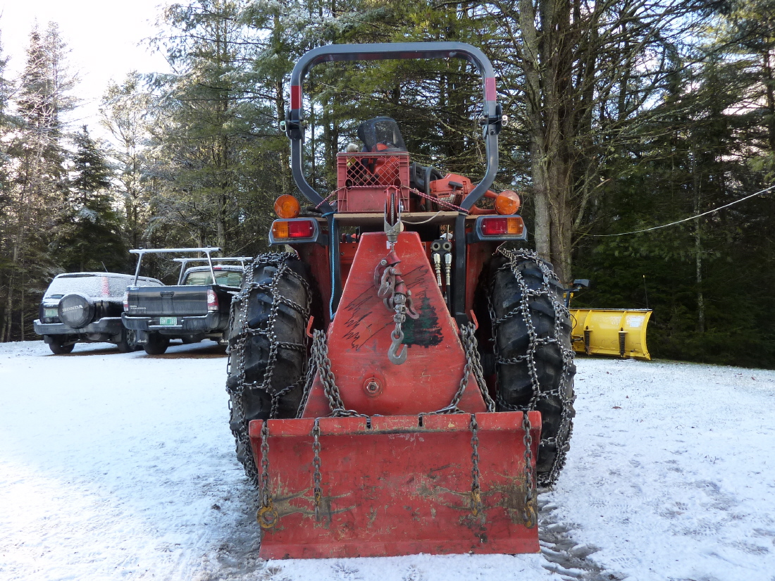

Studded H pattern is great on ice and snow. Would be hard on asphalt though. All my roads are dirt.
There is some controversey about the wisdom of chaining up the front. Great for traction and control, potentially hard on the relitively weak front end drive system.

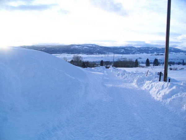

This is the norm from November to March, and this is not "back country". For us, back country can be 60 feet deep and impassable on maintained roads until mid-July.
I use "H" style chains front and rear in MFWD and have for years. The fronts are crucial in some areas because one slip could put you down and upside down, and no one knowing until daylight.
