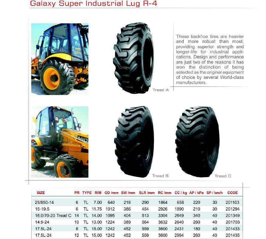

DIXIEDOG, I stand corrected. Those are a R-4 type tread, they look to me as an odd looking tire. What brand are they?
David
Specialty Tires USA. They were also a factory installed option on International 2544 tractors.
/ Best Chains #22
Thank you DIXIEDOG, I'm sorry I steered you wrong. I've been around a lot of tires in past 10-yrs. and have not come across R-4's in a 00.9- 00 config. most R-4's that I see are 00.5-00 config. Course that don't mean much, I live a sheltered life here in downeast Maine:eek:

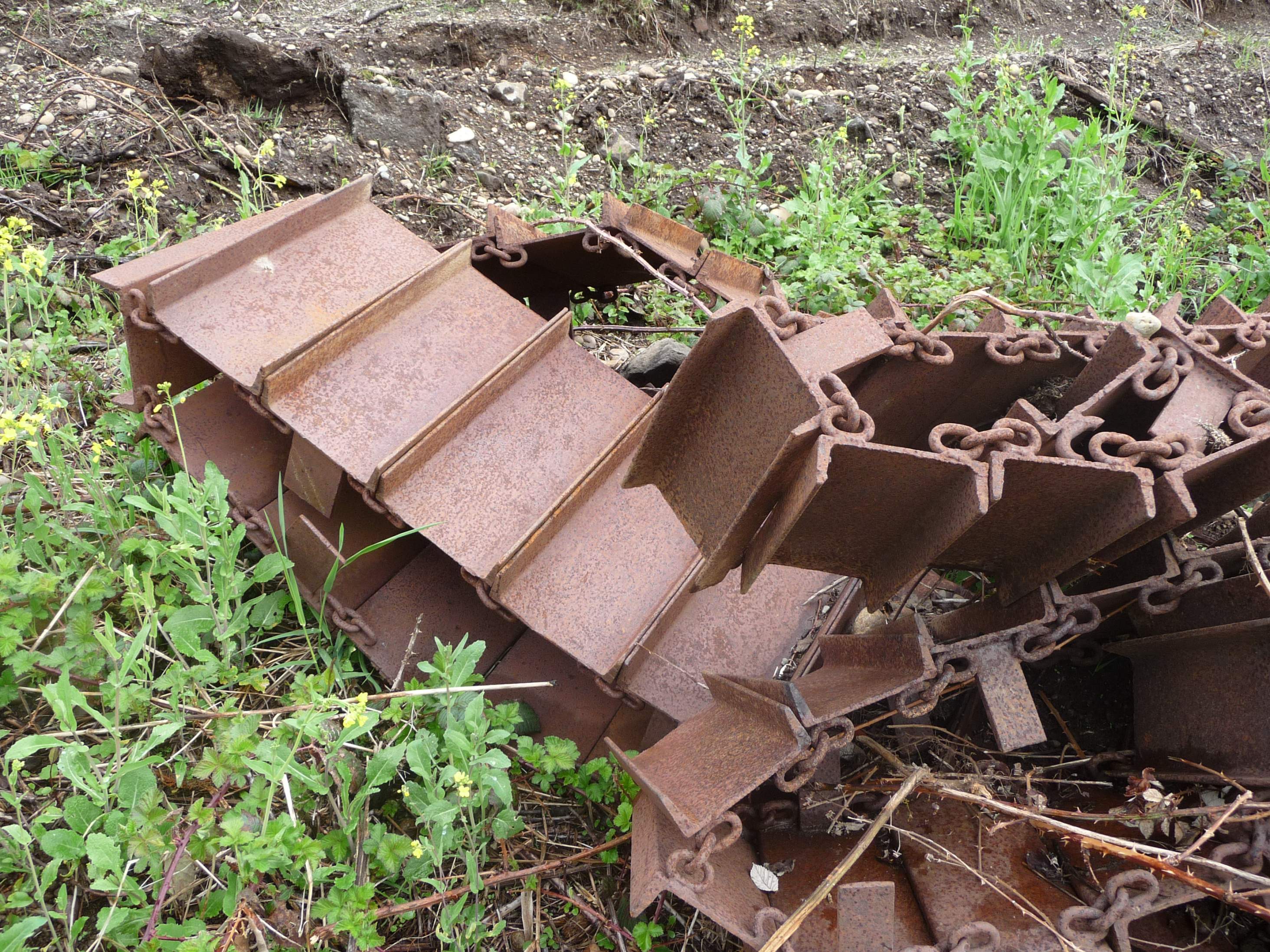

Dixiedog, try a set of these. I should put them on so you can see the rig in action. they don't sqeak, drop between the lugs and have great flotation.
I initially built these because I was getting flats from mowing hawthorns. All they are built from is 8in channel and 6in for the front with links of chain for the hinges and some flatbar to keep them centered on the tires. They worked very well and traction was great in soft areas. I did some sidehill work and they stayed on with no slippage.
The way I put them on is to lay them out, put a rope through a spoke on the wheel drive it on, deflate the tire, bolt the ends together and reinflate. That way they are tight.
YOU HAVE TO POST A YOUTUBE LINK WITH THESE ON YOUR TRACTOR!! PLEASE!!:cool::D:) I'd love to see that.
