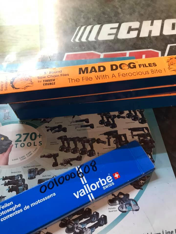

Good files $16 a dozen if that is all your doing. Unless super long chains.

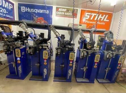

Guy north of me has a mail order business for just doing chains. He has 5 Frazen machines.
His website if you get to that point. HOME | razzorsharp

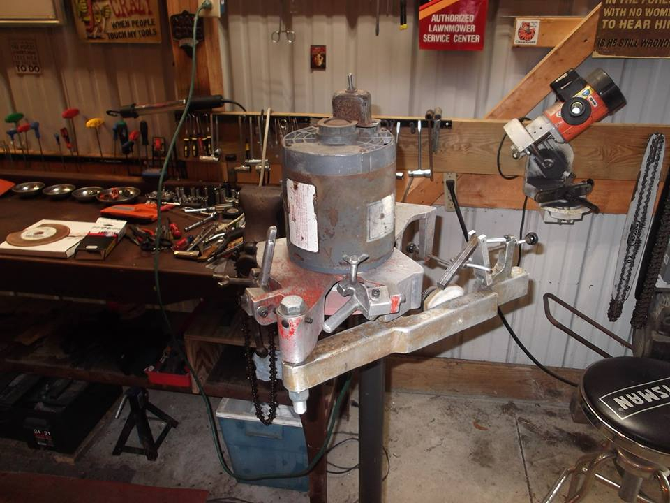

Off the saw means a stand alone chain grinder. Many available, from a cheaop HF grinder to an expensive Stihl grinder and everything in between.
Myself, I sharpen my chains on the saw using a Timberline sharpener with a Tungsten Carbide cutter or hand file them (and cut the rakers) using the Stihl guide tool. Only exception to that is the skip tooth square cutter chain on my 075 Stihl. That has to be hand filed all the time.

Back in the day when I was dulling chains frequently doing Chainsaw Milling (CSM) on hardwoods I'd got through chains fairly quickly.
I developed the habit of hand filing (basically touching it up holding a file in my glove)) a chain 3 times. It would then go for filing it with a Granberg File-N-Joint Precision Filing Guide . repeat.
Once it got through 3 sets of hand-filing/granberg I'd take it to my $100 Northern tools bench grinder, a knock-off of an Oregon grinder.
But over the years my touch ups got better and I've stopped using the Granberg.
What would you recommend?
So I'd recommend investing in a good hand filing system (PFERD, Stihl) and then an oregon bench mount grinder.

I sharpen with an Oregon grinder; it does a great job; I kicked my POS HF grinder under my bench long ago! If needed I'd buy the Oregon grinder again.
