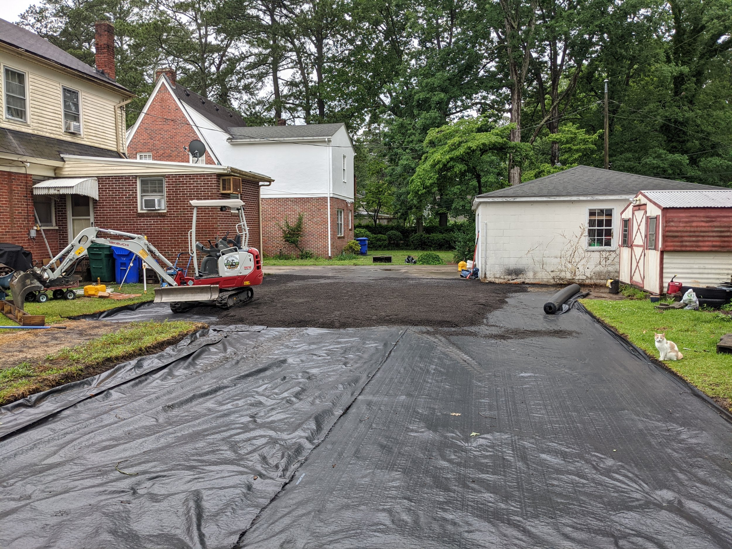

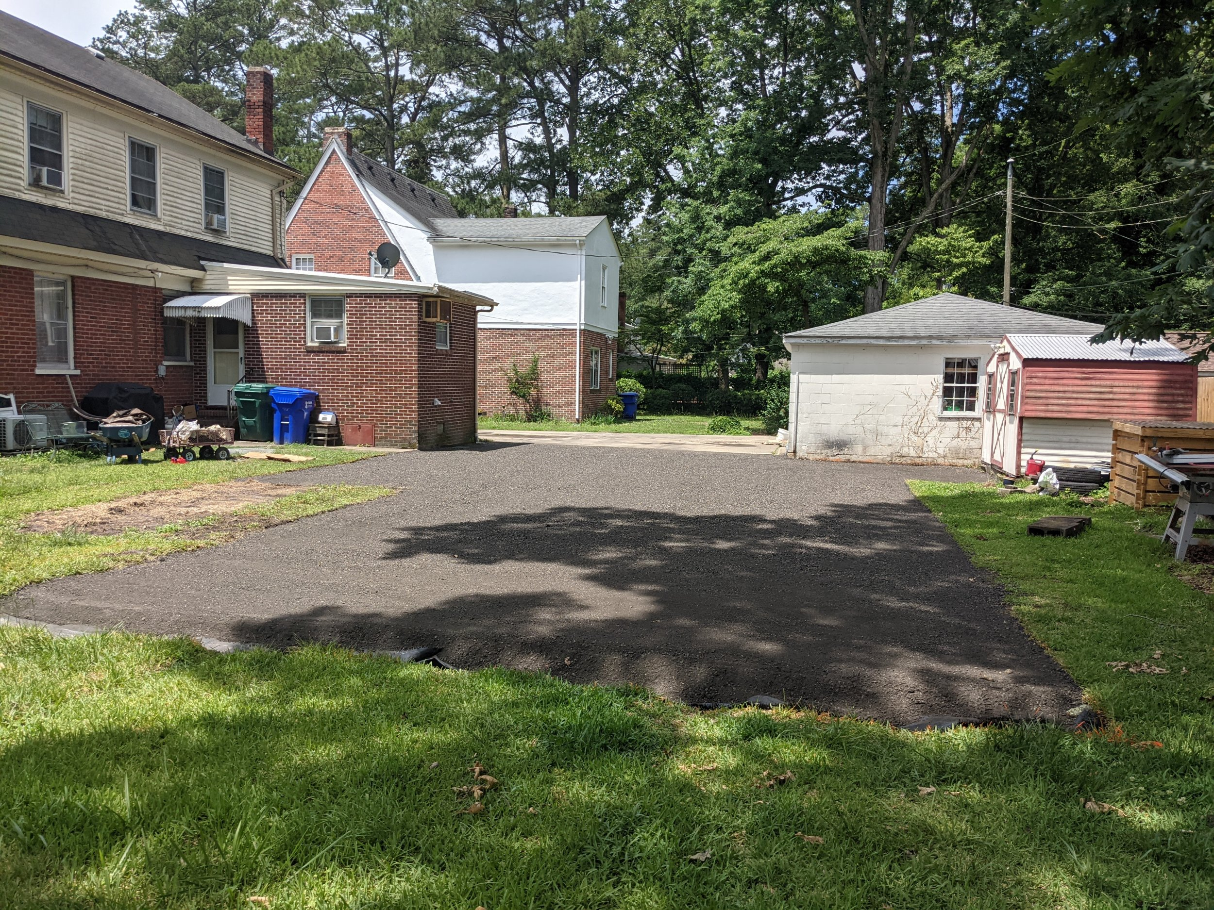

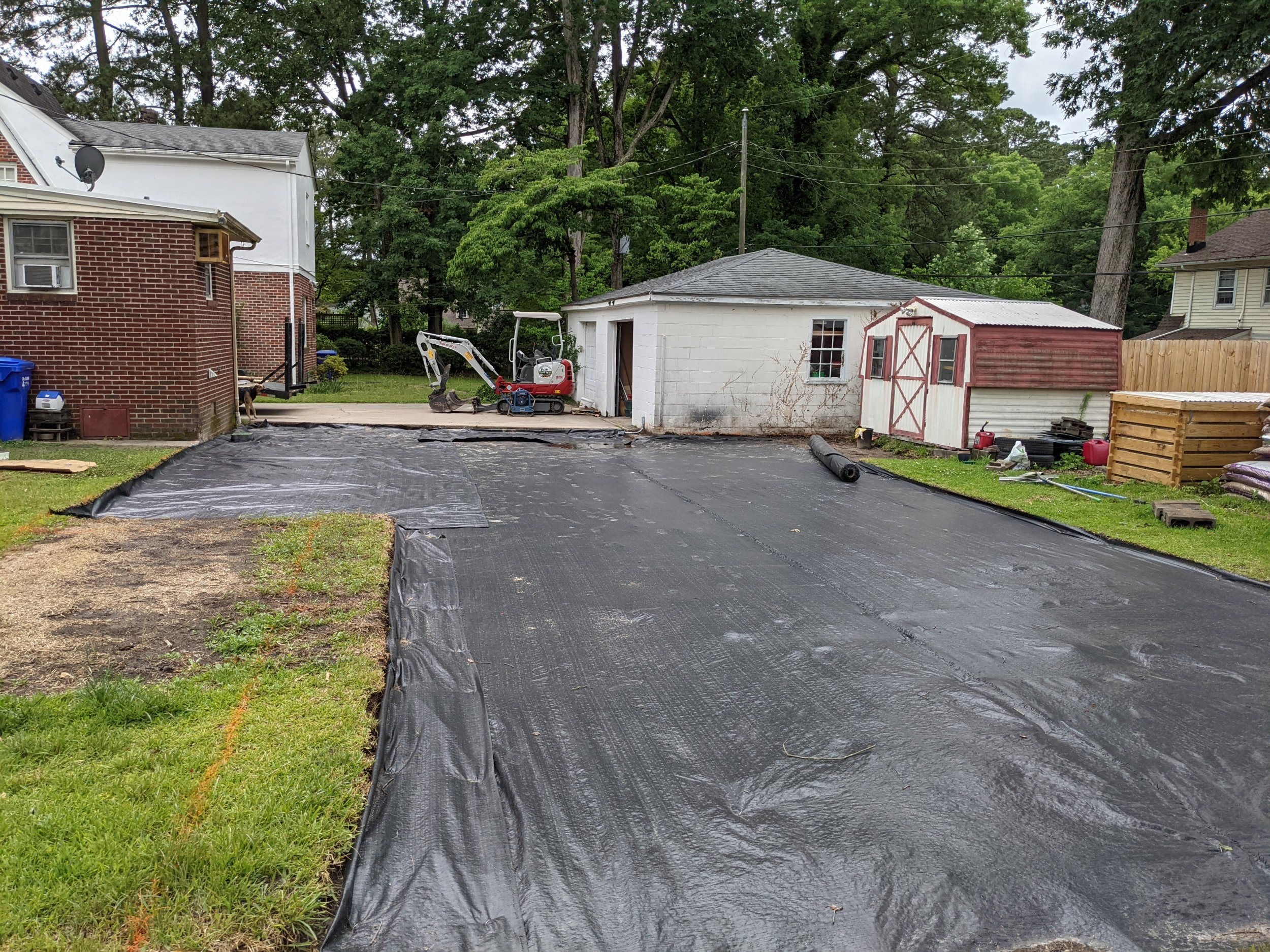

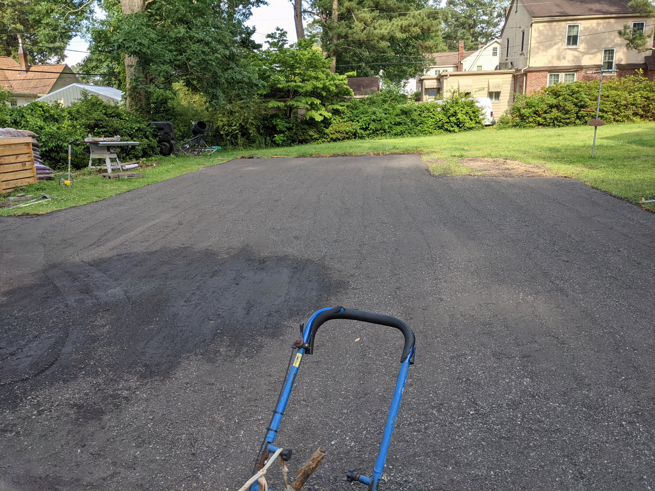

Can you post pics of the finished compacted recycled asphalt? Curious how it looks compared to a regular asphalt driveway.
Here is one I did. It continues to
together for a few months after laying it down but there are always some loose rocks on top. To compare to regular asphalt is a little unfair as it cost 4 to 5 times as much as recycled. The recycled asphalt is the best reasonably priced/cheap driveway I've found. No it's not as good as new hot asphalt or concrete but for the price it's pretty awesome.

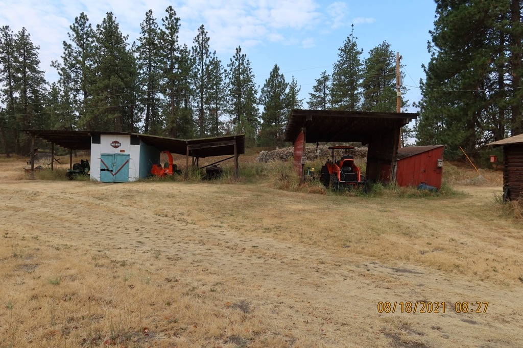

I pull off my driveway and park wherever on my lawn. Spring and summer photos of my lawn. Summer gets mighty dry around these parts.
