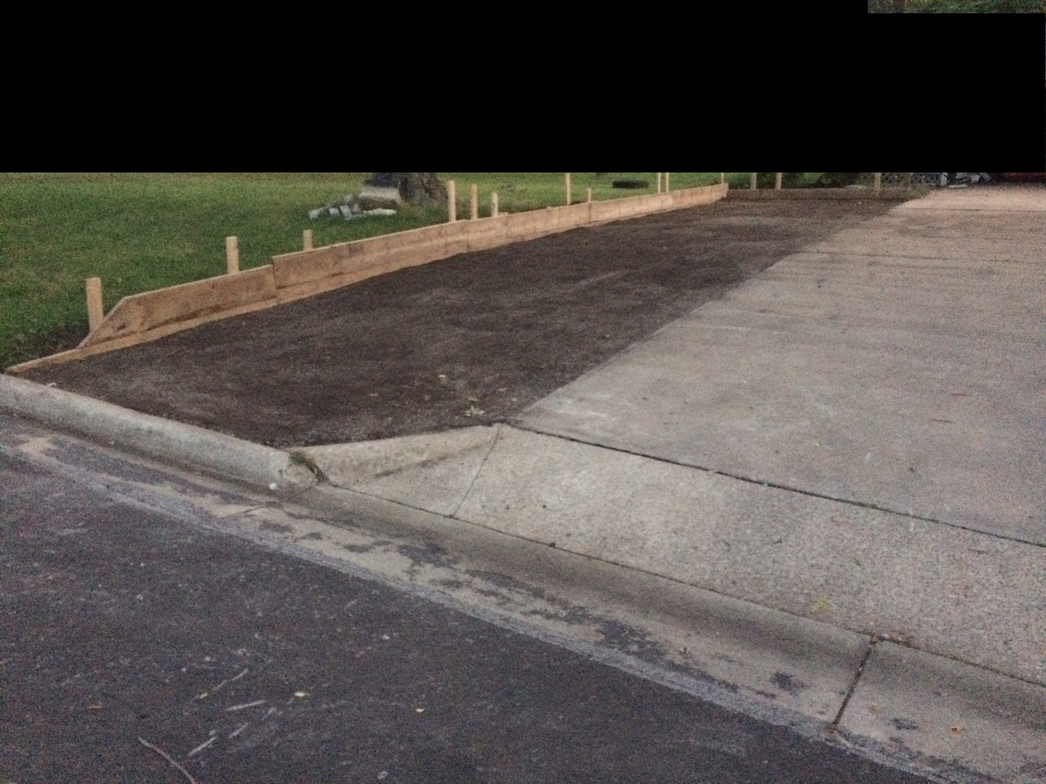

Can you post pics of the finished compacted recycled asphalt? Curious how it looks compared to a regular asphalt driveway.
Here is what my driveway extension looked like, when first finished:
This is a more recent picture that shows some closer up.
