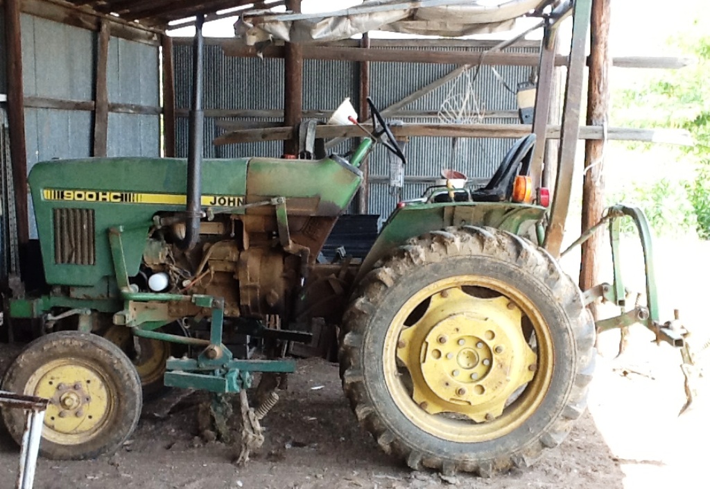

My brother-in-law is a truck gardener in Missouri. He now has 4 tractors but its overkill. One is a Kubota L3000 that is pretty well beat to pieces but he uses it for general stuff. It has a loader he uses for lifting and loading. He also uses it for general stuff. This tractor, however, is the very handy one for vegetable farmer. He only uses it for cultivating because of having the other tractors around so he can leave the cultivator attachments in place. Something like this is handy and, if you can find one, relatively cheap.

Want something to use ag attachments to help plant 3-5 acres of vegetables. Spend $10-$15k. Looking at all models but I can't figure out what I need and don't need. Seems that most ag attachments want something with less than 50hp .... so I'm thinkg 30-40hp??? Any suggestions? I don't want to pay for features that either I don't need or that will interfere with planting. Thanks...:)
3-5 acres of row crop veggies? You could do this easily with something like the 1951 Farmall Super A I bought a few years ago for $1300 (including a true 3-point hitch, a 5-ft rear scraper blade and a 6-ft mid-mount sicklebar mower).
You can find deals like this on small tractors and implements (rototillers, discs, plows, planters, cultivators, sprayers, etc) all the time on eBay, Craigslist.
Shop around. You don't need to spend $10-15K for small time farming like you plan to do.
