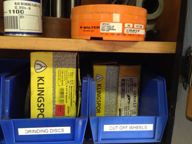

These are pretty good. Pretty much bought all the abrasives my tool truck had left when he retired. When I've used up these cutting discs I think I'll go back to Walters though.
