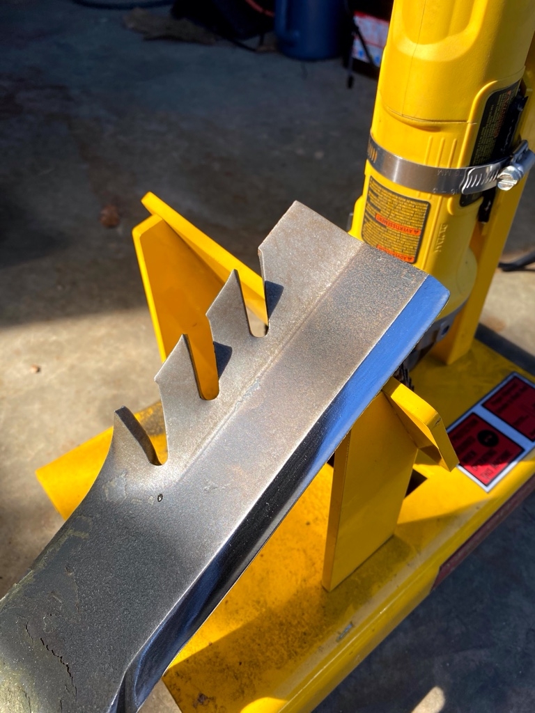

I use a jig to get a consistent edge using a 40 or 60g flap disk. Sharpening every 30-40 hours I can keep the tips square, and they get balanced each sharpening.

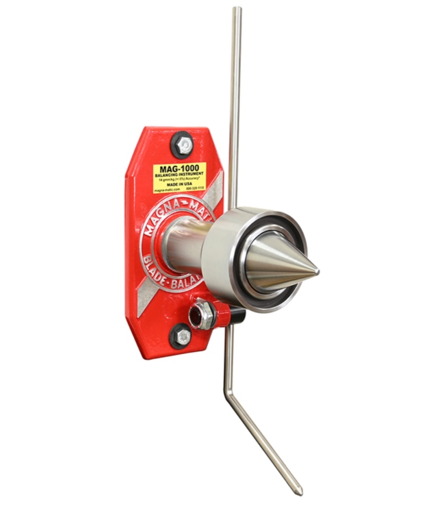

Mine are 6 years old and still sharpen fine. Get a cheap balancer. I’m not sure how long it takes to sharpen my blades, maybe an hour and a half, and that includes taking the deck off and on and cleaning it a little.
Nice jig. I b et that cost more than a couple sets of replacement blades. Around here, it's not the ends of the blades (cutting edges that get ate up) but the heel of the blade that gets worn away from the sandy soil and I can eat up a set of mulcher blades in a couple weeks.

Maybe cost 2 sets of blades, but I generally get 600-700 hours out of a set of blades, so jig and balancer have more than paid for themselves.
