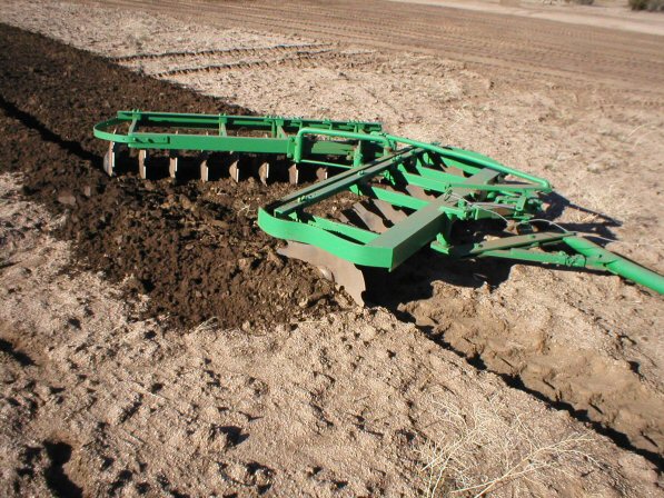

wolc123,is your disk similar to this one?
/ best disc harrow? #7
It is actually much closer to the MF model shown up there in Flushers post. I saw (2) just like it on some on-line site recently that were priced at $200 each. It is seven ft wide across the front sections and 8 ft across the back. Like that MF shown above, it is for secondary tillage and it works great on plowed ground. I cant believe how easy that old JD disk pulls. My little 20 hp Allis Chalmers C can handle it on plowed ground in 1st gear, and in second gear (4.5 mph) on subsequent passes at the most aggressive setting. You dont even know it is behind you with my new, 43 hp, 4wd JD. I would say it pulls twice as easy as my Ford 6.5 ft, 3 pt disc, and takes about half the passes to get the fields worked as well. I shudder to think of all the fuel I wasted the last 25 years with that 3 pt disk.
