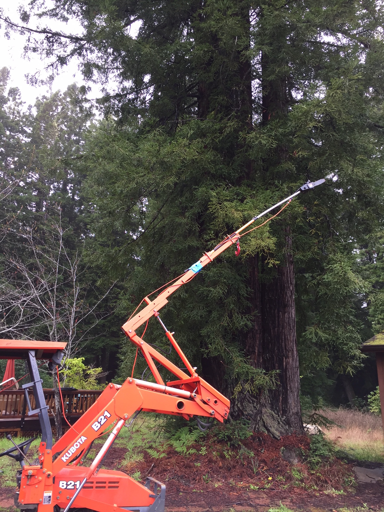

For reaching up high I put the old Remington on my FEL boom. Close to the buildings a long extension cord works fine. Otherwise I put the small Honda generator in the backhoe bucket. I hold down the trigger with a plastic tie and use a switch mounted on the ROPS to turn the saw on and off. Very easy to set up and take down.
