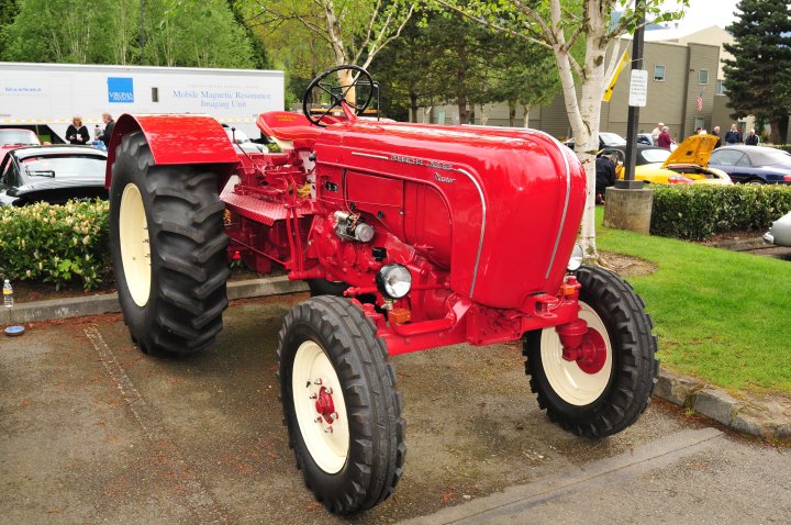

Porsche
   / Best engineering/technology in a tractor? Which manufacturers? #40
forgot to mention items of interest on this Porsche tractor.
air colled Diesel four cylinder Master
52 horse
6 speed
hydraulic torque transmission
1959
one of 400 this model
3 point
multiple pto's
differential lock
adjustable track
pendulant front axle
widest speed range 0.8 to 16 mph
,Porsche imported around 1000 tractors to the USA in the late 50's 300 of which went to Canada,
Importer was Porsche Diesel North america in Easton Pennsylvania.
Manufacture of these tractors ceased in 1962 @ the Mannesman manufacturing site in Friedkshaffen Germany @ the old Zepplin factory
Four models were produced
1 cylinder Junior
2 cylinder Standard
3 cylinder Super
4 cylinder Master
I curently own one of each model
Carnation, Washington
