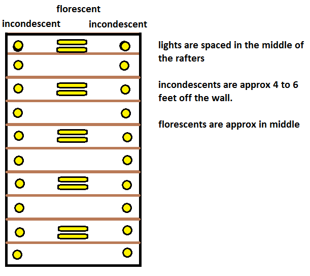

*rubs chin*
to be honest. i end up 50% of the time near walls of the shed. either to store stuff or to work on something. while florescent lights are good. i have opted for regular metal box light fixtures with incandescent bulb plats that go right over the top of the metal eletrical box.
i will end up having 3 switches. one switch to control one side of lights down the wall. another switch for the other side going down the wall. then another switch for some middle lights.
while the electrical metal boxes and incandescent, i could of used florescent lights. but i tend to go into the shed. and grab something off of a shelf. say load up some tools in a couple 5 gallon bucket. then i am done ready to turn off lights and lock things up again. and weighting for florescent lights to be bright enough to see clearly was not an option.
i also find myself in situations. working up near the walls. say storing some lumber, or cleaning up push mower, wead eater, perhaps greasing something, or perhaps measuring some old lumber lengths to see if it will fit the job i had in mind. and in that shadows are a big thing for me. and not having to drag out some sort of corded clip on light or light on a stand to see what i am doing.
which brings me to looking at the 4 bulb or even 2 bulb florescent light fixtures. there just to much light concentration in a single spot. i prefer to have my lights spread out so i can get better usage out of the lights and help to remove shadows. regardless in what direction i am facing or getting myself into.
a single tube florescent light for me does a better job placed end to end to the next one. vs having 2 bulbs directly behind me and casting a large shadow on what i am trying to work on. granted for the central lights (see diagram). i have double bulbs. but for me these lights are clear up in the peak of the building. and i can get just enough clearance for light to get past rafters for aerial lighting.
