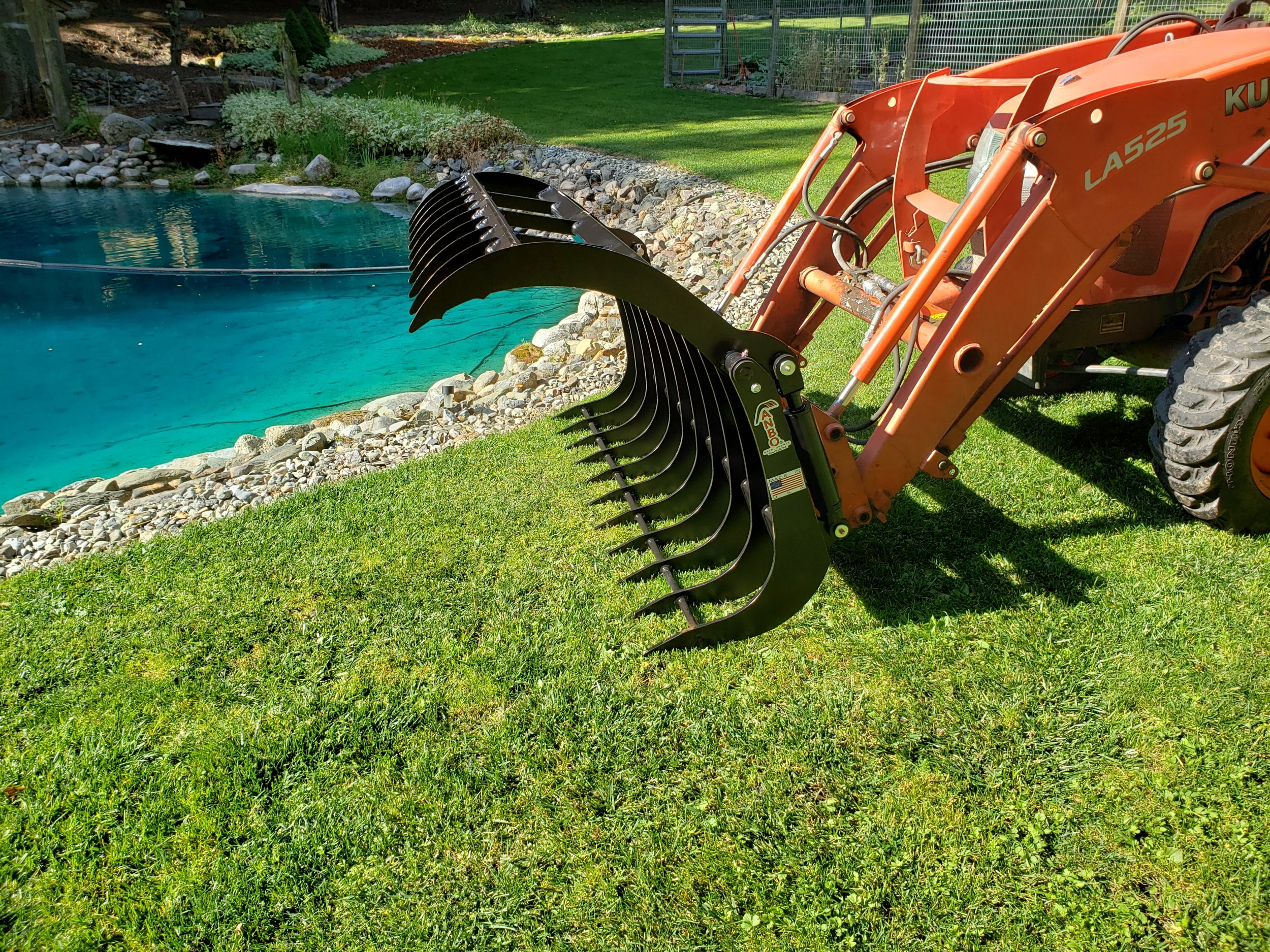

I use my GR30-HC-6" Anbo Grapple for everything, this one is very operator friendly. You can really clean up fast without gouging the surface or you can get real aggressive and can handle everything you give it. Just a bit of caution, if your working with a lot of branches, steer away from grapple rakes with jagged surface on the rake side of the grapple rake, the smaller branches and weeds seen to hold up in the rake and you have to shake it sometimes to dislodge them.
View attachment 694391View attachment 694393
I really like the style of that. With a little bit of a shelf to the lower tines.
where did you get it from?

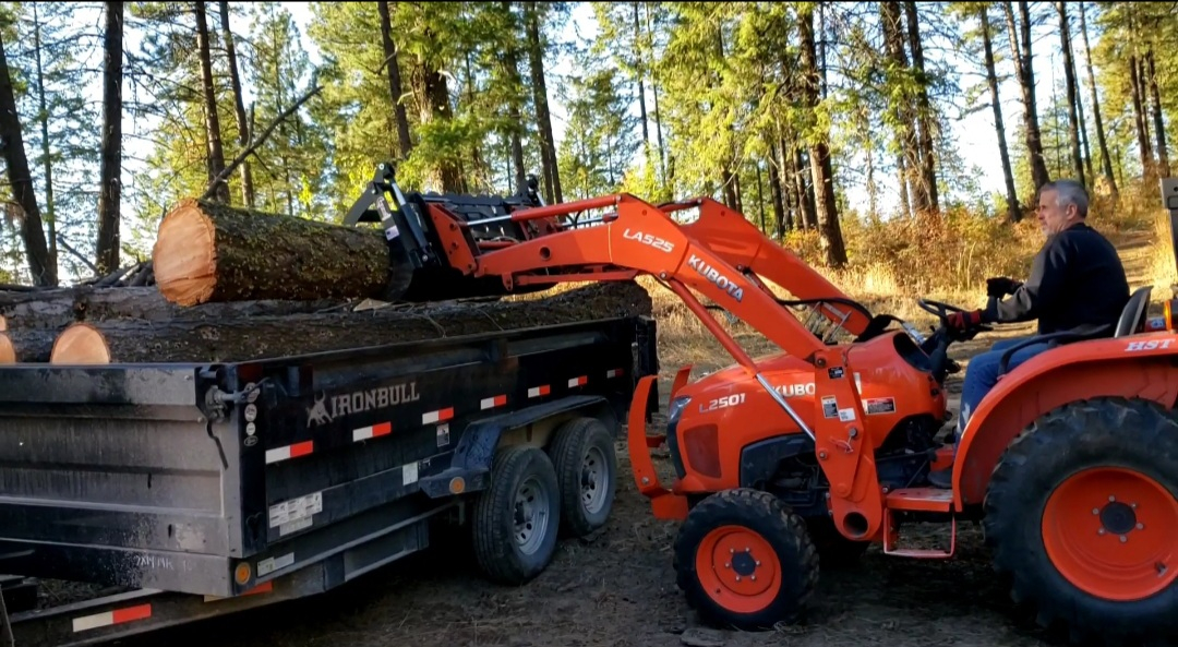

I have a lot of brush piles and down trees I’ll want to move. I can get two styles of grapples I’m wondering which one y’all would recommend.
Here is a photo of an example brush pile and the two styles of grapple.
I have the Landpride SCG1072, which resembles the second photo (grapple on tractor). I use it for all kinds of brush and tree cleanup, and while I don't know if I'd truly be happer with the grapple of the left Steinsammler (?) grapple, I've often though a grapple with longer bottom tines would make me happier. Closer and longer bottom tines might drop less material between point of pickup and the brush pile destination.
That said, I'm not unhappy with my grapple and I'm still learning various techniques. One thing I could probably do better with mine (like your right hand photo) do an equal sided drop-from-above claw-like grab on the brush. But mostly I prefer to slide the tines along the ground to get the bottom material, and I would guess the Steinsammler is better at that . My landpride bottom tines are barely tines. For example, you can't really put anything on them (to carry) even with the grapple open and tilted, stuff just slides off because they're very curved. So what isn't secured by closing the grapple is lost. There are times I wouldn't mind being able to carry my chainsaw in the grapple, but no such luck.

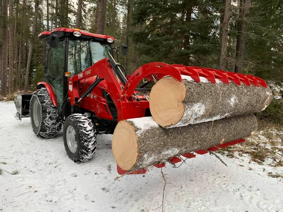

Some more pics of things I’d pick up
Now for that second set of photos that are more large trees, there's where the ability of my landpride curved grapple to act like a claw in the arcade game probably works better. I can't see the Steinsammler being quite as flexible with large tree carries. Having said that, I probably still try to scoop more from the bottom. Ultimately I'm just trying to pick the darn things up without damaging my grass or whatever else they fell on.

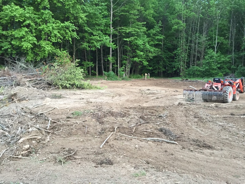

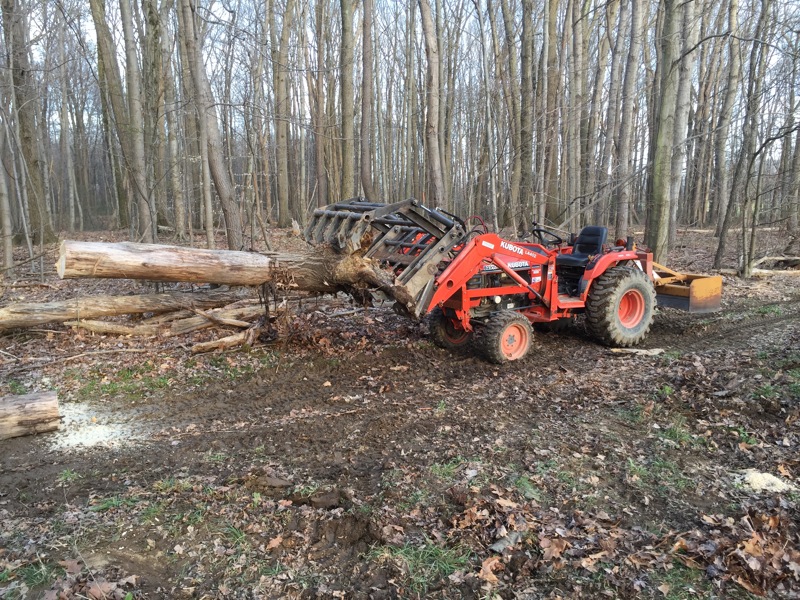

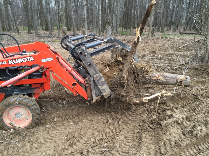

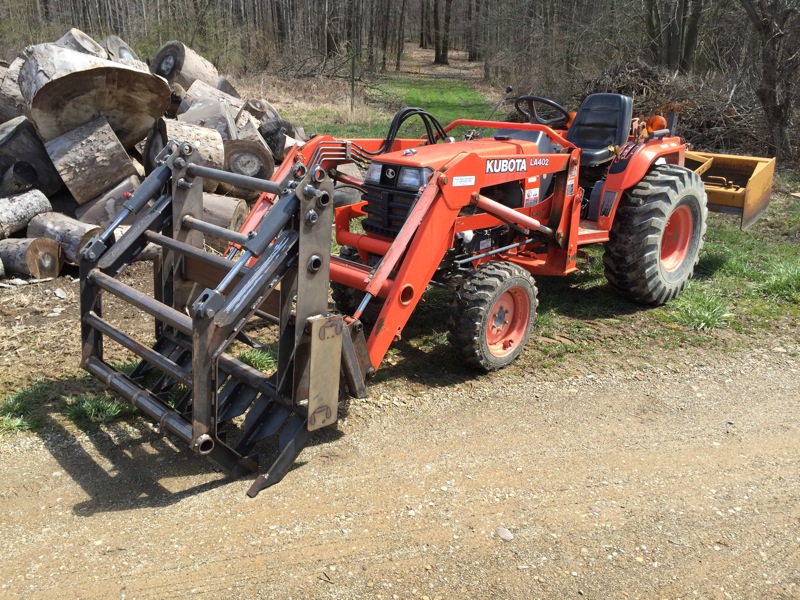

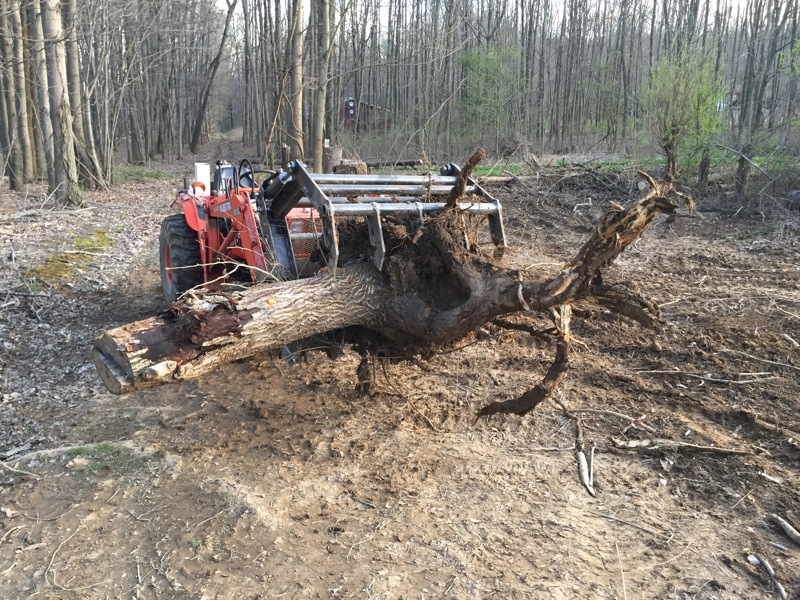

This is the one I built, modeled on a WR Long product:
img_0074-jpg.464021
img_0498-jpg.471969

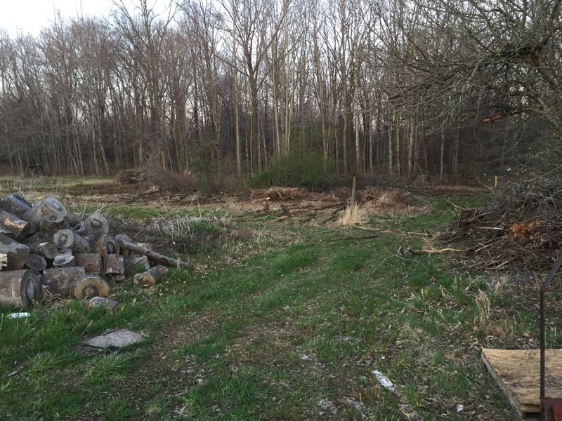

Used it to clear out this area towards the back of the picture that was being invaded by aspens:
img_0167-jpg.465129
img_0402-jpg.469883
Kind of surprising what you can dig and root out with a grapple and a FEL on a CUT ... assuming the right technique of course:
img_0183-jpg.465333
img_0271-jpg.465847
img_0260-jpg.465594
Area in the back of the image is after it was finished being cleared and graded out:
img_0506-jpg.472383
