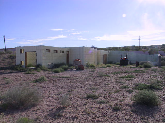

RAT, I too am planning on using ICFs. I bought a property about a year and a half ago in which the original owner had started to build the home with ICFs. He had gotten the lower floor, which is a half basement, up and he ran into some financial problems so he had to sell the property. He also had PEX radiant heat lines put into the half basement slab and I would like to extend that heating system into the upper floor. I'm planning on using solar for heating and domestic hot water by means of using a heat exchanger to transfer hot glycol to heat the domestic hot water and radiant hot water system. From what I can gather I should be able to supply close to 90% of my hot water and heating needs from solar in my part of the country. I was wondering if you had any comparable R values for ICFs ? Right now I'm only planning on using the ICFs for the lower level of the home which is half built into a hill with a southern exposure and using conventional 2X6 stick frame construction for the upper level . I have not been able to identify the manufacturer of the ICFs used in the basement. Also, does anyone know of any sources for solar heating equipment and can anyone identify the band make of these ICFs so I can get some specs for them?
Stonefox

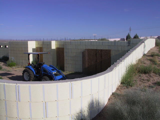

another picture

"I bought a property about a year and a half ago in which the original owner had started to build the home with ICFs. He had gotten the lower floor ..."
I'd say his loss was your gain. It looks to be an interesting design. Best of luck with it. (and nice tractor)
   / best heating system #38
Wow Richard. It looks like it's been poured. Did you get the set of plans as well? Any ideas on external finishes? Is that ARXX (Blue Maxx) ICF. ICF should be ideal in hot climates. I also have some ideas on some super lighting systems if you are interested. A bit pricey, but very nice and a real asset for ICF. I know much of New Mexico uses 3 coat plaster on the interior, is that your plan? I also have a superb plasterer from Santa Fe. He's done jobs for us bringing his whole crew to California. Best wishes with your project. It will be nice to have the tractor around during construction. Keep us posted. Mark...
