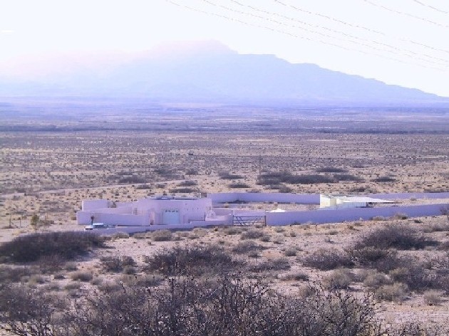

RAT, Yes, I also got a set of plans but I plan on making many floorplan changes to the upper level. I will be down sizing the total square footage from over 4000 sqft to about 2700 sqft just to make it affordable. The guy had grand plans for this place that I will not be able to meet. Yes, we typically will use a 3 coat plaster to cover exterior walls on adobe and other surfaces and will be using that coating here as well. One other use for the ICFs that I hadn't thought about before buying this place is he used these forms for building a 6' wall enclosing an acre around the house. Considering the lengths of continous wall there are only two or three small cracks in all the wall unlike alot of concrete block walls I've seen. Seems like an expensive wall to me but his loss is my gain. Sure, I'd be interested in hearing about the lighting system you mentioned. Feel free to PM me. My wife and I are currently living in a 800sqft care takers/in laws cottage that is completed on the property. But I am starting to feel pressured to get this home completed in the next few years since we are expecting our first child this November.

We are in a similar situation. We bought a place with no house, well, a old beat up mobile home that leaks, weeps and responds to the outside temperature within mere minutes. It is 900 square feet. We have a 3 year old. I'll PM you the address of the lighting company I've used in the past. What will the interior walls be finished in? Drywall or plaster?

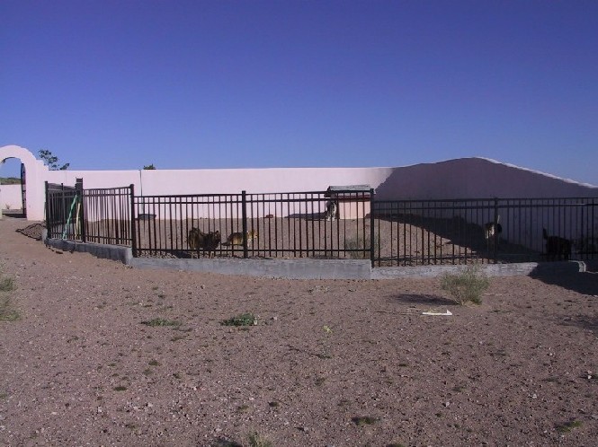

Rat, I haven't decided on a interior finish yet but I am leaning towards drywall since it will go up faster and leave a smoother finish, if I do it myself. I assume that you have to wire the interior walls also for the plaster to stick to the ICFs. I did notice that the plastic bracing in the ICFs do hold staples fairly well for attaching stucco wire so I assume you could just drive drywall screws in for holding up the drywall. I have been playing around a bit with the extra forms I have for putting in a dog fence/pen.
