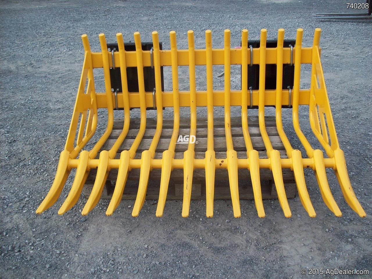

While browsing Kijiji, the Northern version of Craigslist, there is a Stone Fork, which replaces the loader bucket, but looks like it may suit the build. I would think that a narrower one would be better suited for smaller tractors due to the lesser capacities required to dig and lift. Similar to what Jeff suggested, but more dedicated to rocks of all shapes and sizes.
/ Best implement for de-rocking? #18
That would be awesome for medium sized rook removal. Would love to have that thing. Put some grapple arms on top and it would be useful for so many things.

I am just a few miles from you and yes the rocks here seem to multiply faster than rabbits. OMG. I think running the sub soiler through your lot about 8-12 inches deep then going sifting through the soil with that yellow stone fork may just do the job. You may have to make a few cross passes. B.
