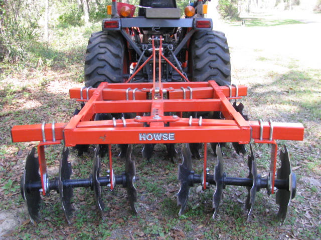

After a three week dry period rain was forecast for my area. I revised the order of my tasks to make seeding of Fall Deer Food Plots the top priority.
I had about an acre, in two sections, to prepare for seeding, which involved excavating Palmettos and dragging out vine roots. I excavated the Palmetto and vine nodes with a FEL Bucket Spade, then used my box-frame Howse Disc Harrow to cut the ground in two directions. Discing revealed deeper layers of Palmettos, wild climbing rose corms and additional grape vines. Removed deeper Palmettos with the Bucket Spade. Lengths of subsurface vines and rose corms were pulled out pretty well by the Landscape Rake. Then I rough graded the land with a Landscape Rake, seeded with Rackmaster/Pennington Deluxe Fall Deer Mixture and rolled in the seed with a Cultipacker. The rain just started as I finished with the Cultipacker. We had about 2-1/2" of precipitation overnight so the rolled seed should germinate in 3-4 days.
Once the grape vines emerge from the soil and commence to run up the trees, they swell and become woody fast.
In the ground they remain 3/4" - 1" in diameter and smooth. You can see how smooth the disinterred vines are in Photo #2 in Post #1. Some roots are sixty feet long.
In the process of secondary clearing of this small area I hauled maybe two tons of organic debris to the burn pile.
I have been pecking at this project for two years. If I can determine an easier or thorough way to do this work, I am prepared to buy an implement dedicated to vine removal.
I will be back to this thread in a few days. I need to remove a shank from my Rollover Box Blade, measure it and photograph it for this thread. In Post #1 is explained that the rippers are too blunt with the contact faces, too straight to pull easily. While I can pull just three rippers, I am still hoping someone will report a vender for Box Blade rippers that are parabolic shaped, like the rippers on the Hay King Chisel Plow and/or Fred Cain Field Cultivator. I think this would provide the best solution in terms of low cost and functionality.
In a few days I will mount the new-to-me Ford Series 101, 2-14" plow and give it a test at vine surfacing.
I appreciate everyone's input. Grateful for additional ideas.
