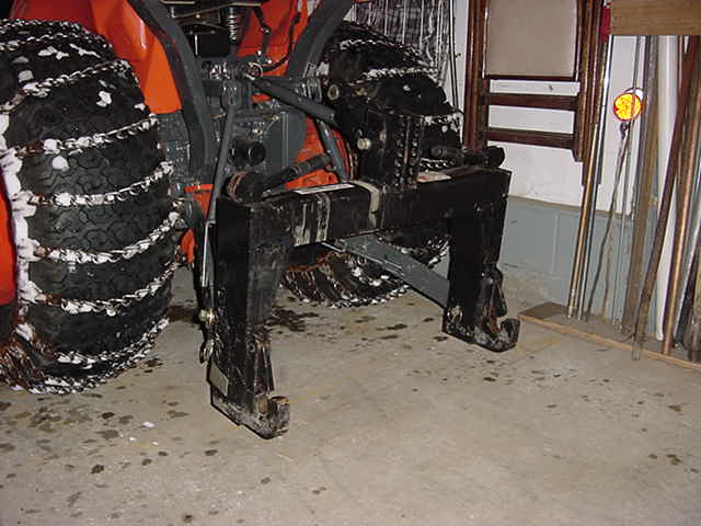

This is the best investment I've made since buying my tractor. Well my wife says that maybe its the best investment I've made since I bought her the engagement and wedding ring. I'm talking about the quick hitch I bought last summer. With all the snow we've had I've been putting on and taking off the rear blade quite a bit. Thank god for the quick hitch when I first bought my tractor it would take me a half an hour to get the blade on, now, it takes less than a minute. IMO these things should come standard with a tractor.

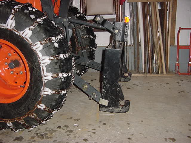

Take a look at this one. The top link and the hitch are 2 separate items.

So far the only thing that had to be modified was a tiller my budy has. I believe he posted the modification. John if you read this attach the short cut. Other than that it has been excellent I have yet to find another attachment that wont work. Jbcat even made a hitch that takes inserts for the reese hitch.
