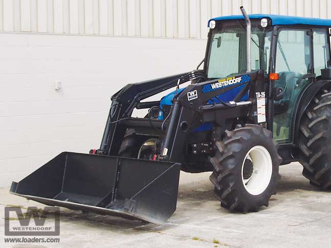

Westendorf TA-26 Series Loader
TA-26 loader - 3000 lb lift capacity at full height of 10'4"
TA-2612 - 3200# lift capcity at 12'

Your local Westendorf dealer will have the most accurate quote - however a quick ball park price for the entire package (loader, hoses, mounts, 72" bucket, snap-attach, power-mount (quick loader dismount- 1 minute without tools or stands), manifold and indicators) averages $5900 to $6500 depending on bucket ugrades or options you may want to add.
