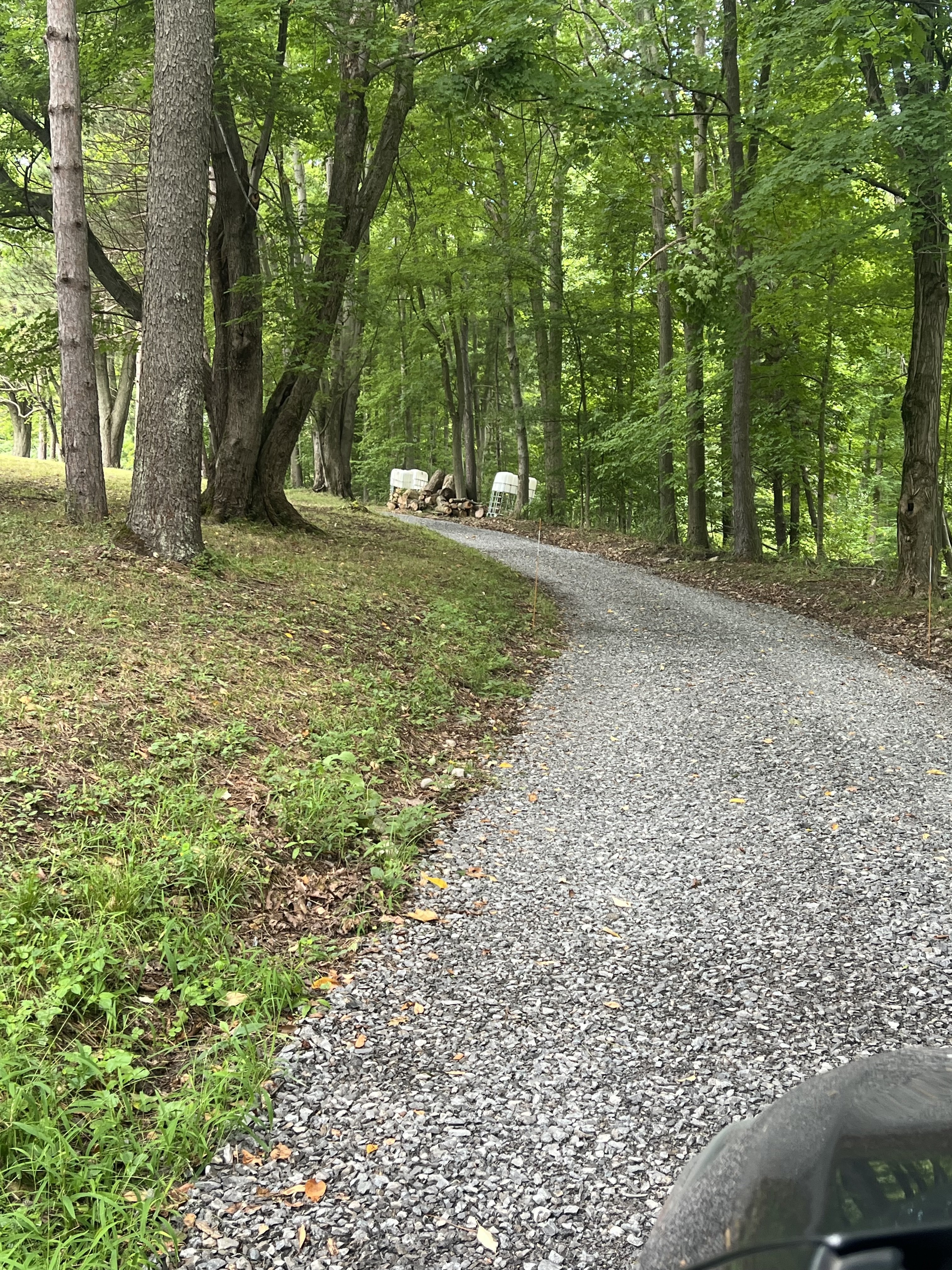

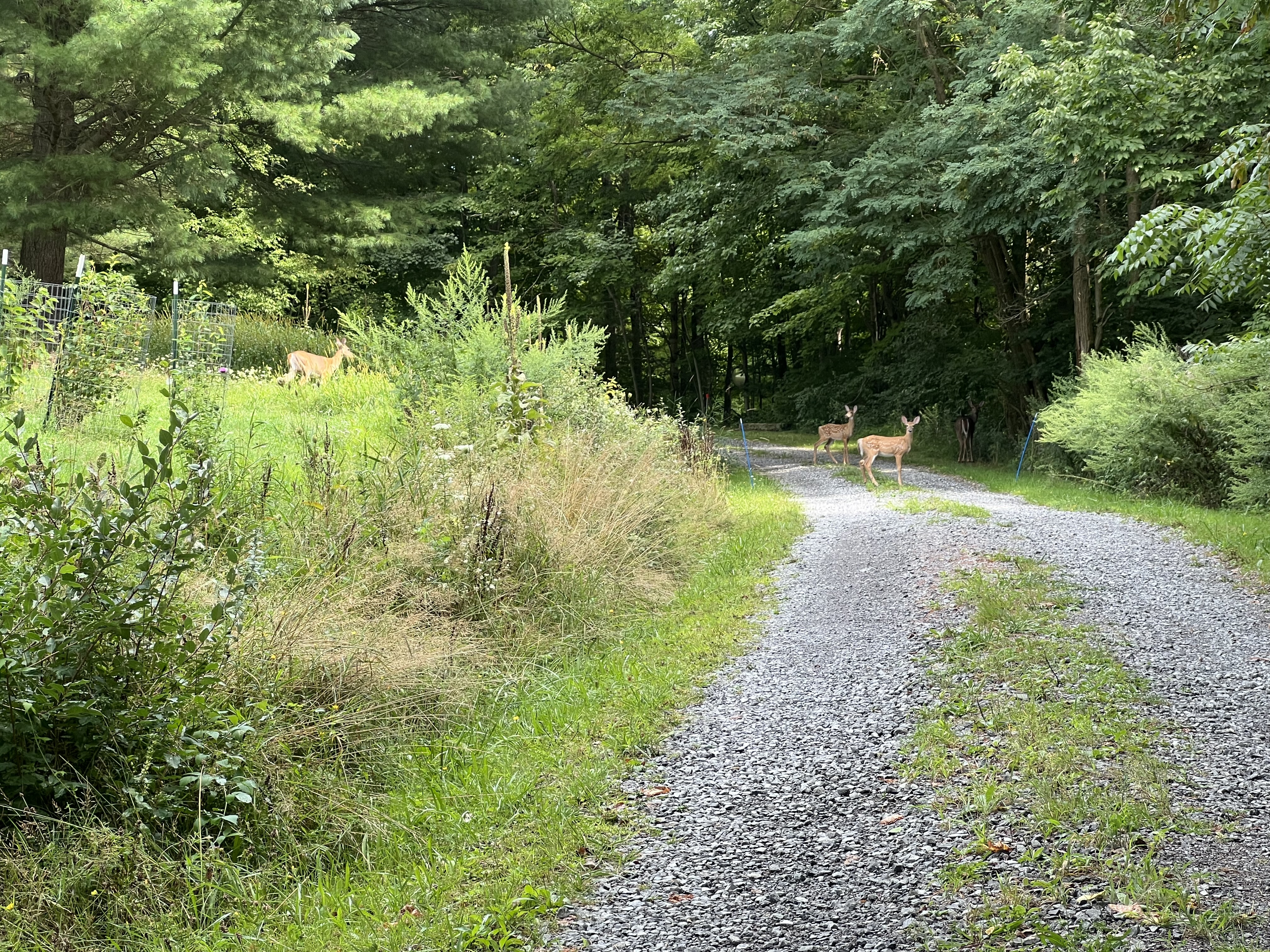

Pic below is up hill - slight grade. Water comes from left and from around the curve on the left side. no ditch around curve, just edge of driveway where it meets the bank. From where the deer are going back behind camera is a slight ditch that has grown in. (Next 2 pics )

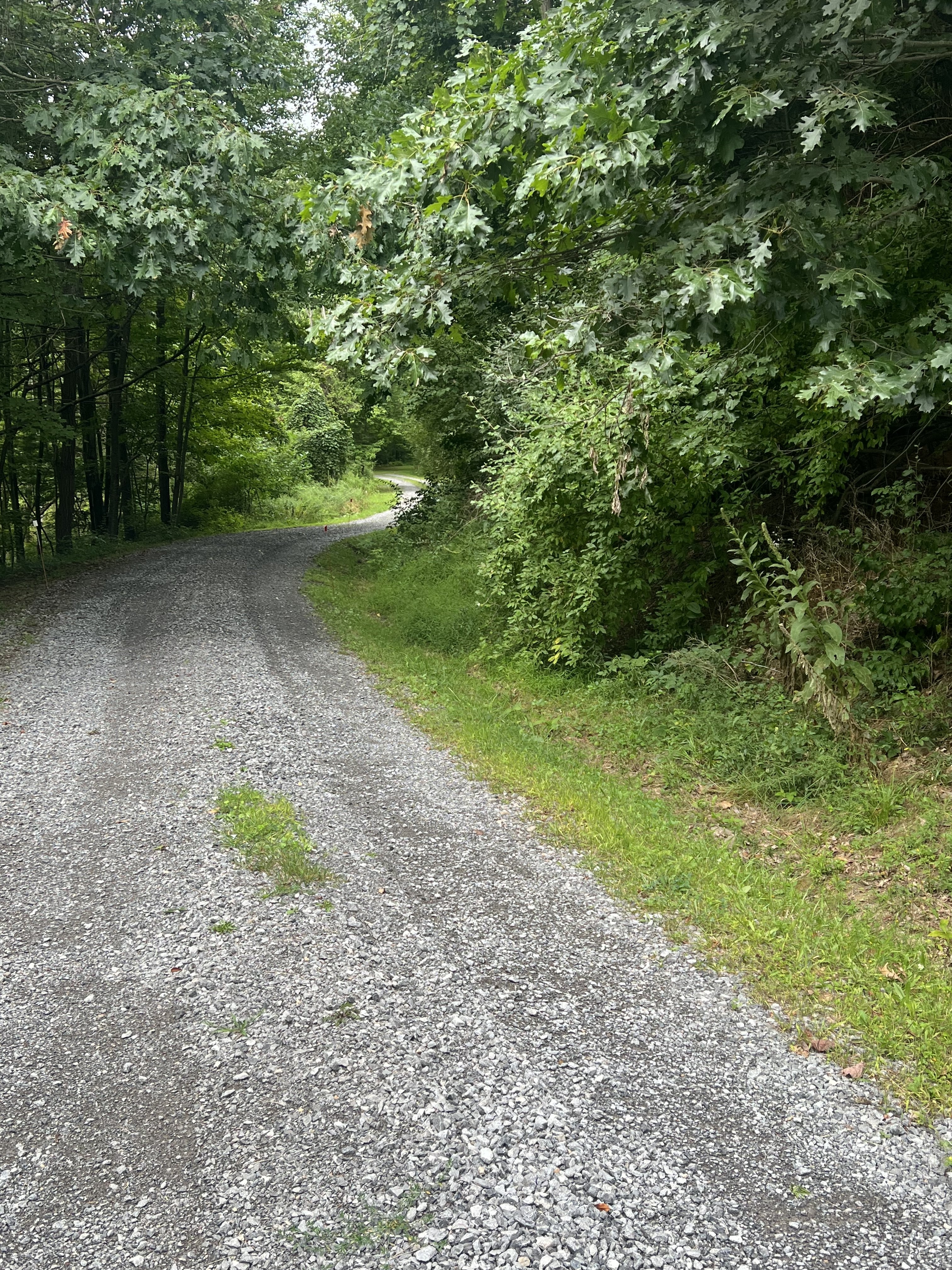

Below is going down hill. Elevation to the right. Ditch on right leads to culvert under drive to a ravine. It needs cleaned out. Gravel guys all say to crown the drive and let water wash to sides. I think pitching it to the left ( sharp downhill past the grass) to let all water flow off and down the hill might be better?
This is at the upper end past the curve (looking back to where the deer were). Not much of a ditch on left but crown lets water flow around the curve to the ditch. Again this is where I think it would be better to pitch the driveway to the left to just pull water over the road to minimize washout??

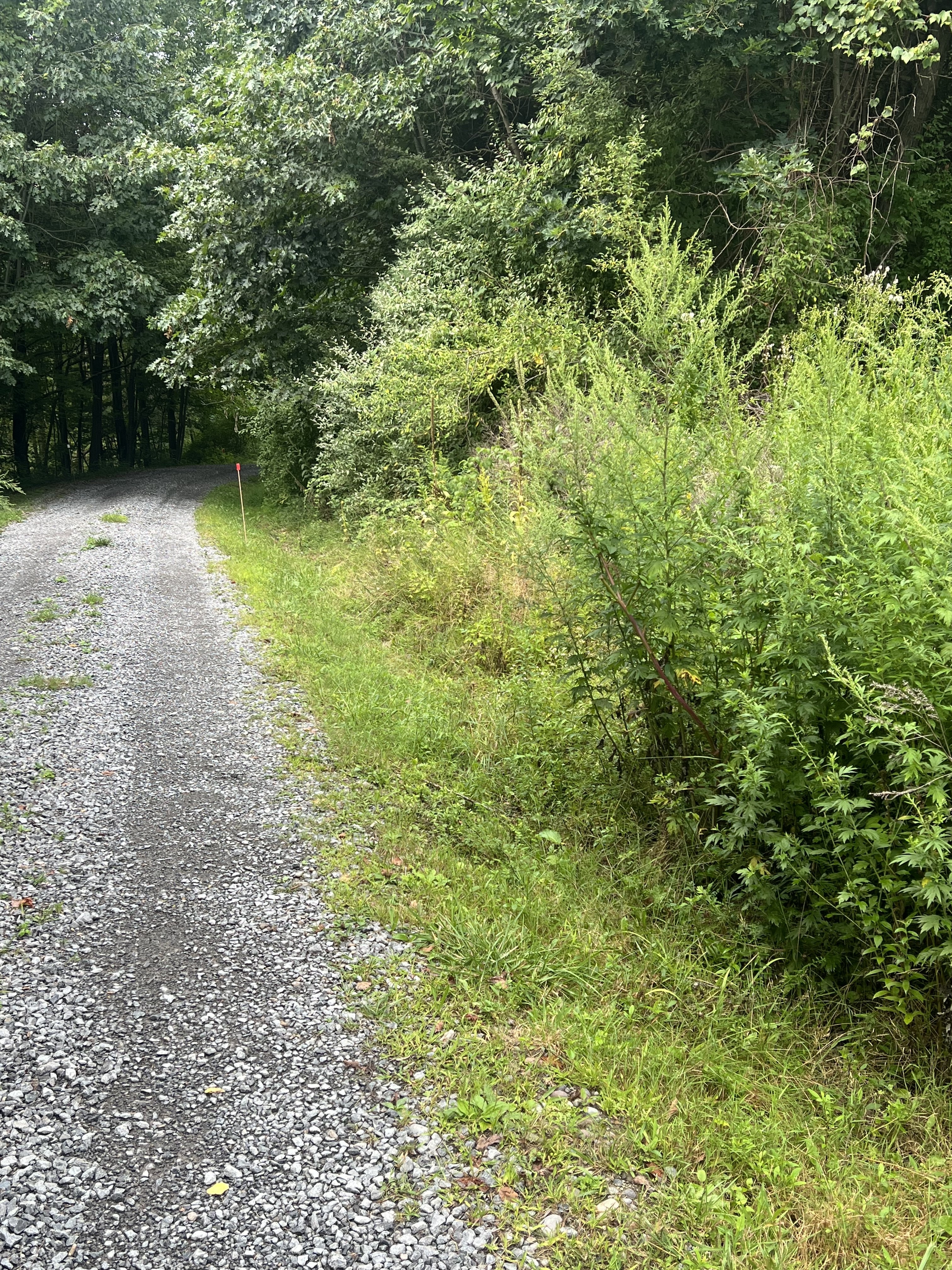

The drive is very threadbare - large stuff is just under the crusher run, so not sure how to pitch it ? Would I disturb the base or just add more bigger stuff to the left side and then cover with crusher run?
This is looking up hill at the top. same issues.
