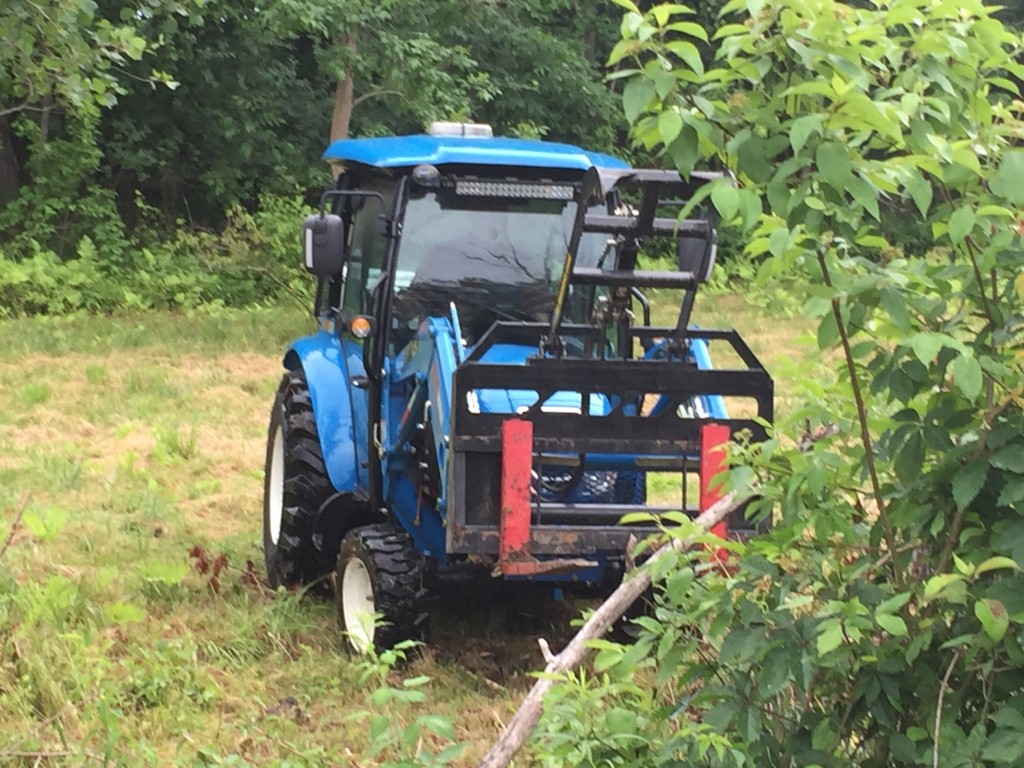

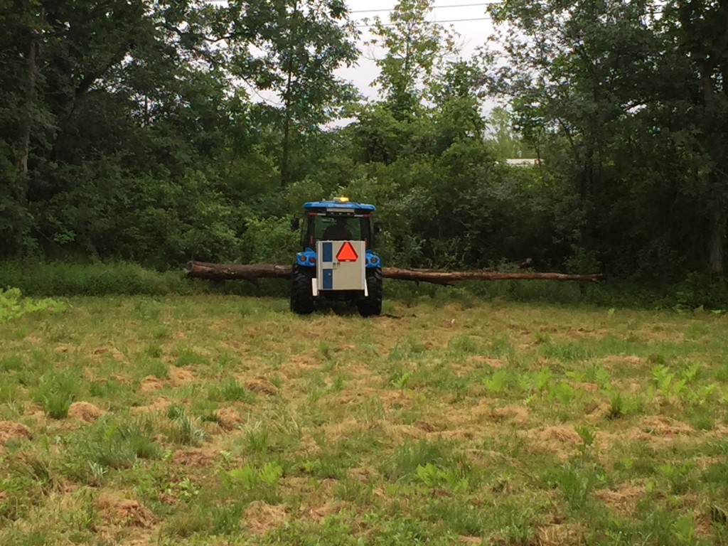

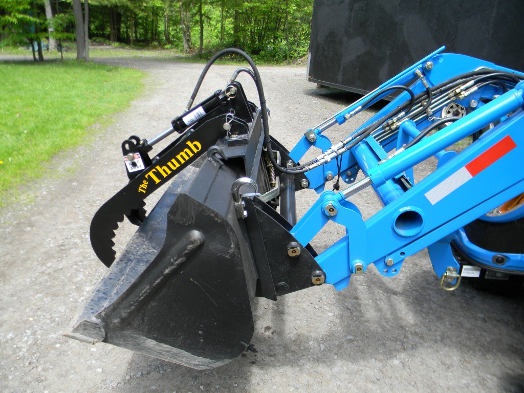

I use my forks with a hydraulic thumb to hold the tree. I can also use the thumb on the bucket. A lot of people would buy a grapple to use in place of the bucket. I don't do that much work needing a grapple so I bought a thumb for less than half the price and it works well for me. I had open field so was able to move trees this way. If in woods I'd have to use the 3 pt and chains to drag them out.

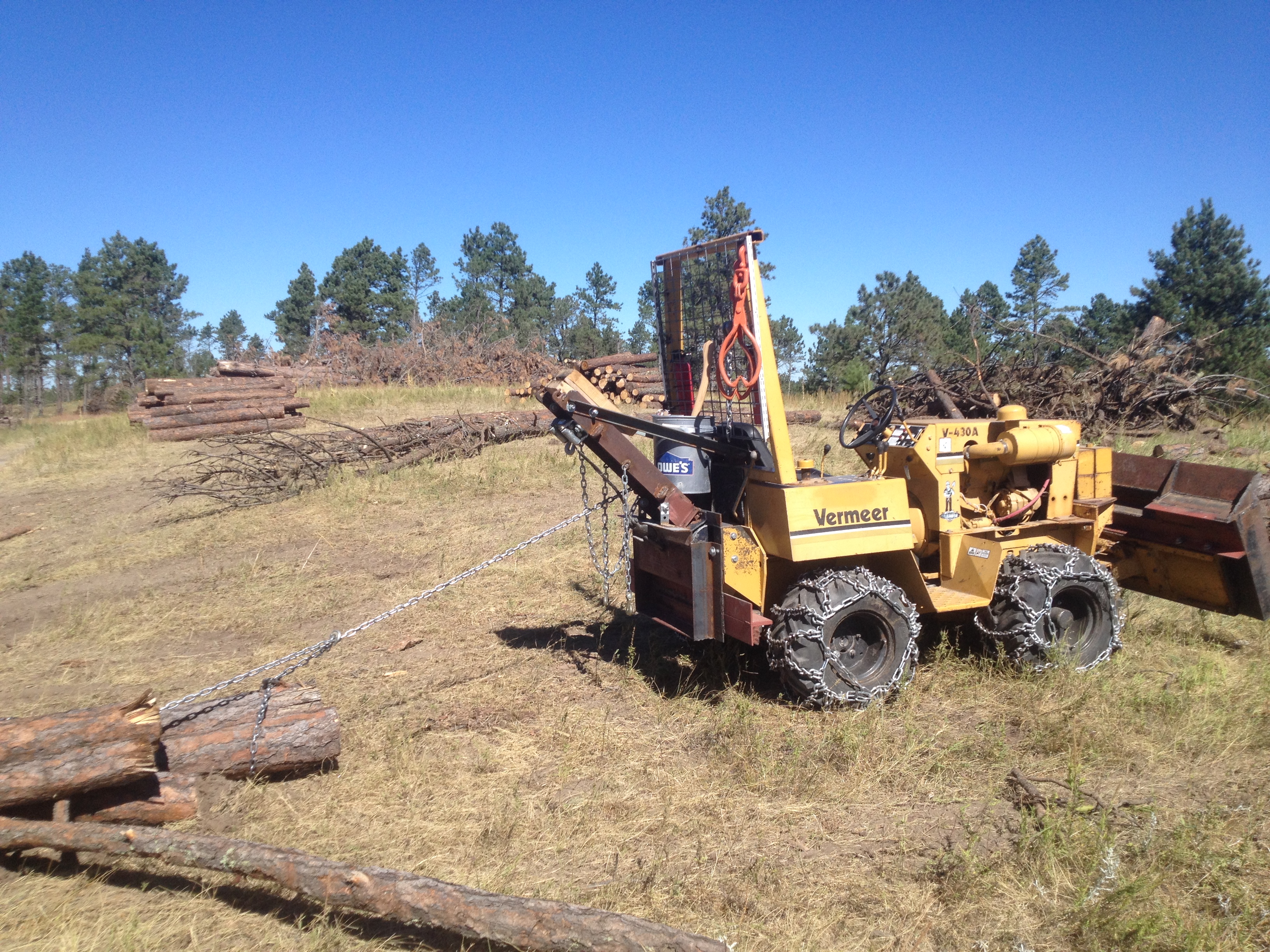

I had a similar dilemma and decided to repurpose a small trencher to pull logs. I was afraid of tearing up my tractors and decided it would be better to find something more suitable for that kind of work but I didn't want to buy a fill sized skidder. I added a winch, foamed the tires, added some protection, and added the heaviest set of chains I could get. I typically pull ponderosa pine that is 6" -12" at the base and would grab 2-4 per pull.

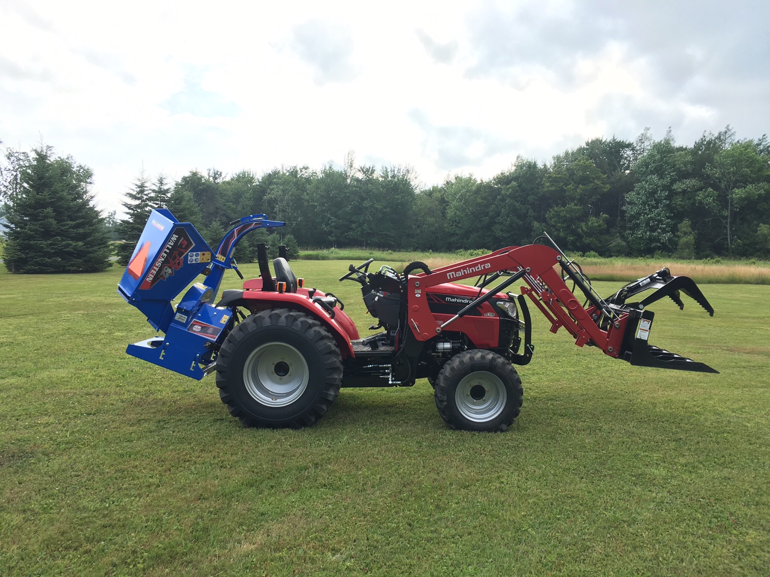

This is what we use. Its being replaced by a 2555 this week. The grapple bucket works great. Cleared over 55 White Pine and Pin Oak this week.
   / Best method for a tractor to move/haul/process downed logs? #8
You sure about that rig for 25+ ft logs that are 2+ ft in diameter?
You should send that to the Wallstein/Mahindra factory as it looks like a catalog photo shoot, really nice. Not a scratch on the entire rig. No way that thing has done any real work in the woods, oh wait. Did a falling top crash the roll bar and knock is off?

Trees rarely hit 2' in diameter around here, and when they do we use the skid steer. We do a lot of work that requires a light footprint. And yes, a top destroyed the rollbar, good thing the tractor wasn't in the way. We also keep our equipment very clean.
