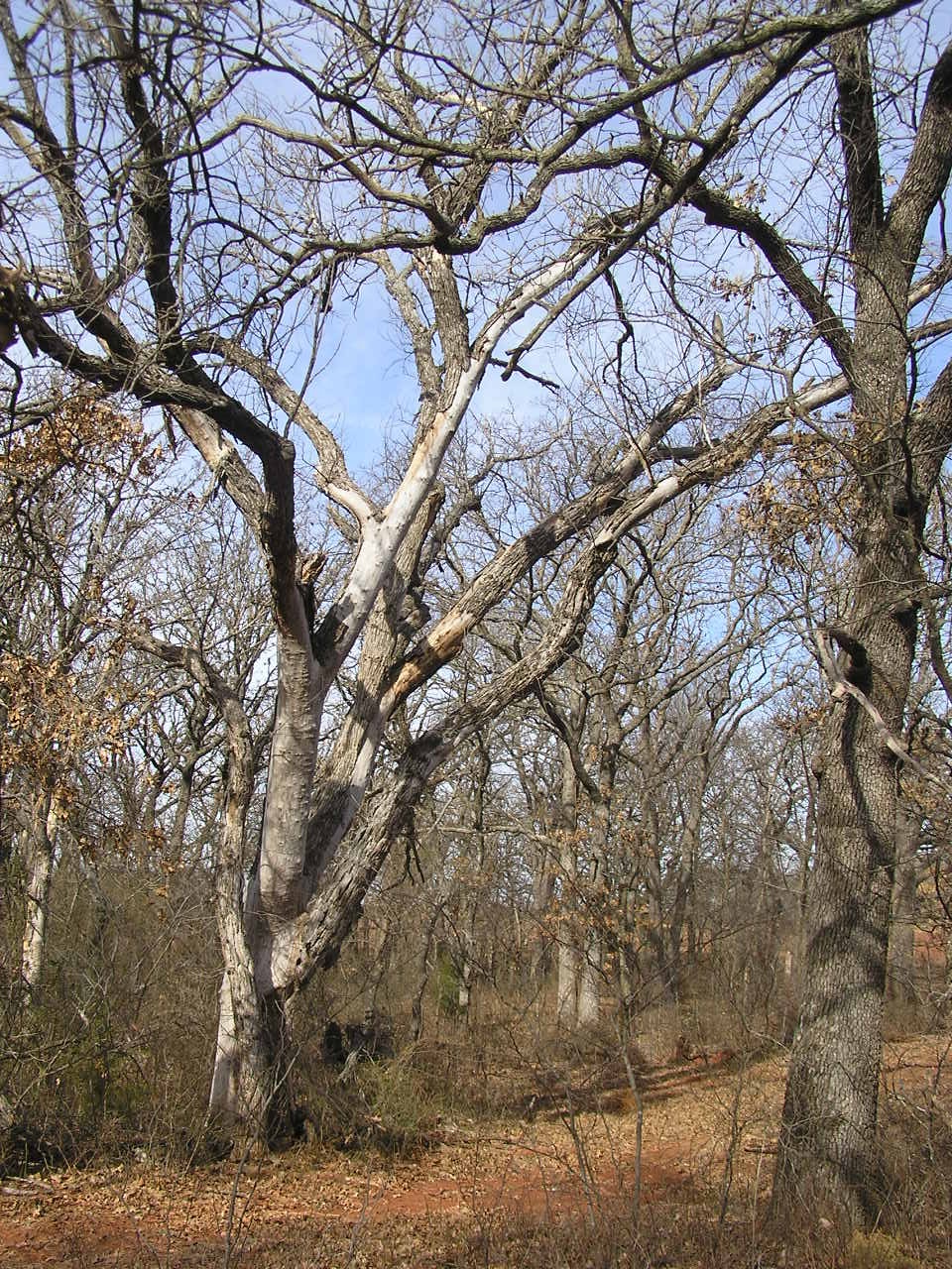

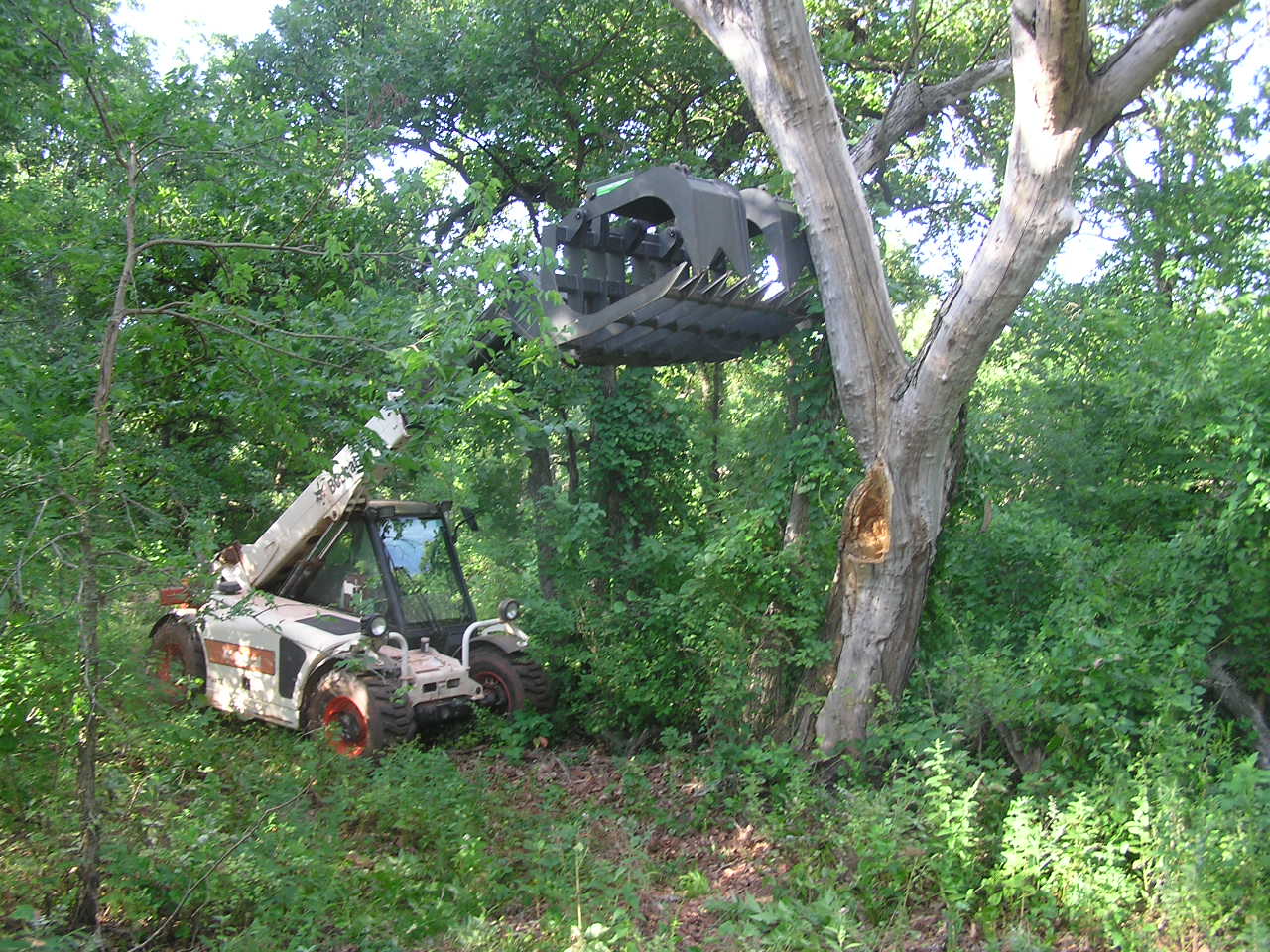

   / Best method for a tractor to move/haul/process downed logs? #44
Here's a small sample of what I was dealing with.
Maybe similar to Plowhog's, but hopefully no root balls?
The only way to realistically access any of this was to pull out one "stem" at a time. The only way to do that with a tractor is to take advantage of its TRACTION to pull, either with a choker and chain or a winch. Even so, no way the root balls from blown-down trees were going to be moved without being able to get to them to cut the "stem" loose first.
No way to get in and do any of that with a grapple. An excavator with a grapple to do it from over head, maybe. But not from tractor level.

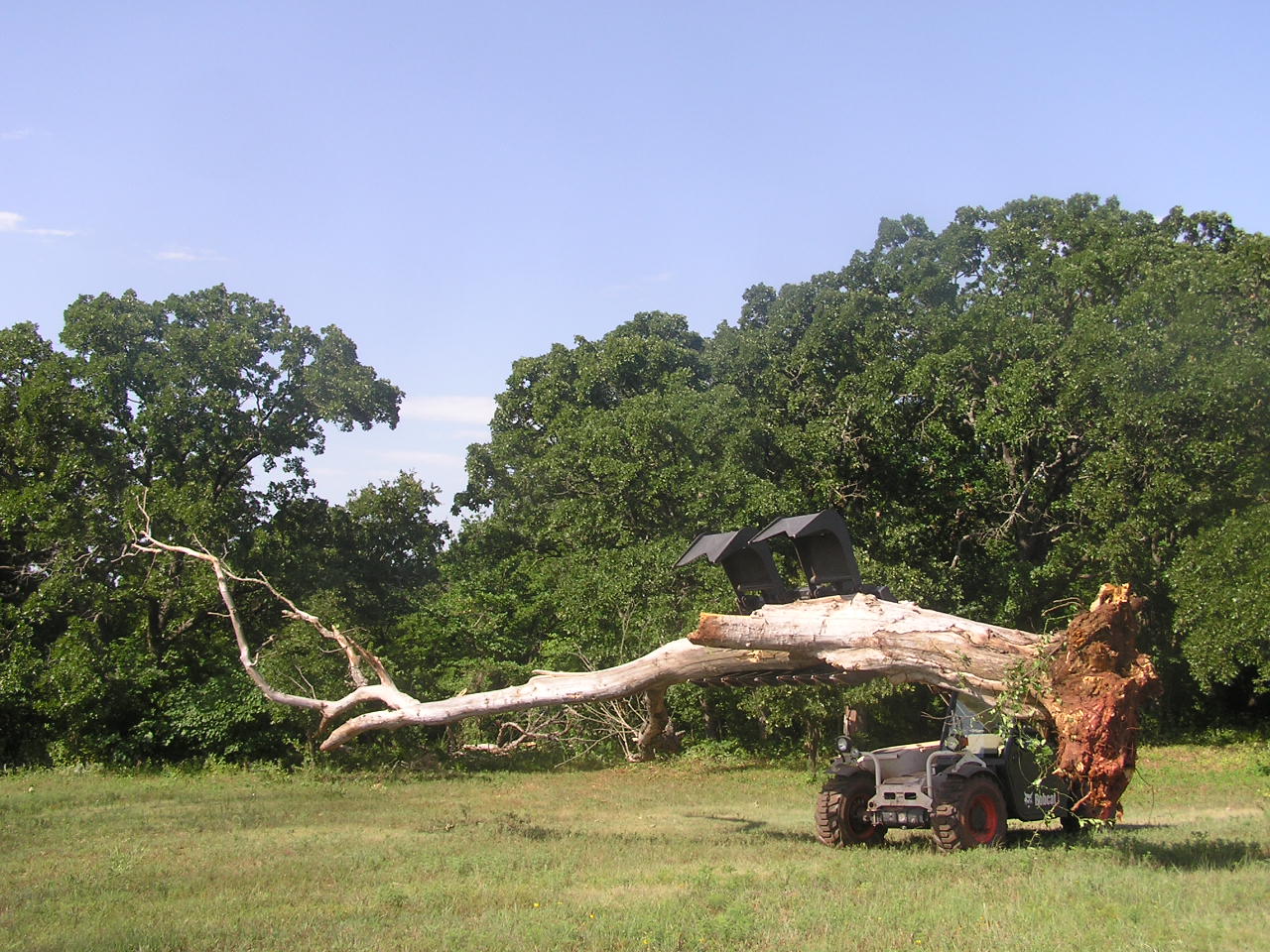

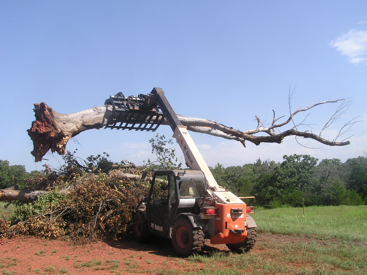

   / Best method for a tractor to move/haul/process downed logs? #51
This is what I used to move logs. These are white and red oak logs. The largest is 27 inch and around 9 foot. fresh cut and approximately 1 ton. I moved these from my woods in about 4 hours with a little Kubota B7100.

After using my B7100 a few times the wife found a tractor she wanted. A B6100 no loader but came with a rear blade, and a finish mower.
The contraption is my home made version of a log arch I guessed at a 'I'll never need it to be bigger' width. In the 1st pic the last log on the ground has the bark removed on the end. I had to narrow the width to use the arch to move it.

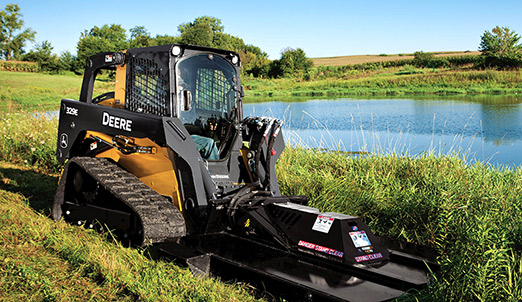

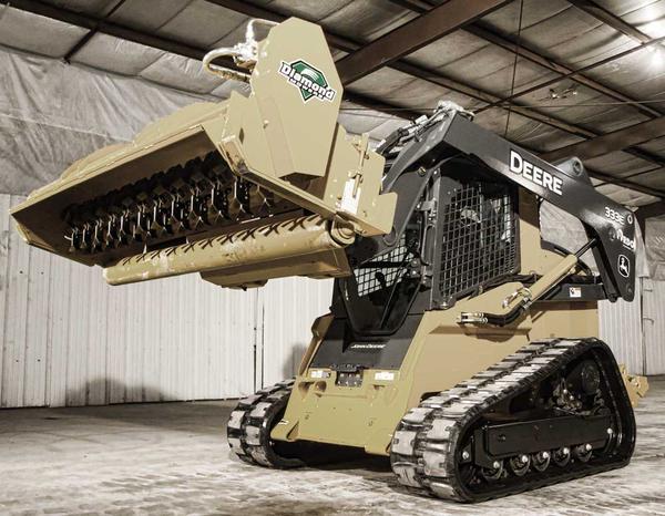

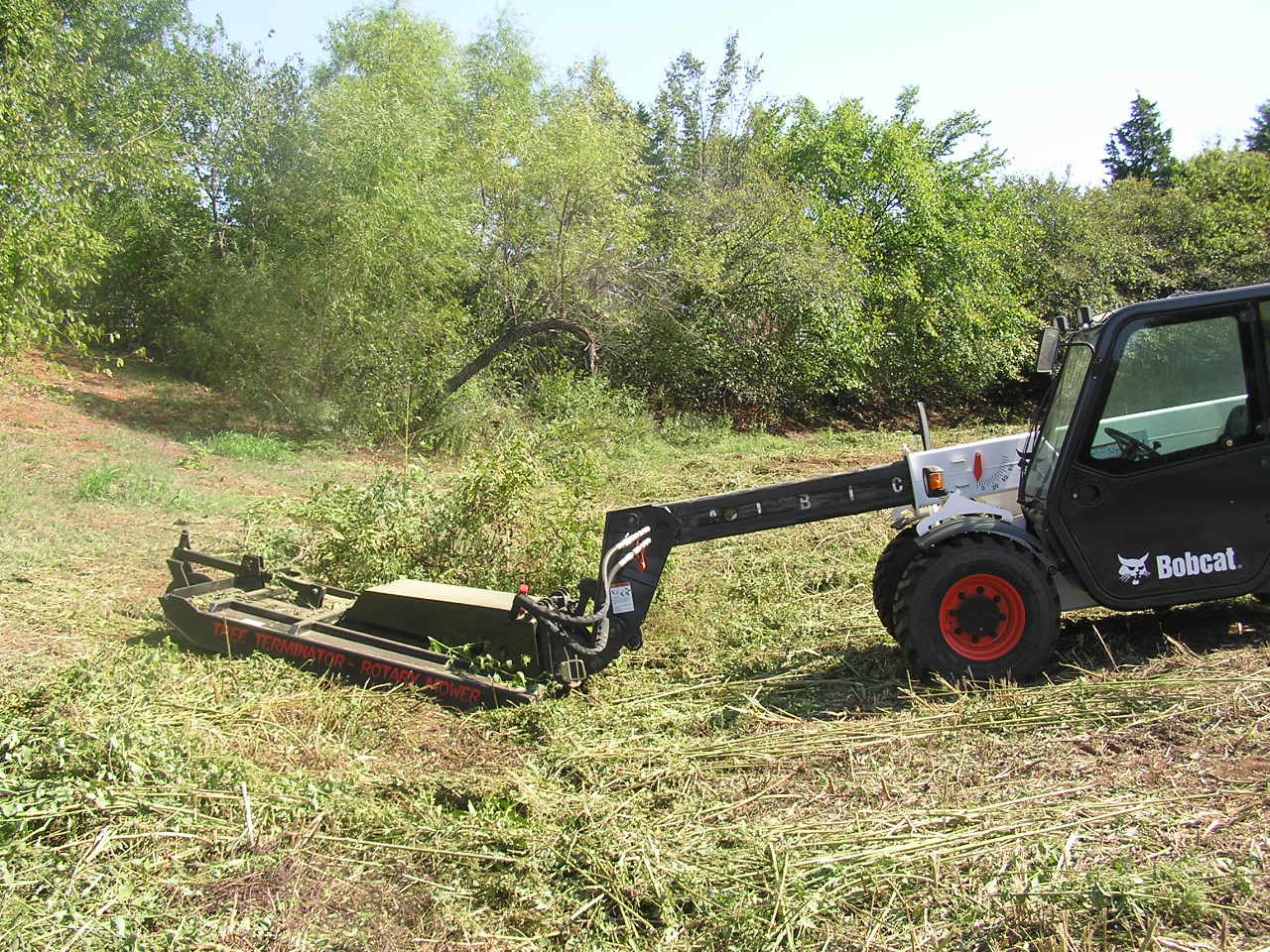

Just for information only, you can mow with a skid steer:
​Flail Mowers
I use a 7' brush hog on the V417:

LOL. There are ways to mow without a tractor.
Like I said you are entitled to your opinion based of your experience and so am I. YOU are the one trying to turn this into an argument so I am going to be the one to put an end to it and not even bother to write a lengthy response. Have a great day.
Id rather mow 20 acres of pasture on a tractor, and take my sweet time with it dealing with 8 acres of trees with said tractor
Than,
Buy a tracked skidloader and grapple for the 8 acres of trees, and try to maintain 20 acres of pasture with said skid loader.

I didn't say it was a good idea, just showing that it was possible.
I sold my tractor soon after I bought the first Compact Telehandler.
I would rather mow 20 acres of pasture with an out front mower on the V417, than on any tractor with a 3 point brush hog.
The V417 will go in the woods, where equivalent lifting capacity tractors won't fit.
