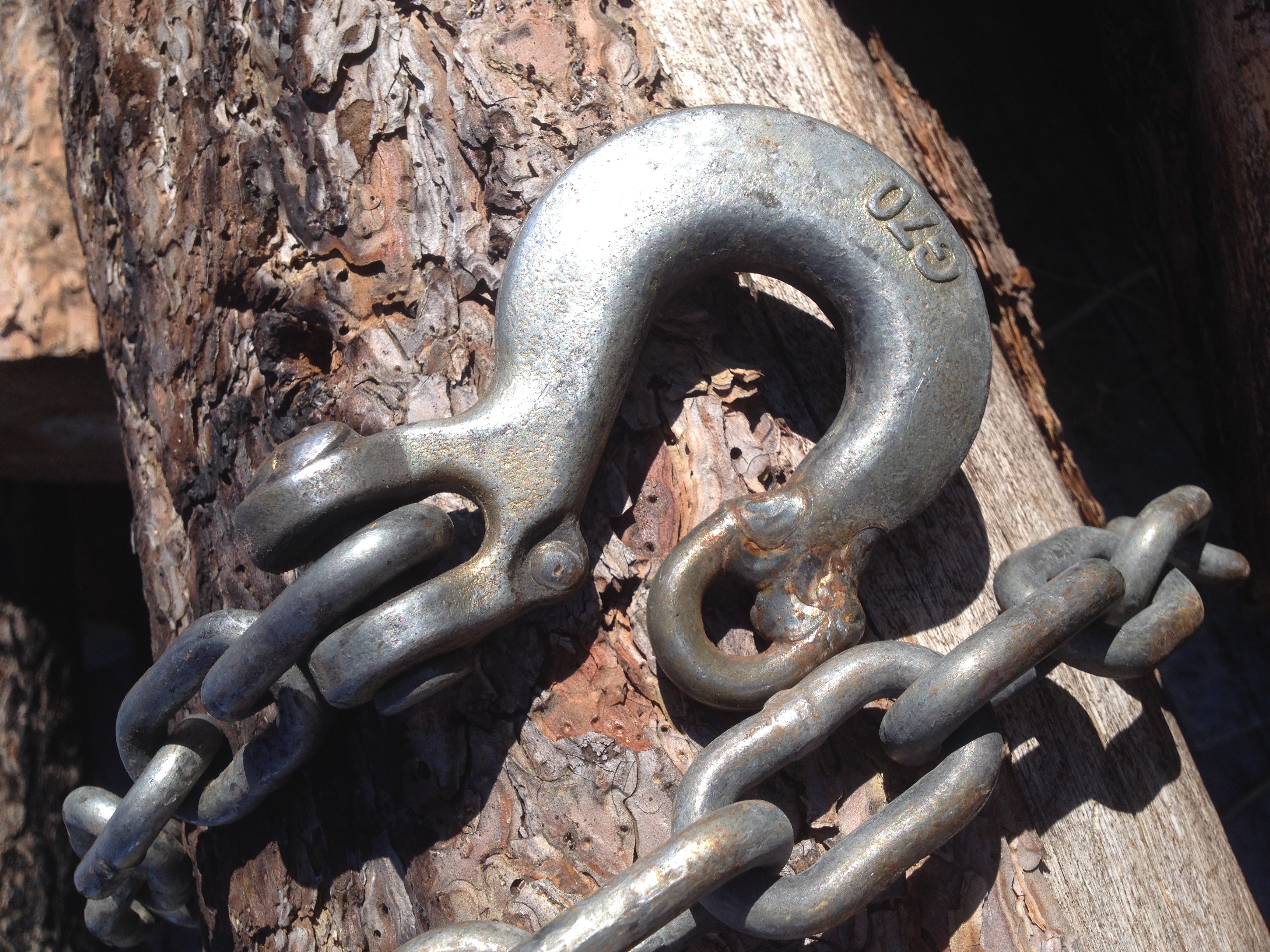

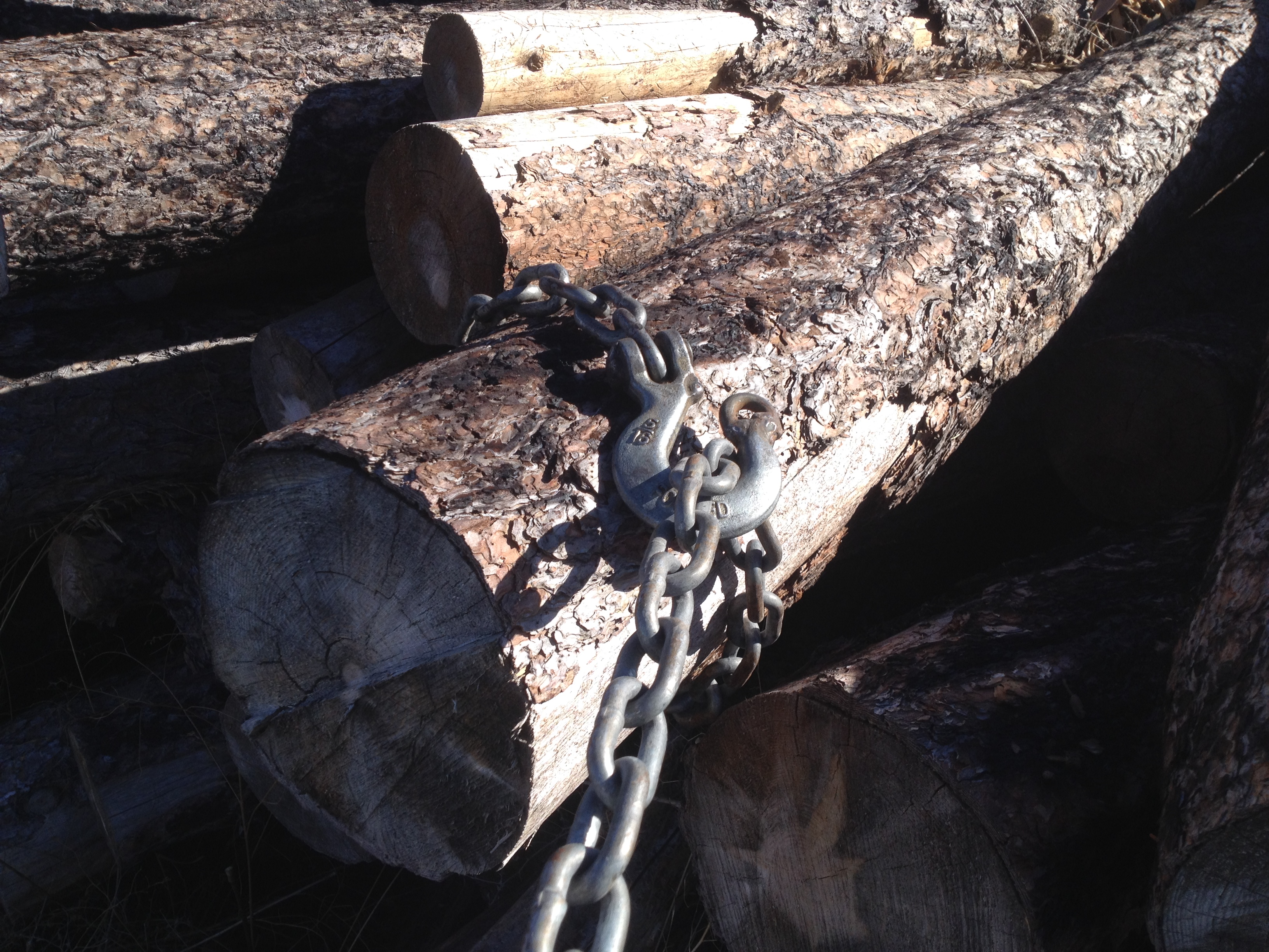

Here is what do for homemade chokers. A simple half link of chain works great to make the opening the right size where the chain fits through. I also weld the pins on both hooks.
I carry 6 of them on my little skidder along with a 20 ft chain. Then I simply attach the individual chokers along the chain as I drive through the woods and get my logs. I also have extra weld on chain hooks on my boom so I can winch a log in (or back right up to it) and attach its' choker right to the boom which is what I do on bigger stuff. .
Oh man, best idea I've seen all day. Thank you for posting that!!!!
I'd really like to find some rings to go in the end of chokers. About 4" in diameter, big enough to fit the chain through, strong like a hook, but won't come off. Haven't found any yet, though.
