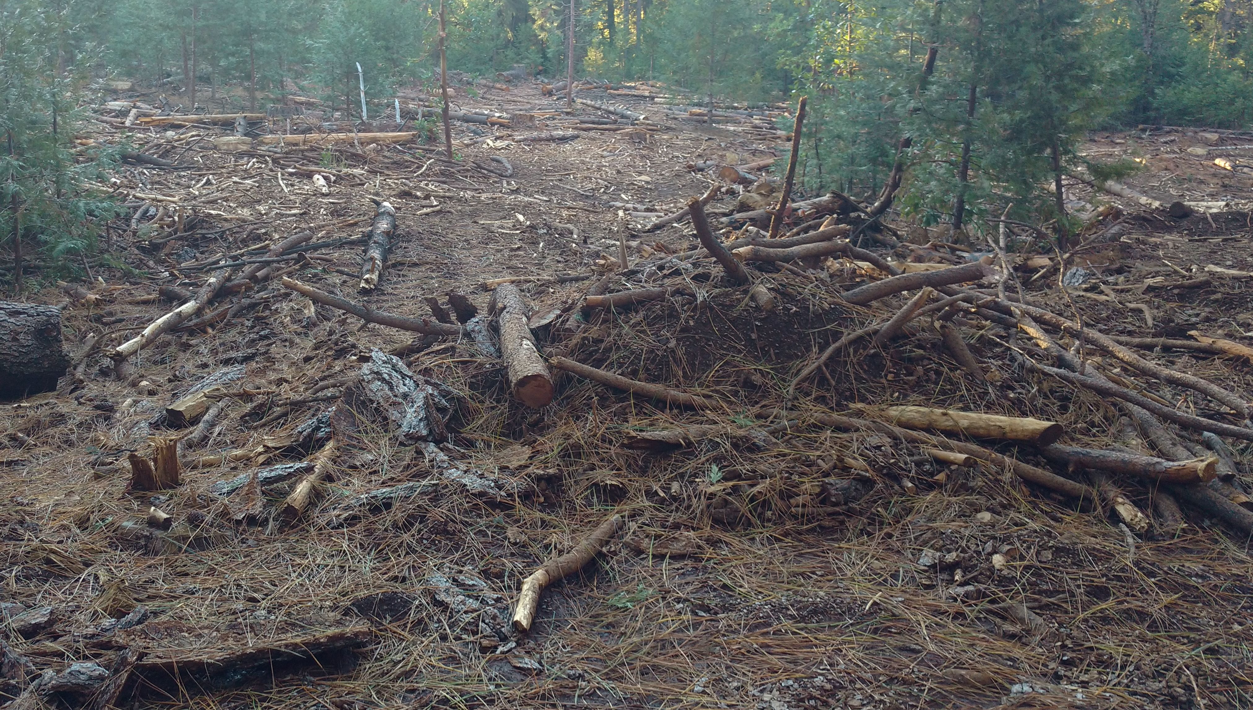

I snapped a couple of pics of the area I need to clean up. Hopefully my first picture attachments will come through OK.

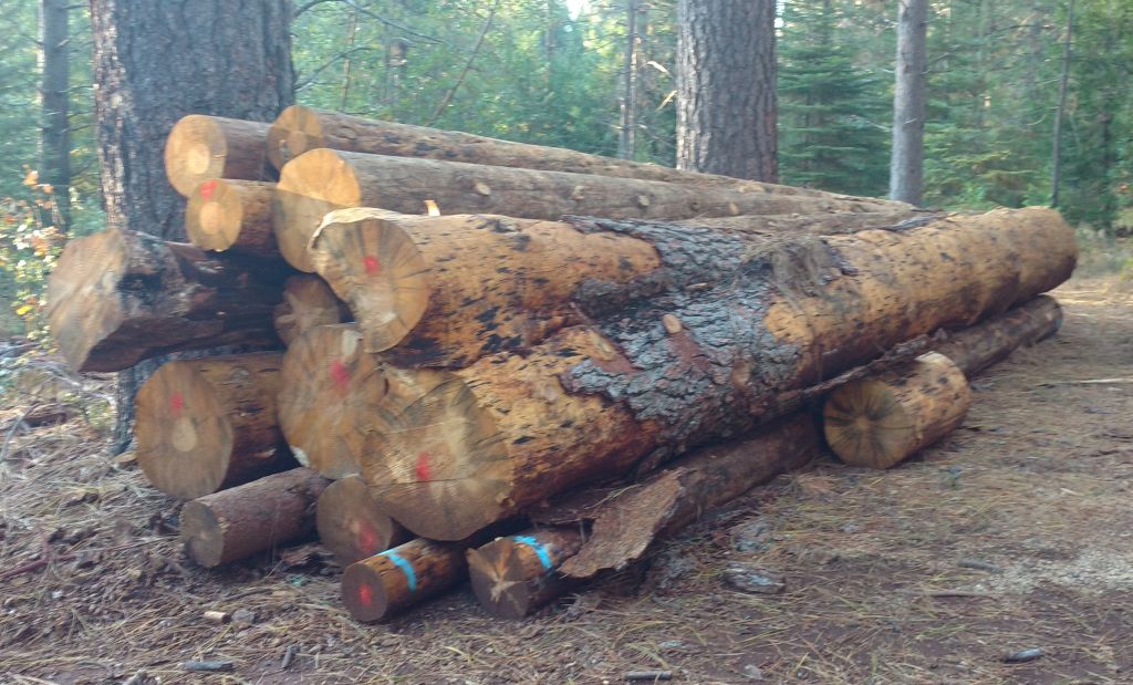

More pix.

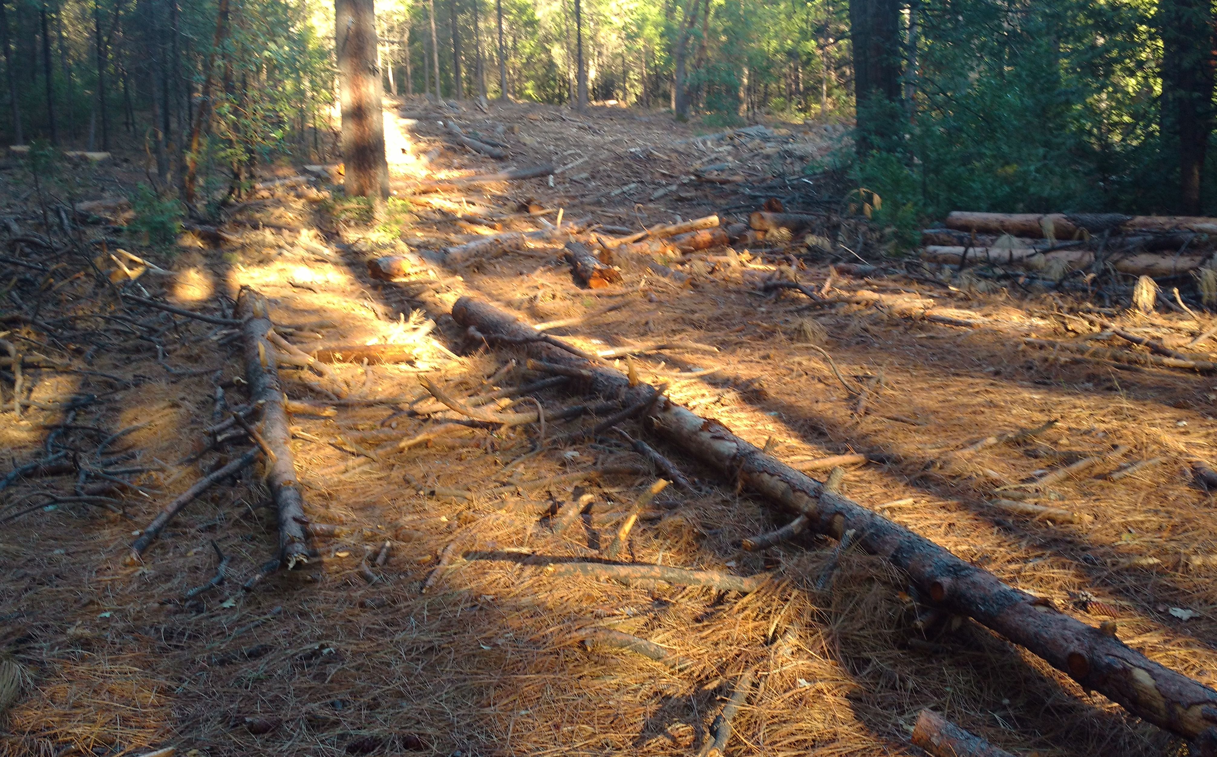

More pix.

LOL. Just as I pictured it.
I'd recommend renting something to clean that up with instead of taking a brand new tractor into that mess. A tracked skid steer with a grapple would do wonders with all the small debris as opposed to tearing up tractor tires. An excavator with a thumb might also be worth considering.

I have a GC1710, same as the OP. I also have a Cat Excavator and i choose the Massey in the woods. I just back up to the mess of logs, chain a log to the backhoe bucket with a clevis on bucket fully extended. I then pull the arm in and the log comes out of the mess of logs. I do this until I can cut the log into manageable lengths with out the mess around me and then pick up the log with the bucket and forks and move it to where I need it.
It can be done and has been done with a tractor.

You seem to have an issue with my suggested method for working on those conditions. I have no idea why my opinion bothers you so much but it shouldn't. If you feel a different approach will work feel free to give it but stop with all the trashing my opinion and derailing the thread with insults. I have no problem with you sharing your opinion. I just see a lot of limbs that are not tire friendly and would suggest something different with track to avoid flats. I have seen many skid steers working in similar conditions and believe it has some advantages in that situation.
