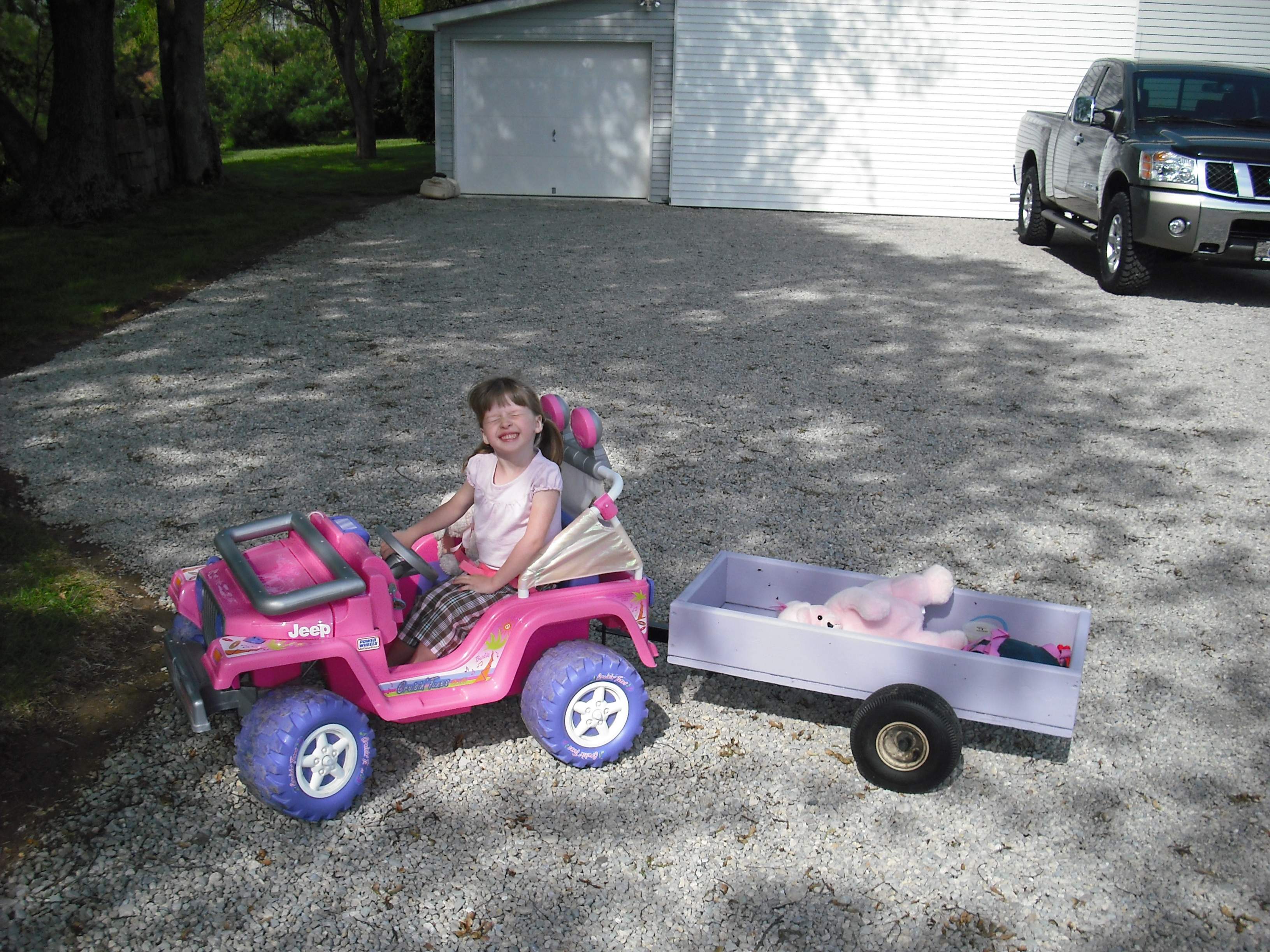

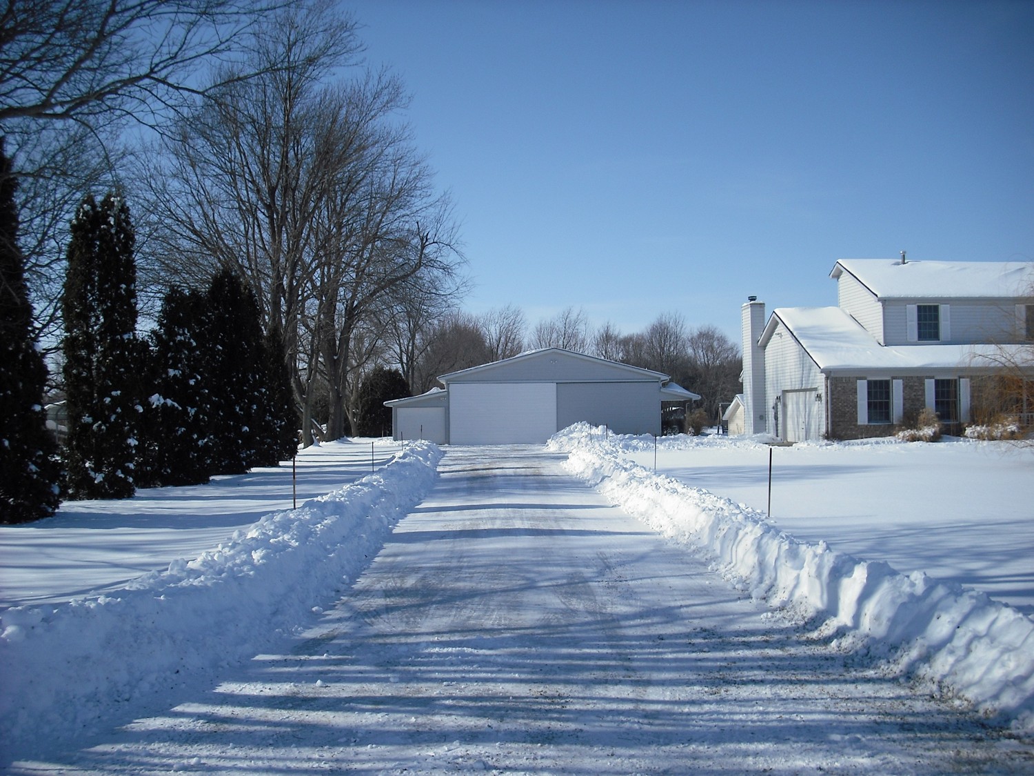

I finally got my 280' long drive in shape last year and now want to pave it. It ranges from 40' wide to 25' wide. I have put well over 150 tons on it in the last 7 years. I guess the birds carry it off. Go figure. I just look back at all the money I have spent on stone and I am 1/2' the way to a $7600 paving job.
These are the best pictures I have of the drive. It really needs 50 tons put on this spring if I do not go for the paving.
Chris

my advice, if I see it right- you seem to have a lower area on the left side in the first pic then the right. I see you don't have a drainage issue, you have a worn out issue.
You need to cut back the branches a foot on each side to allow more sun and air to get to the road. I think you need to scrape the top off- either with a dozer or box blade and scrafiers. Make sure everything is slightly angled higher on the right so the low side is on left. Since everything looks like hard packed dirt, there is no sense of distrubing that layer but just to have a water runoff to the side. Then add some crusher run on top and crown that. Once you do that, the old road base that is so well packed will shed water right, and new layer on top makes it easy for you to maintain for smooooth driving by running the backblade every now and then.
