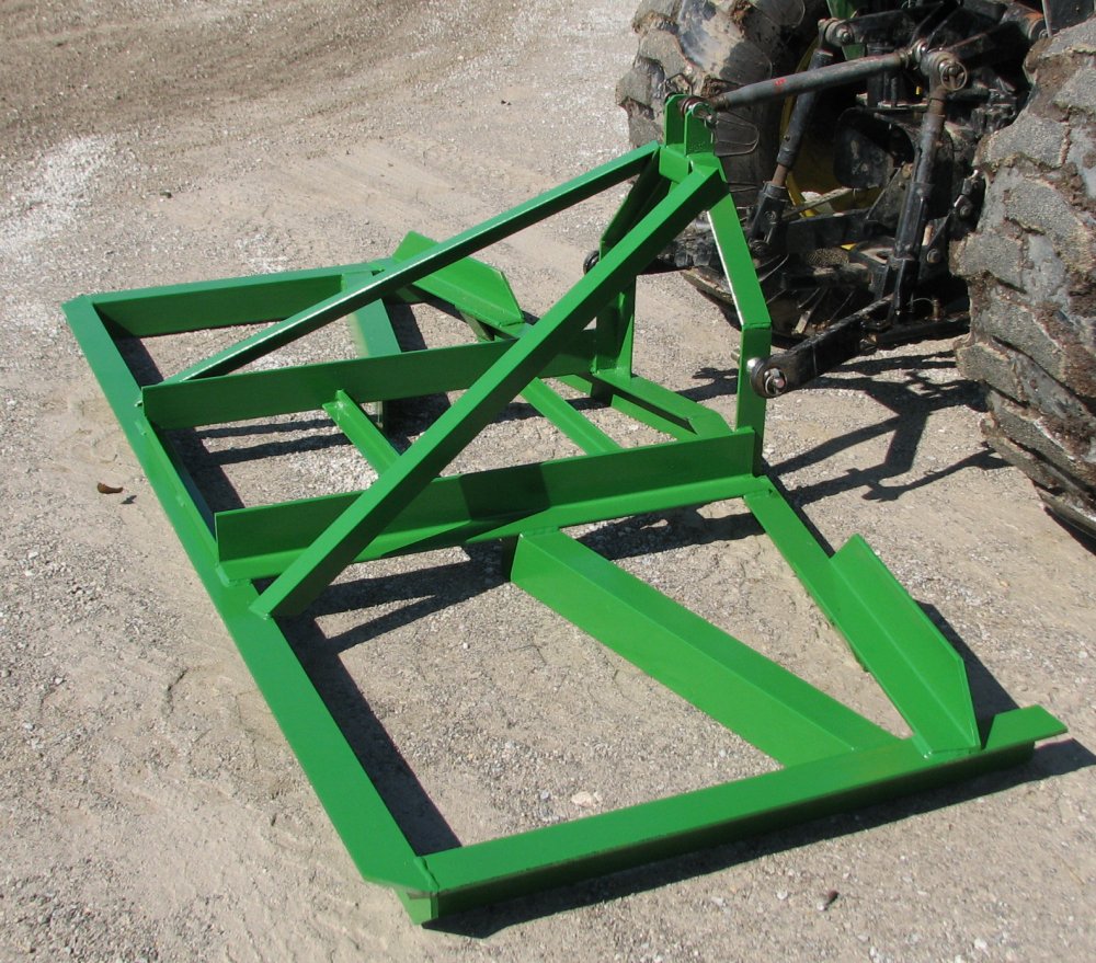

Hello again community. What I want to do is turn 5 acres of land (flat, but previously grape vineyard) into a lawn or yard as it were flat and easier to mow. I just assumed that a 3pt tiller would be the best way to prep it for grass seed but maybe there is a better way. Would disk and harrow and rolling be better. In other words what's the best steps to take to go from pasture to lawn? Thanks in advance

It depends on how bad it is now and if you want to destroy the existing vegetation. And what equipment you have.
Some years back, I had some property with deep ruts in it. I used a box blade and disk to break up the uneven ground and then a landscape rake to smooth it out. Many, many hours....
You can rent Harley rakes, they are good. A big difference between them and a 3pt tiller is that they have the gage wheels to help level everything. A 3pt tiller doesn't really keep things level.
Ultimately, a land plane is good for getting a smooth level. However, if you tilled deeply, the ground may not settle evenly. That's a drawback to tilling.

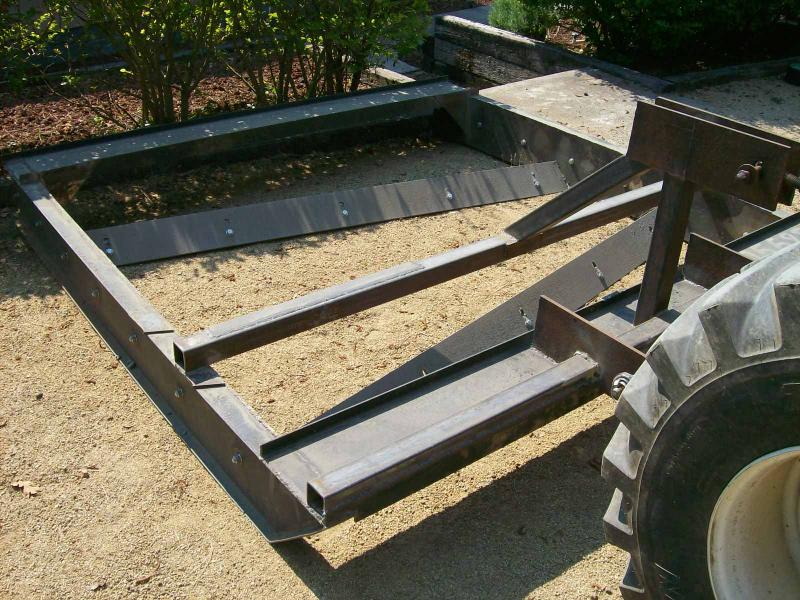

Depending on the current condition, I think I would try a landplane first (or maybe last). They do an excellent job of smoothing ground.
