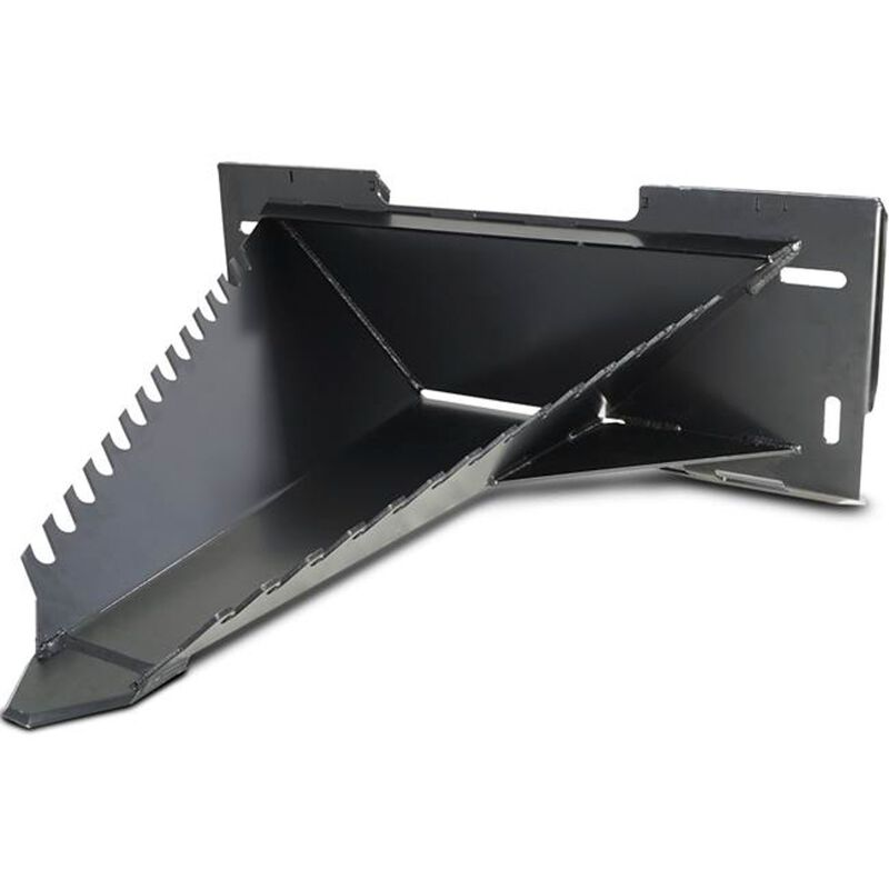

I had the same situation with a neglected pasture about that size (previous owner) and I was new to tractoring. 30 HP Ford 1920 4x4, FEL. Thorny locusts too, not big but too big to bush hog. Wanted to uproot them so they wouldn't re-sprout and to keep from spreading thorns.
Welded up a 3 PH mounted scoop where the scoop component was a 4' long by 12" wide heavy C- channel with its concavity facing up. Sharpened all 3 segments of its end.
Worked OK in reverse simultaneously lifting and pushing. Stubborn ones sometimes raised one side of the tractor which was a little unsettling. Sharpened end severed the tap root and peripheral roots broke off. What didn't come with the root ball lightly re-sprouted but were easily mowed.
Worse was handling them on the ground. Lined them up side by side and pushed them into a pile with the FEL.
These days, I would buy a stump bucket for the FEL instead. What you can't lift out directly you might be able to pry out with downforce. Sell the bucket when you're done.
pro-tip from my dealer: if you have to work in thorny fields, do it when it's dry to keep the tire carcass perched up off the ground.
   / Best way to clear small trees from pasture #20
I bought this stump bucket last year. It's proved to be just the thing for the type of work you describe.
