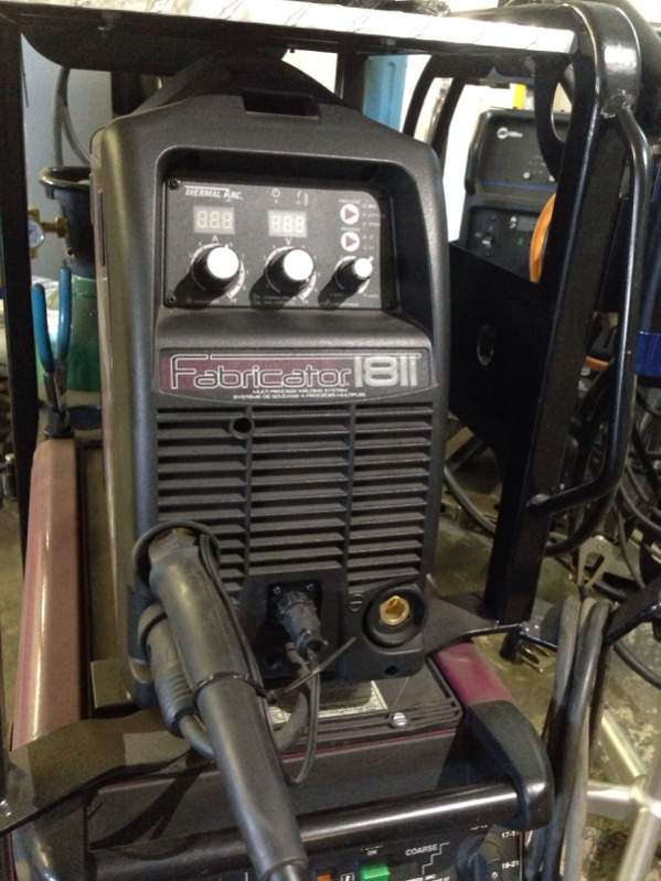

Ive never tried it without a spool gun, but I KNOW I'd like the 'smallness' of the regular mig gun.
Here's a pic of my Tweco 181i 3in1. LWS $950 about a year and a half ago. The spool gun was under $300, fine for single user but would never survive in a shop environment.
