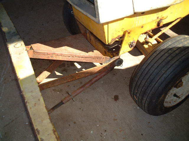

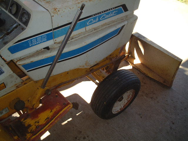

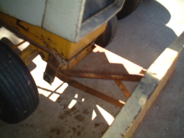

How much fabrication did you have to do to move your dirt blade from your original to your 1250? I'd like to see a picture of what you did.

Rocks moving the blade was a chore but once I knew it wouldn't install like the Original it got easier. Using the Original attachments made it hard but I didn't want to fab from scratch. Might do that later. I still have some fine tuning to do but it is usable. I'll wait for warmer weather to do that. Global warming is kicking butt here in the deep south.
I'll see if I can get some pics today. If I can't get the hang of it on the 1250 I'll move it to the 1200. Same frame so it will be easy.

Here's the pics rocks, I think..Everything is rough. Will make a new lift rod. I just bent the Originals rod to fit.

I had no idea that the blade from an Original would fit that close on the wide frame series. Thanks.

Rocks the brackets that the blade mounts to on the Original jut out. Also I did have to bend out the two top attach points to fit the wide frame mule drive. I have to rework the 1200 carb and then I will move the blade to it. The hydro is too hard to manage with both controls on the same side.
