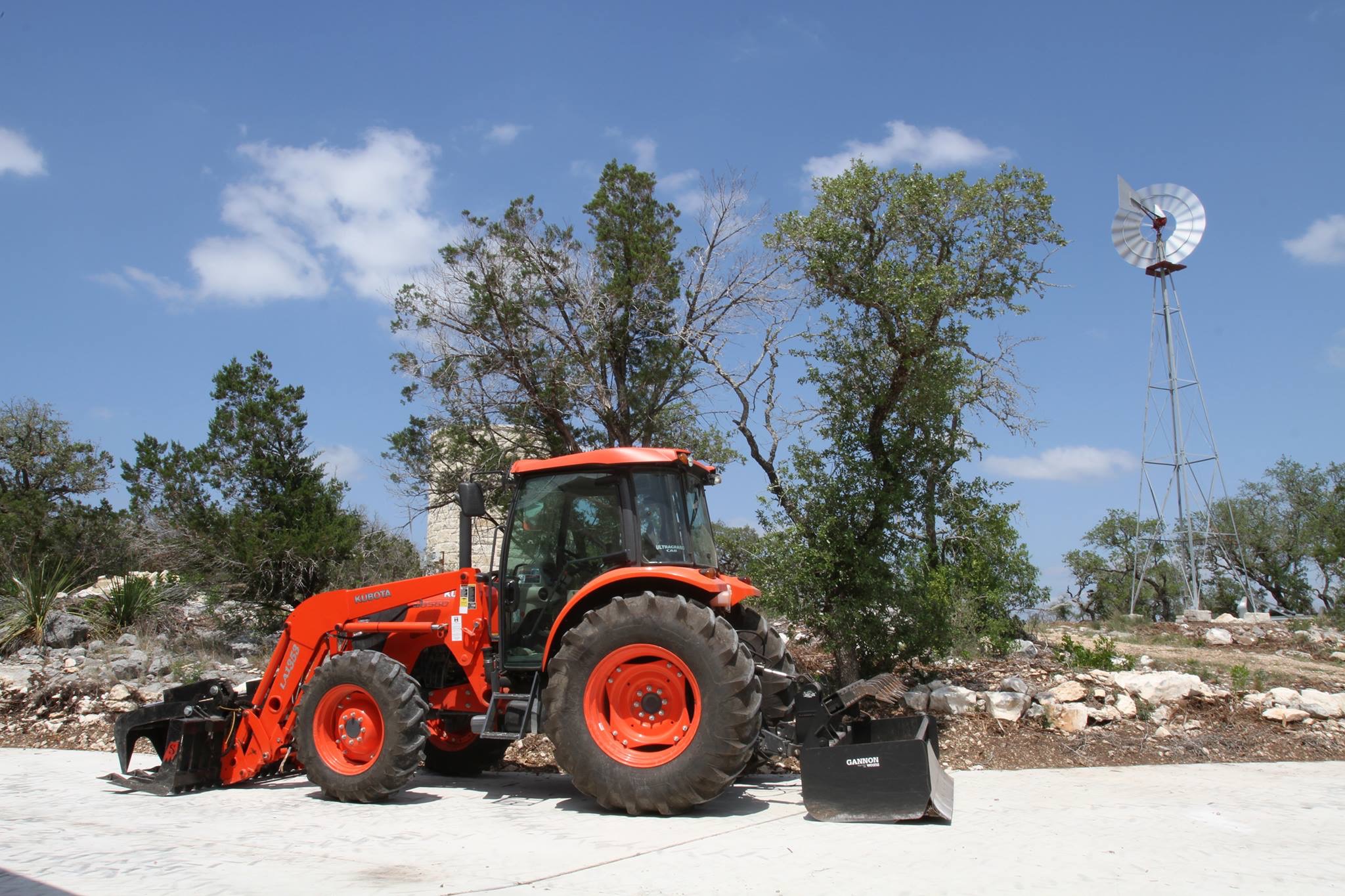

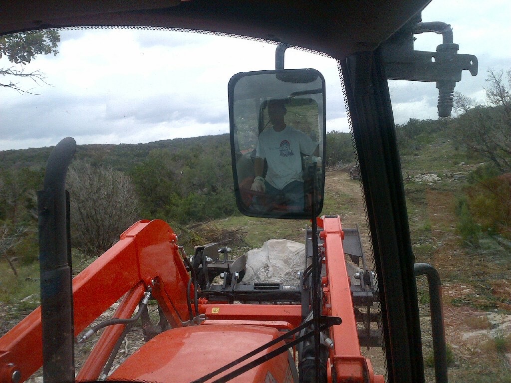

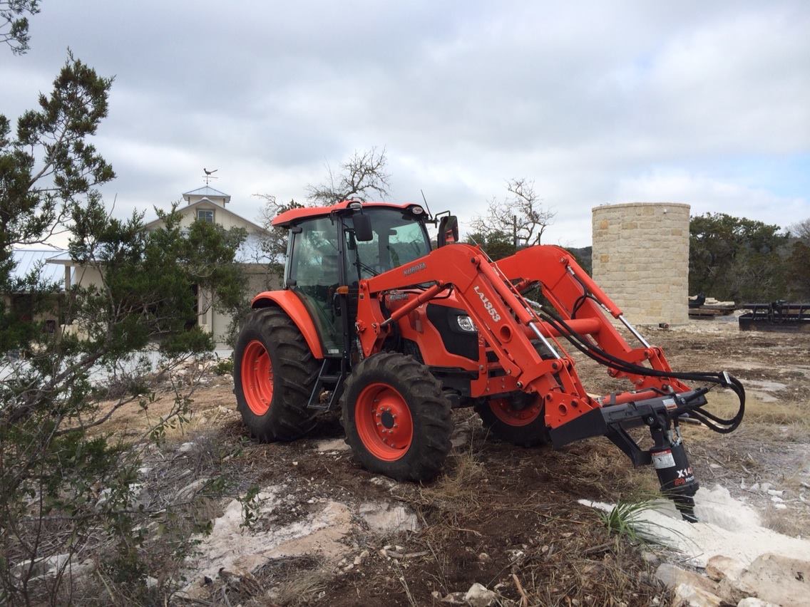

I've been using a WR Long electric over hydraulic for several years on my Kubota M8560 for my grapple and auger. Works great.

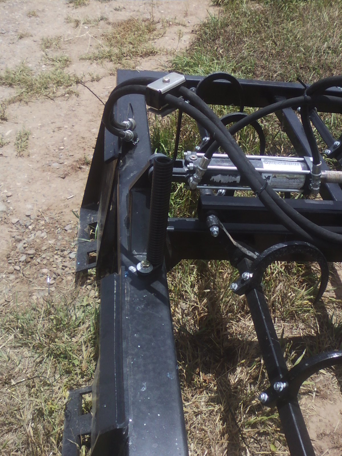

Does anyone here use the spring protector kit they have? I would like the quick connects hard mounted to the loader arm, figure they could be tucked out of the way better and less likely to snag when using something besides the grapple.
/ Best option for the 3rd function #11
I use the quick connect bracket with no problem. I would not want to be trying to pull quick connects off or putting them on with a mount the moves. I have a spring mount for hoses on the auger (see earlier pic). With the grapple the hoses hang behind the grapple - right where I want them. When I'm not using these connections the bracket is well out of harms way.
/ Best option for the 3rd function #12
Are you referring to this? Tractor hose reroute kit
If so I have one on my hay grapple and it is great. Keeps the needed slack out of harms way when operating my hay grapple.

Look into getting the mounting bracket that attaches to the loader arm. If you go with a spring mount on the grapple just keep in mind that with the grapple you're likely to have stuff over the top from time to time. Best to keep the lines behind it.
