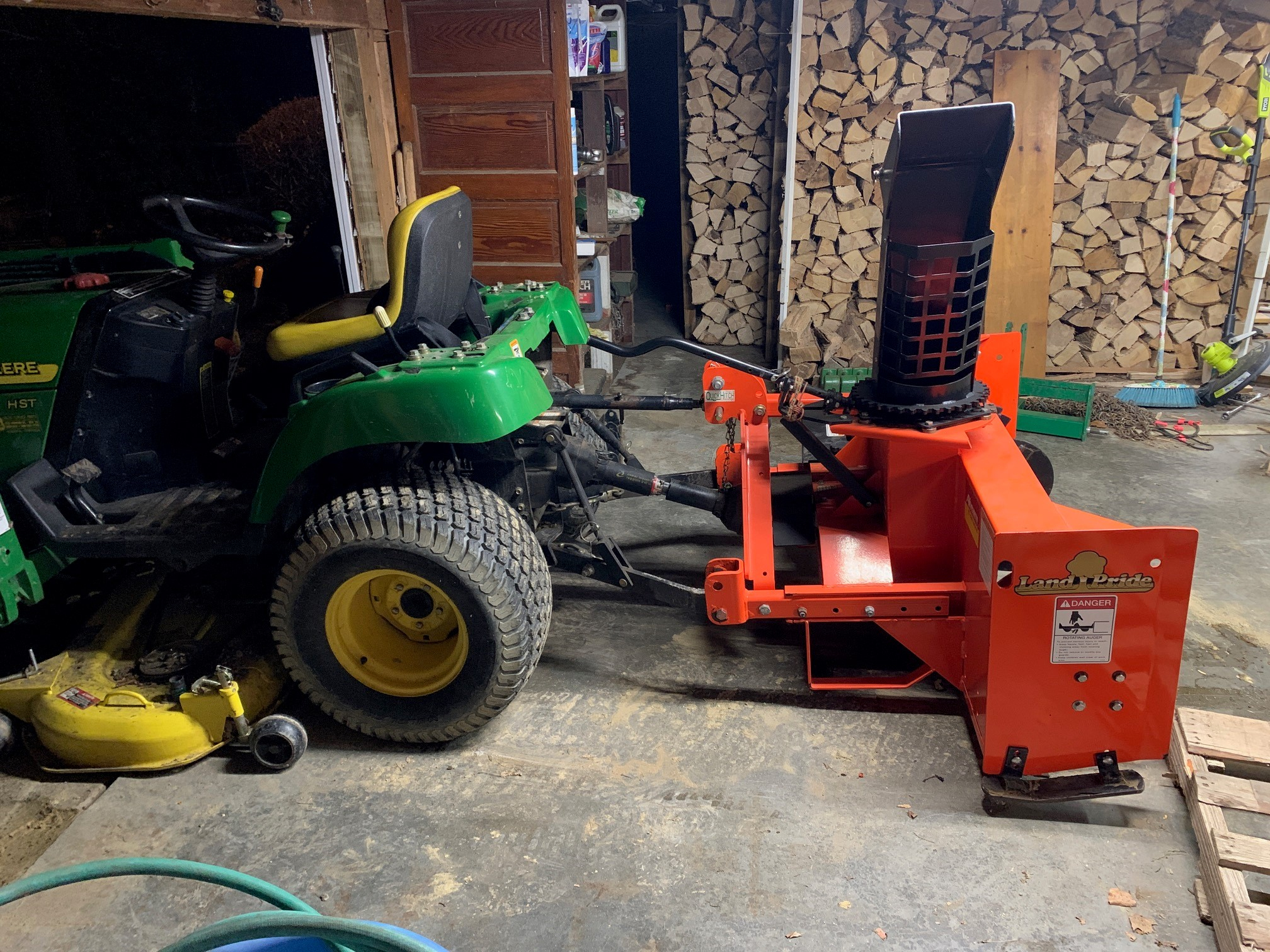

Just acquired a like-new LandPride SB1051 3 point rear snowblower. The PTO shaft that came with it is too short. Where is the best place to get a cost-effective replacement shaft??
It must have a shear pin or slip clutch since this is going on my 2210. I'm measuring 26" between the end of the two splined shafts.

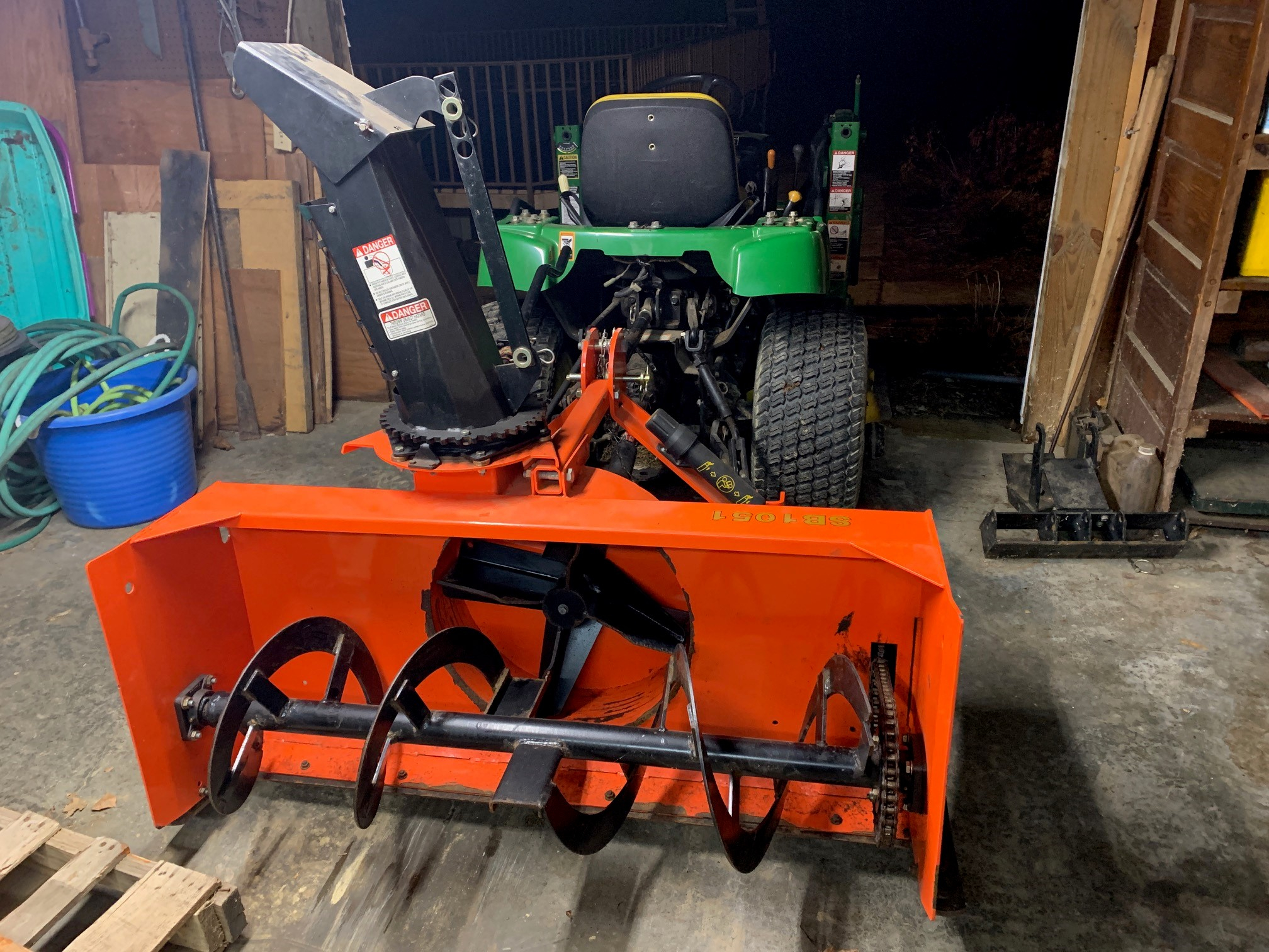

Here's the prize. I'm loving the way this thing is built. I considered shortening the 3 PT mount, but chose against modifying it.
The PTO shaft is indeed dangerously short!
