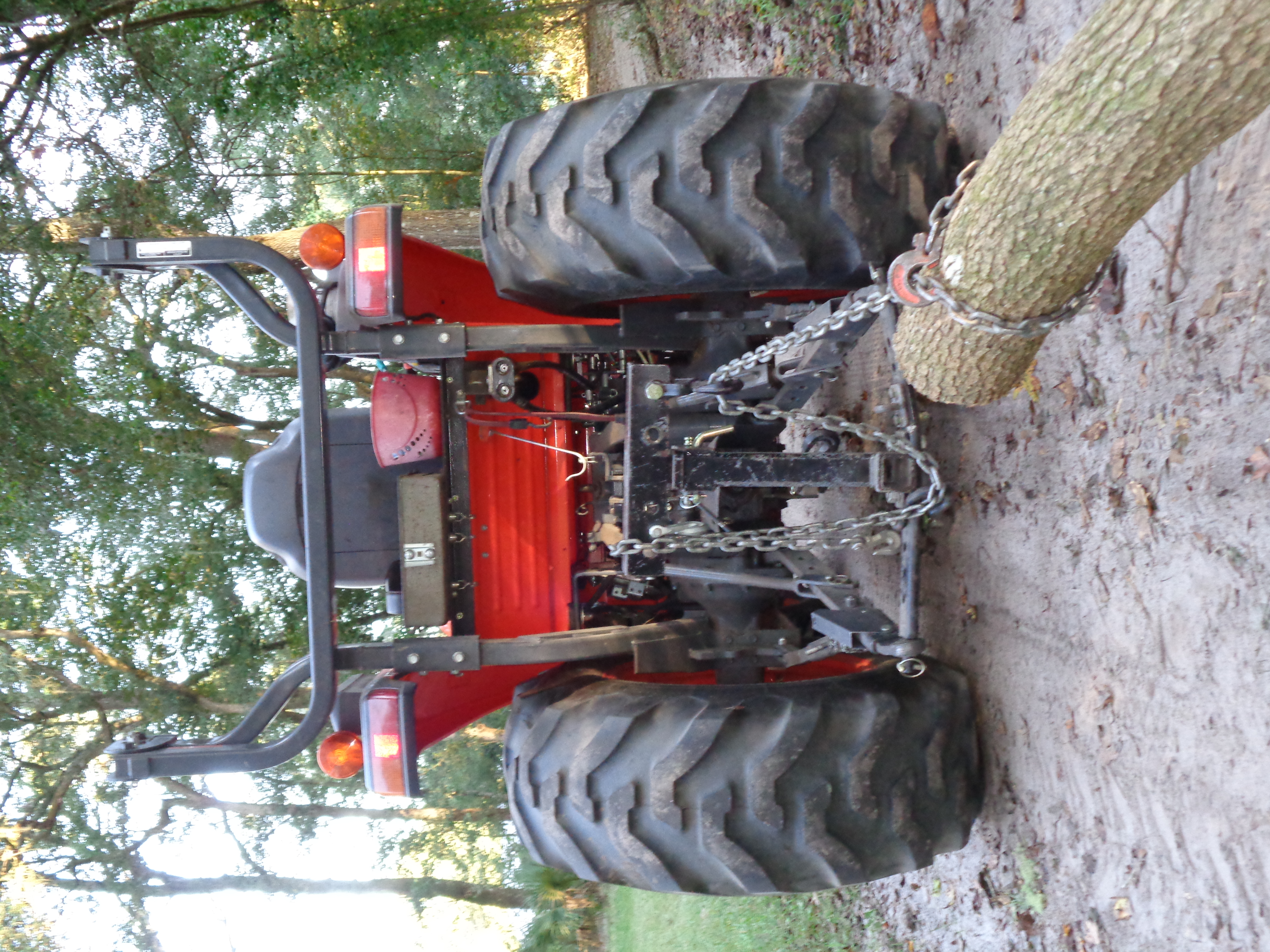

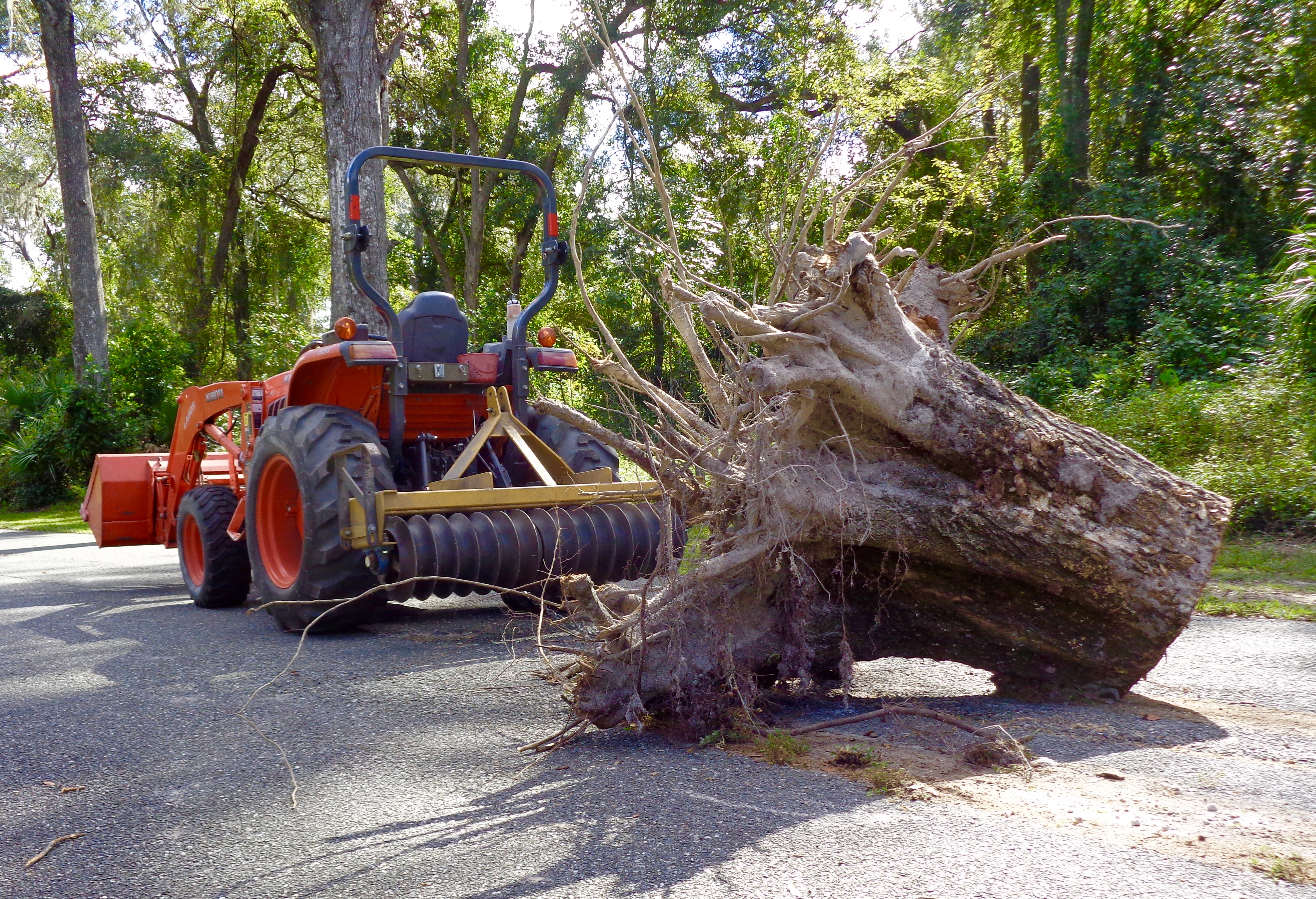

Usually reasonable size boulders, up to 1,000 pounds, are loosened with FEL bucket, then towed from the rear center drawbar with chains or nylon straps. Lifting heavy loads with the FEL, then moving the laden tractor is when most tractor rollovers occur. Rocks can slide in the bucket, upsetting tractor balance.. That is why 1,000+ pound boulders are usually towed behind the tractor.

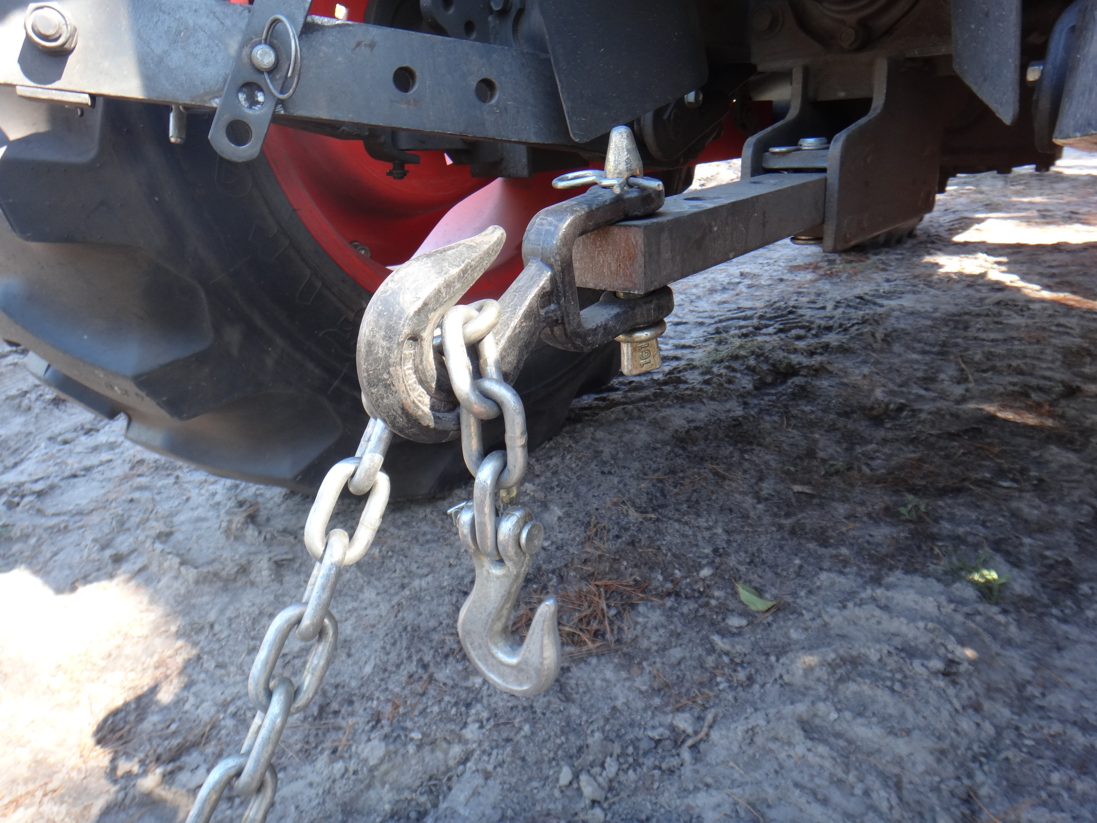

Photo #1: Slightly elevated log being pulled from Cross-Drawbar with optional "hanging tree".
Photoe #2, #3: Rear/center Drawbar. Large stump being pulled with chain attached to rear/center Drawbar on tractor.
VIDEO: So you want to TRADE UP for a new Tractor? - TMT - YouTube
DRAWBARS: https://www.tractorbynet.com/forums...rs-cross-drawbars-illuminated.html?highlight=
