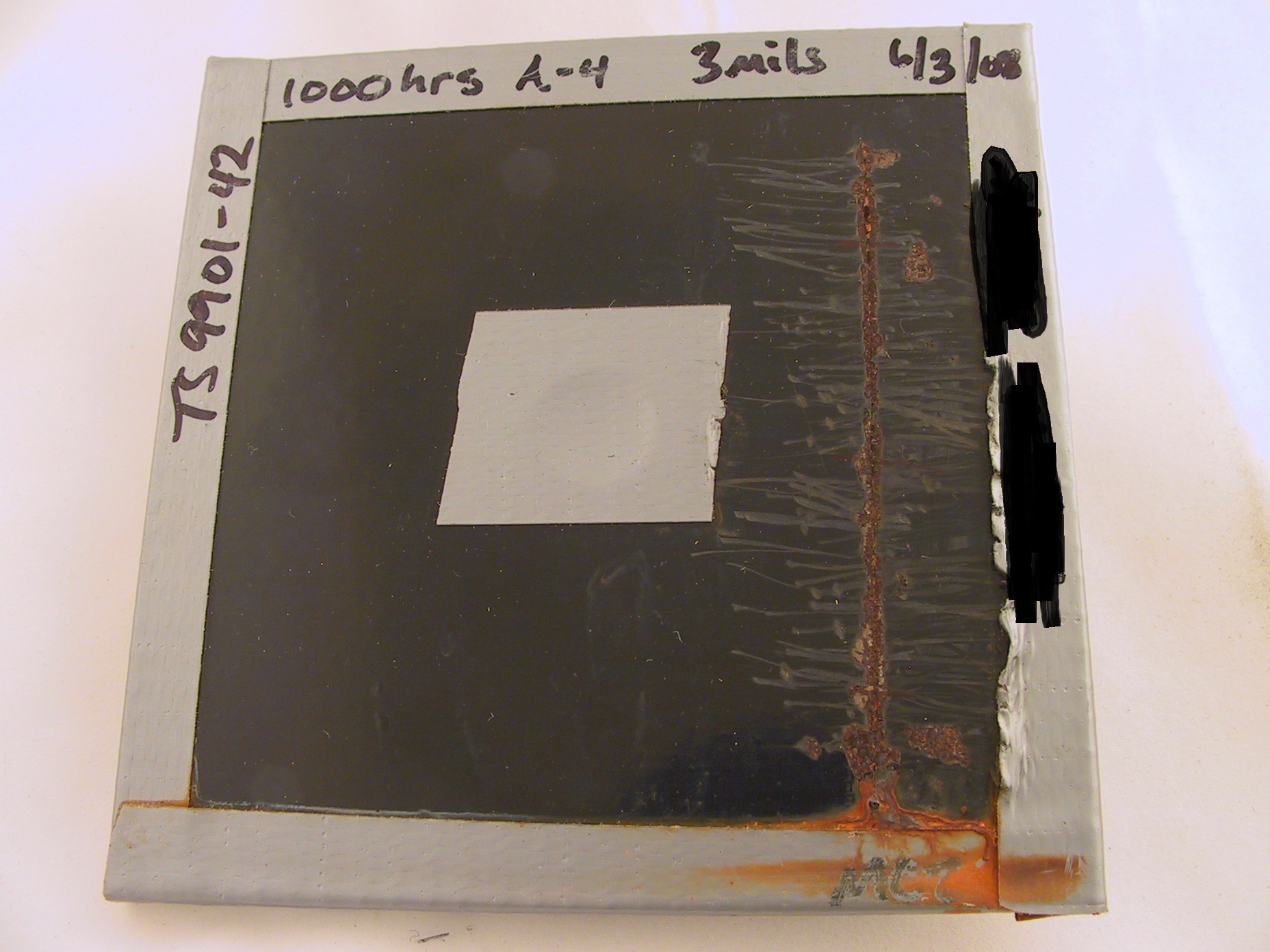

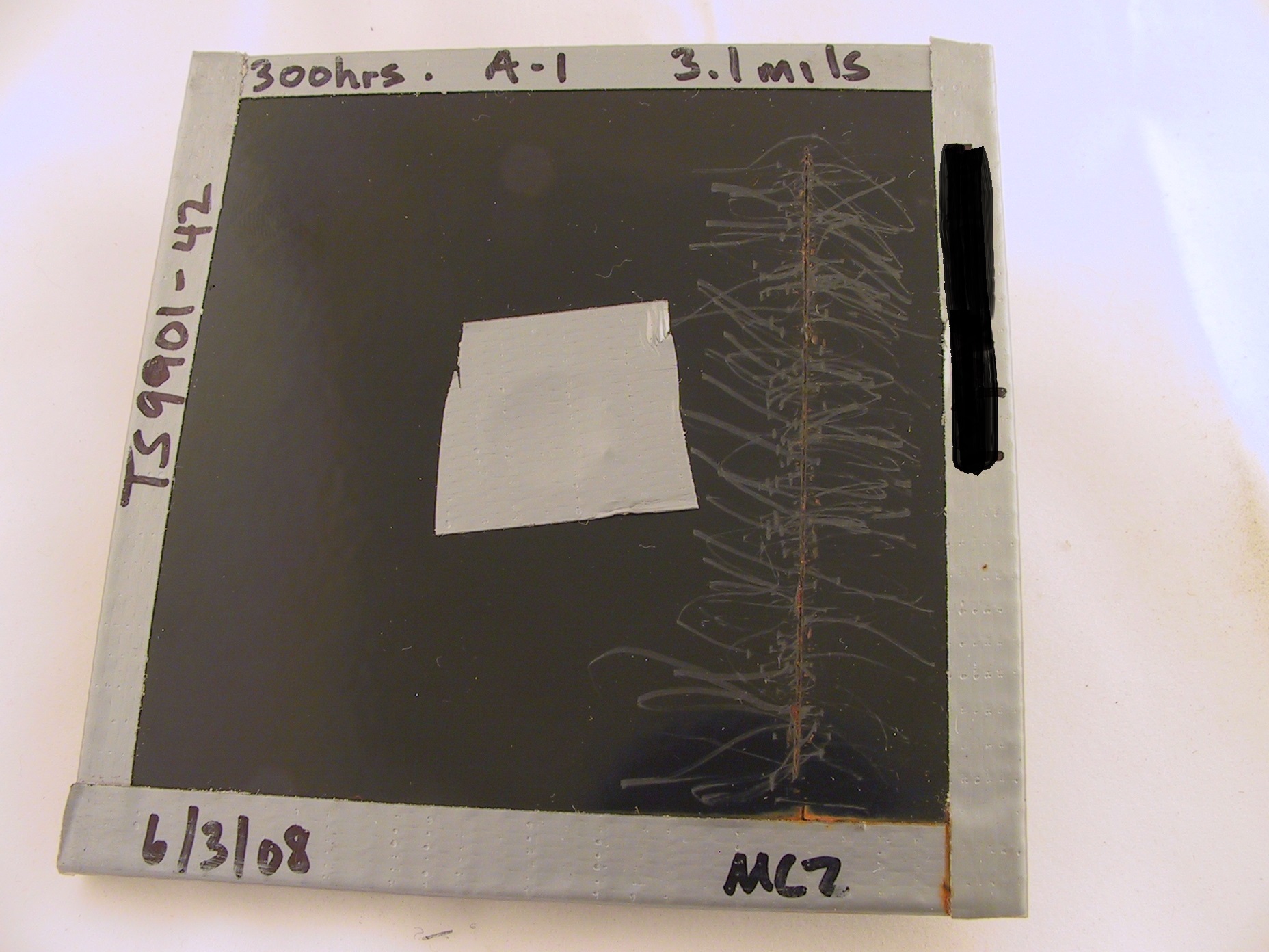

The steel will rust at the scratch...nothing can help that...but the water will not get under the coating. As the part continues to rust the metal will scratch will continue to widen but you should not see powder failure until several hundred hours of constant exposure
Here are some steel parts that we tested. You can see how long they were in the salt spray chamber at the top left. Automotive standards are typically 300 hours of exposure. The company we did these for has a 500 hour standard but we ran them until the powder failed. We test aluminum up to 5000 hours

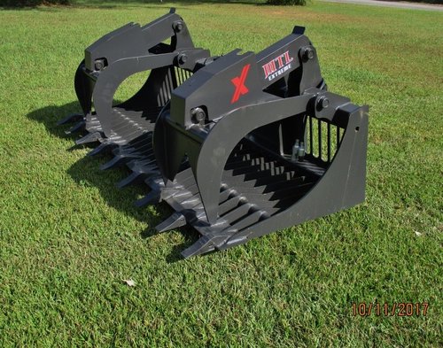

Bought a 66" Rock Grapple from MTL Attachments. I Should be able to pick it up on Saturday in Buffalo. Will be anxious to hook it up. It will be the first use of my 3rd function controls. 1[2].jpg

I have a 60" MTL RK5 rock/root grapple. It's not the X series but looks like it would hold up under a 60 hp tractor. It's a little on the heavy side for my 30 hp tractor.
They advertise it as powder coated but the finish wears off readily when used in the dirt. (You know, the stuff you find roots in)
Hate to hijack a thread but if they really do powder coat what are the issues with mig welding?
I have considered buying their 50 single lid unit and welding expanded metal in the spaces to retain small roots and sift dirt.
   / Best Sized Grapple?
#29
Hey JD855guy, how have you found the quality of the build? Has it been a good tool for you?
   / Best Sized Grapple? #30
I haven't used it long. Build seems sturdy but the finish comes off easily. No grease fittings on the cylinder pivots. Some gaps and slop on the JD quick connect. I don't like that the tine points don't extend out to the bottom points when closed. Should work great for logs and brush but small stuff falls out. I imagine that would be worse with the wider version unless they made the clamps wider.
