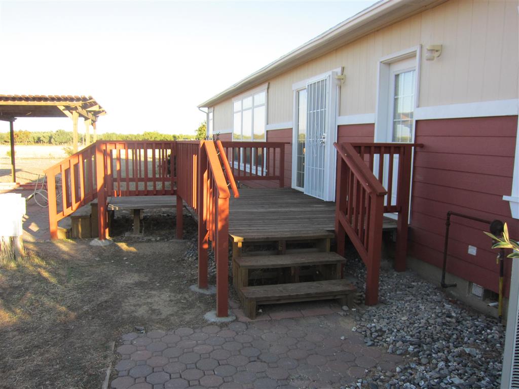

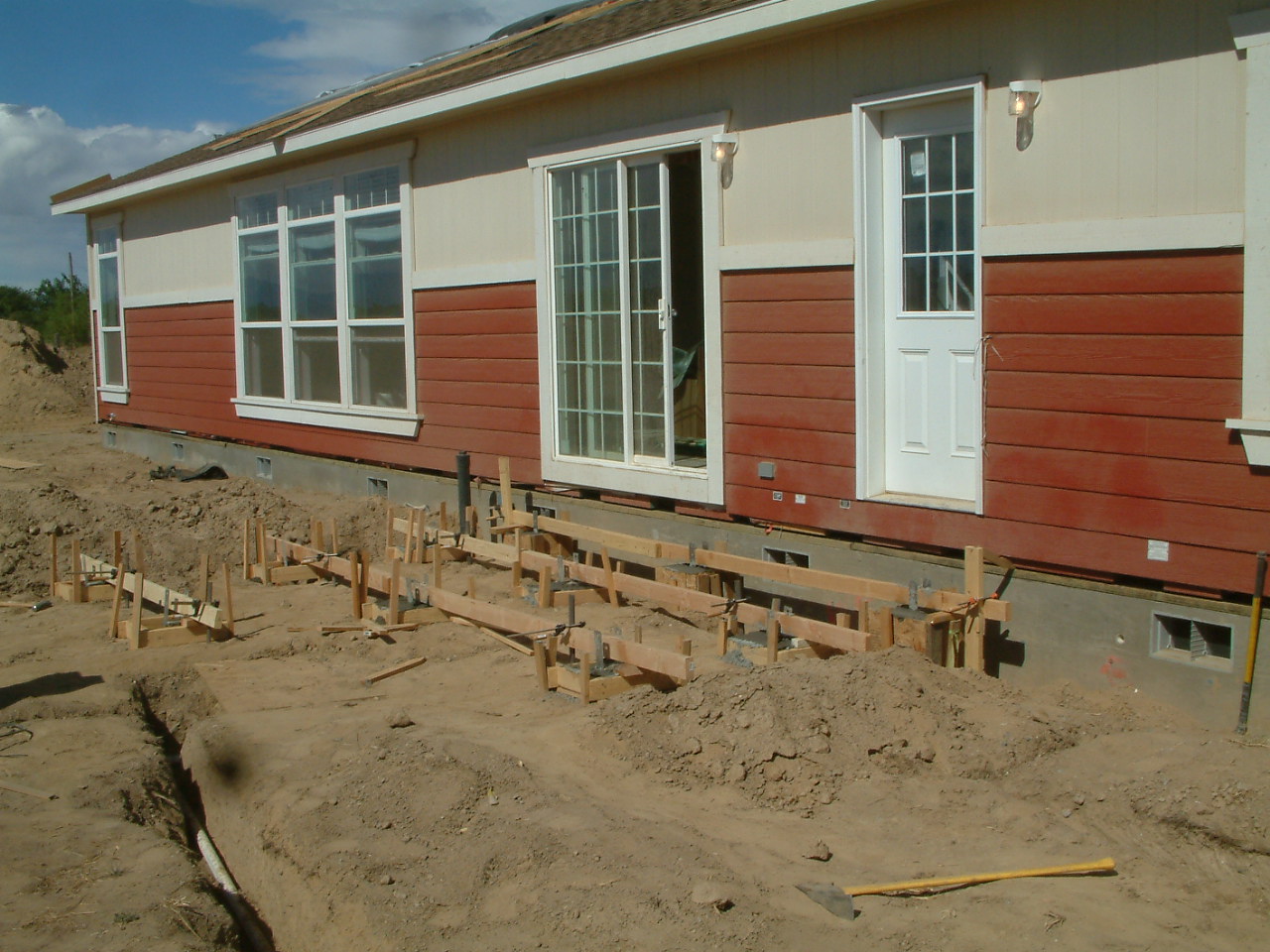

I used Sherwin Williams barn red (or brick red) exterior paint on my house in 2005. It's the pretty good stuff ($55/gal IIRC)
Here's what it looked like in Oct 2005 when the house was being installed.
Here's the same in Oct 2013.
This side of the house faces South and gets the intense sunlight.
That red color has held up pretty good going on 10 years. Which is impressive since reds are notorious for fading. Example: the hood of my Mahindra 5525 is pretty faded after about 7 years and I keep it under the carport most of the time.
BTW: I used that Behr one-coat deck paint on the railings in the second photo (Oct 2013). Posts and the horizontals are pressure treated lumber. The ballisters are Douglas fir.
Good luck.
   / Best Stain for "Barn Red" color and long lasting protection #12
BTW: that Sherwin Williams red is applied to Hardiplank.
