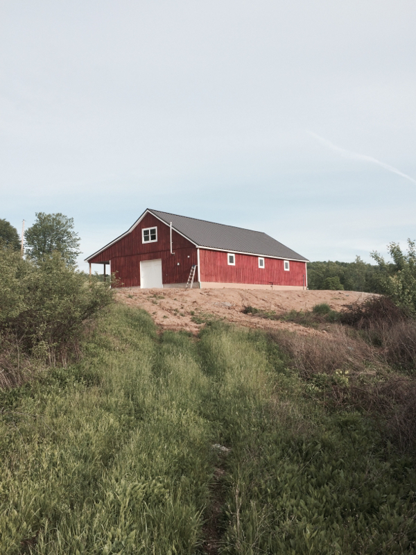

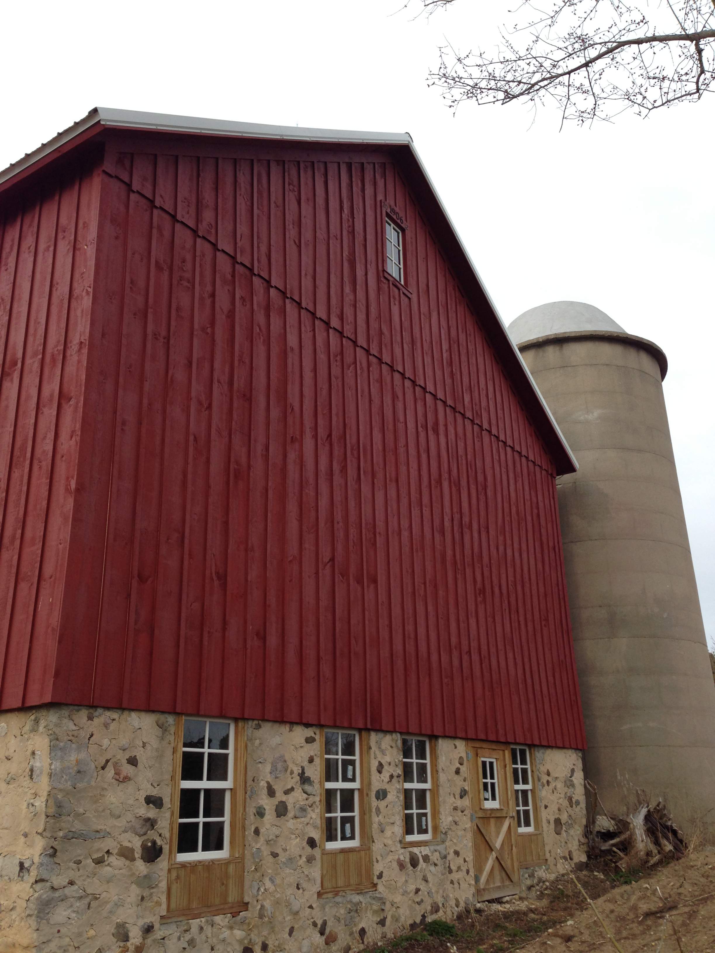

Just as the title says. I liked the color of the Benjamin Moore "barn red" stain but just realized its only a stain and offers no weather protection. The Behr stain plus weather protection would be great but their red colors are limited. This is going on a 50x70 barn with new rough cut popular siding. Any one have some recommendations please?
Thank you,
This is two coats of Behr "Barn Red" "weather proofing" 25 year warranty solid stain.
As you shift from a transparent product to a stain with more solids the durability of the finish goes up. So does the cost! I believe we were buying 5 gallon buckets for $175 and we used 6 or 7 of them. Personally my preference is for a stain because it's able to penetrate the wood so it can't peel.

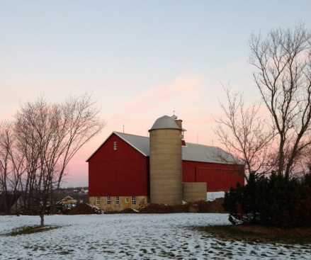

image-4006068309.jpg This is with Cabots semi transparent stain. Rear side of barn. I'm very happy with it so far. Color is barn red.
